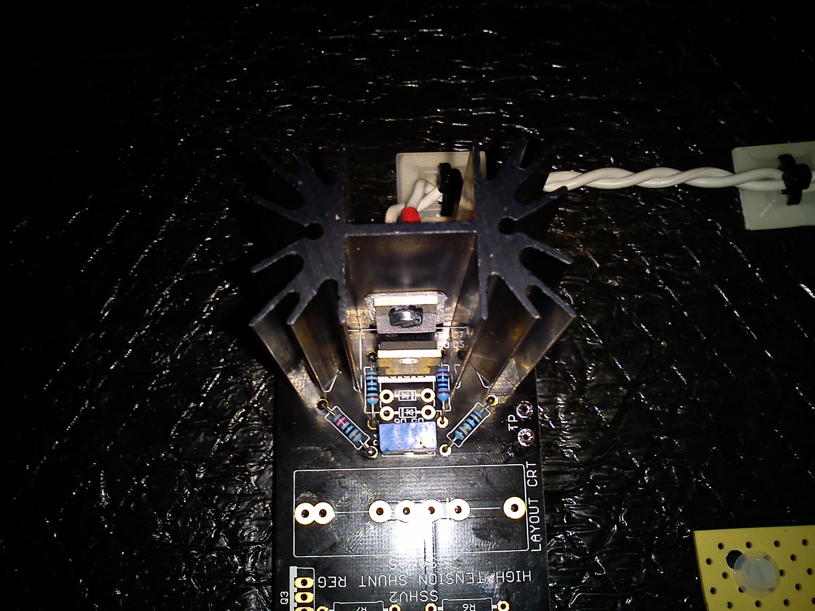

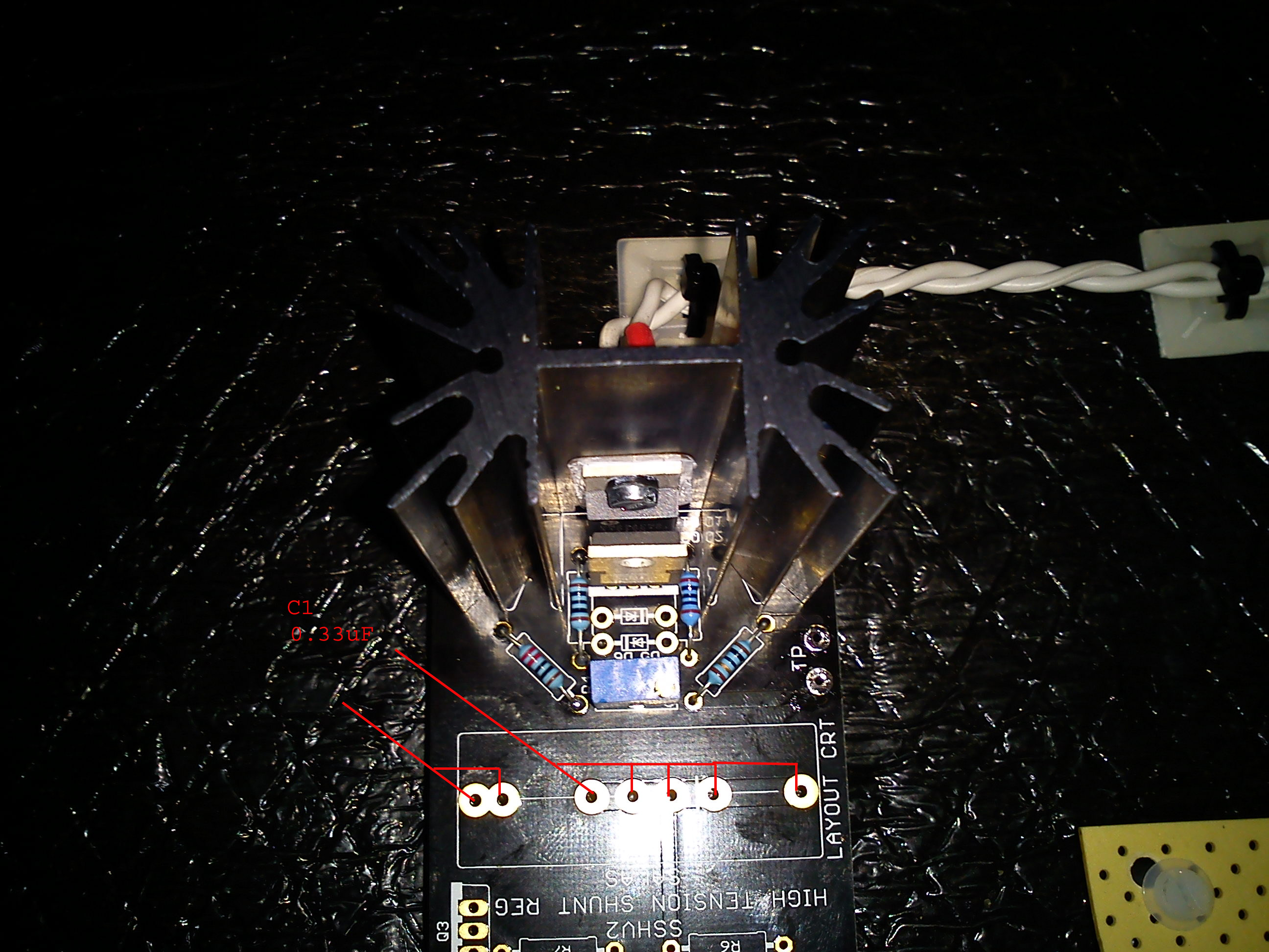

Merlin's photo where the still unpopulated C1 pads can be clearly seen is an opportunity to remind something for when constructing. Only the two left hand pads are to accept C1's one leg, all the others to the right are to accept its other leg. They are staggered for various standard pitch capacitors that you may find. Watch the legs to always span the left black gap in the picture in other words, and keep the cap just a wee bit proud off board for its underside not to touch any free pads, its important.

That ain't any new SSHV2, its just Merlin's yet another SSHV2 build.
