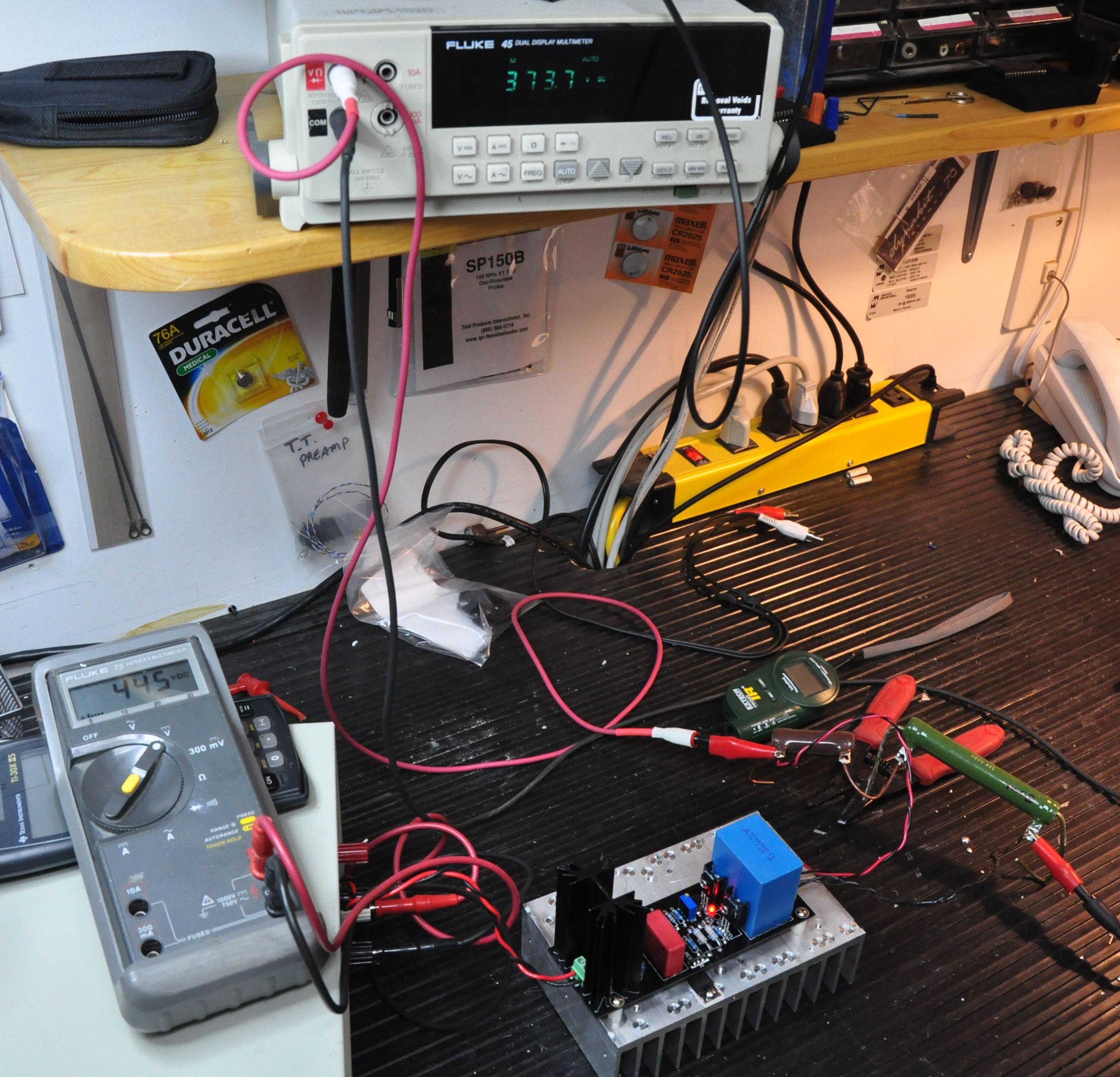

Is your Q1 sink at safe thermal level after running long with 450-375 or 435-375 difference times 50mA? If that aspect is OK too you are done.
Q1 heatsink is at 39C after 3 hours of 445V input and 375V output. Total current through Q1 is 50mA, with 30mA to 12.4K load.
I have cycled it numerous times on-off and it seems to be ok with that. The Q1 FET is rated for 60W (800ma). It's also 4.5 ohms Rds so that helps a bit too.
I'm using 2 of these in my Class A amplifier. This one will supply the driver, long-tail pair and differential CCS. The other will be for the screen supply, where I'll be at 350V out but total current at 75mA. For that regulator, I will probably heatsink Q1 as I've done with Q3 (see picture) as it will have more differential and current.

Looks like running great then. Congrats. Will need that silver sink, at 375V 20mA spare is 7.5W constant. You may try a bit more if the thermals will allow, if it can give you some more sonic. You will judge after you get familiar and the build is a bit run in.
373.7 on the FLUKE 45 is the drift from 375 after 3 hours? 445 on the FLUKE 75 is from a bench PSU? Is it tube or SS?
I think that sink is only 2C/W heat rise, pretty minimal. However, I have a plan that will set both regulators on to the same aluminum heatsink, with both Q1 and Q3 tabbed directly to the sink below, as the photo shows with Q3. I agree with you, the better the thermals, allows for better sound when it comes to regulators, and as a bonus, they last longer.
Yes - after 3 hours. It was set to exactly 374, so it's out by 300mV. Salas should be happy with that. 😀
The beige box is a bench supply I built with a spare Hammond transformer. Added the 193N choke after to get noise right down, but no room inside. It also has a 3A, 6.3 (linear) filament supply. The filament supply is floating at 1/4 B+ for circuits that might need this.

That's impressive drift indeed for that scale of voltage in a hot reg when coming from an innocent for noise and complexity JFET and resistor non feedback Ref. What is it 0.08%? And we can trust the FLUKE 45 stability I guess.

If you're happy...I'm there too.

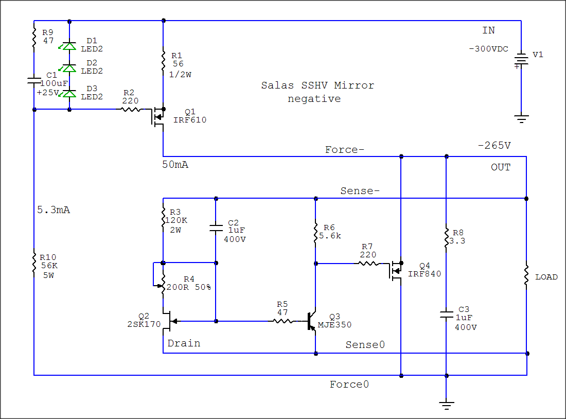

Hi Salas,
A general question (to all).
When there is a separate power transformer winding for negative supply (either low or high voltage), is there any possible drawback in using a positive regulator for that negative supply?
To the contrary, using two positives with two bridges arrangement, gives you two identical same genre semiconductor circuits and ground loop safety.
