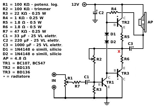

Simplest Transistor amp possible
In the old days (early 70's) this amp topology was reasonably popular.
It worked reasonably well and used absolutely minimum components, yet producing acceptable quality and powered many home Hi Fi amps and receivers.
Here it was known as the "Texas 35W amp"
I printed a few spare boards and now and then build one to turn my junkbox parts, including EBay fakes, suspectb cannibalized transistors, etc. , into something usable.
Typically coupled to junkbox quality recovered speakers inside improvised chipboard boxes to make powered cabinets great to boost PCs, TVs, game consoles, smartphones, etc. to room filling levels.
All of my friends have one or two by now, cheap and appreciated gifts. 😉
In the old days (early 70's) this amp topology was quite popular.
Forgot to attach the schematic 😱
Here it is:
I redrew the bare minimum parts one, commercial ones split R1 into a 47k or 68k resistor plus a 50k trimmer to fine tune output rail voltage for symmetry and used a 200 ohm trimmer instead of R7 to fine adjust bias but as-is it´s quite usable as the "junk box transistor eater".
Think of it as of the "early 70´s LM3886 replacement" and you won´t be far from the truth.

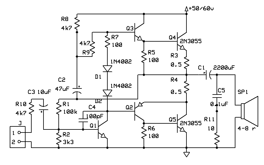

Well, now that we are flying real low, I am encouraged to upload this ... amplifier.
CONVIRTIENDO VIEJA FUENTE DE PC A AMPLIFICADOR CAR AUDIO - YouTube
"Converted from a PC SMPS" made me think it might be some kind of Class D amp, so I clicked.
Weeeelllll, it definitely does use MJ13007 high voltage switching transistors, that´s something.
After the initial awe inspiring sound sample, turn volume way down, explanation is in Spanish anyway.
> flying real low
Same thing, tripled-up, and resistor-bias instead of microphone bias.
I have no idea what the coil is for.

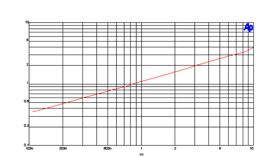

The one transistor amplifier mentioned in post #9, is described in a technical paper which also includes curves of measured THD. Here is one of them; THD in percent [vertical axis] versus power output (watts into 8R) [horizontal axis]
_
Which is definitely not bad for just one active element, even if that means running 2.2 A from a 100V= supply through a somewhat exotic depletion mode MOSFET, so inefficiency is reaching new heights here. Among the ~110 W of MOSFET power dissipation, >500 VA transformer and two 25000 µF / 100 V caps, it wouldn't be a super cheap project either.
Definitely a good illustration of efficiency - complexity - performance tradeoffs in any case.
