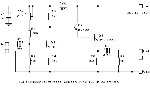

PMA said:This one will be workable and will give reasonable output o several watts....
You should put input output at about 60-65% of V+
in this type of circuits.
For better Effiency.
Negative swing can NOT be more than 15/2= 7.5 volt
Positive swing will need to be 7.5 volt,
Leaves 7.5 volt over Transistor.
If we set output at 60%= 18 volt
gives 9 volt negative swing (8 ohm resistor & 8 ohm load in series)
Leaves 3 volt over transistor
at +-9 Volt output.
All these calculations based on 30V DC supply.
30v/1.875A - In this case 7.5Vp= 3.51 Wrms/56.25= 6.24% eff
30v/2.250A - In this case 9.0Vp= 5.06 Wrms/67.50= 7.50% effiency

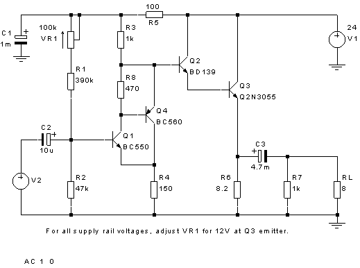

additional schematics
In order to make this sample of circuits complete, here two extra circuits. They were designed/suggested to me by Geoff Moss in a discussion on these circuits (starting with the AR-3 headphone amplifier but built for normal speakers).
I have actually built these circuits and compared them with the original, but modified for 8 Ohms, AR3. These two circuits gave around 2 Watts RMS into 8 Ohms (the AR3 around 0,5 W under the same circumstances).
Strange enough, both these circuits did not fullfill my expectations on grounds of sound quality alone. I built all circuits using the same components (brands, types etc). They were good, but in the same league as the John Linsley Hood or Hiraga (and then I would suggest to build one of these). The AR3 however improves upon all of them (of course, subjective, but alas).
(pictures do not show in preview of supply!)

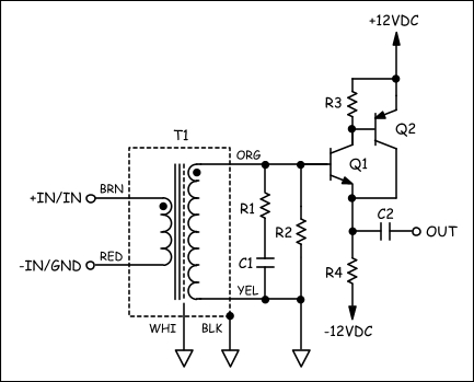

I think the 8 Ohms resistor in each of these designs is a really stupid pitfall. It's a waste of power, and will really giuve you no good-effects, unless you want to replace it with 12V Automobile bulbs, to make the whole amp look like a simulated tube amplifier.
How about taking one transistor out of the small signal chain (as you don't really need it), and make a push-pull output or at least a current mirror i n the output instaed......
Circlotron ... You contribution is the most innovative in my opinion 😉 so far ......
transformer input
Can you give some specifications and component indications for this design (where does it come from)?
The input-criteria (impedance and sensivity) come from the desire to be able to drive the amp straight from a cd-player and/or a highish output impedance tube pre-amplifier (that can not deliver any amount of current into low impedances: that's way the Zen amps can not be driven by simple tube-amps).
You have introduced a new element into this thread: the use of a transformer. I have nothing against it per se but these things are hard to find or very expensive or not sounding right..
Re: transformer input
I haven't given the all-BJT version a full workout (I've since abandoned it and opted for a JFET for Q1) so I presented it more as a conceptual circuit. But if you want to experiment, the component values are as follows (actually you can leave R3 out, I forgot to remove it from the schematic):
R1: 9.76k
R2: 39.2k
R4: 8 ohm, 50W
C1: 220pf
C2: 2,000-4,000uF 35V, non-polar
Q1: 2SC4793
Q2: 2SA1302
T1: Jensen JT-13K7-A
Ok. Kind of figured tubes were behind it somewhere. 🙂
Though even your garden variety NE5532 opamp can drive loads as low as 600 ohms so the 1.5k ohm input impedance of this circuit wouldn't be a problem for most any solid state source.
Well, "inexpensive" wasn't included in your design criteria so... 🙂
se
rmgvs said:Can you give some specifications and component indications for this design (where does it come from)?
R1: 9.76k
R2: 39.2k
R4: 8 ohm, 50W
C1: 220pf
Q1: 2SC4793
Q2: 2SA1302
se
