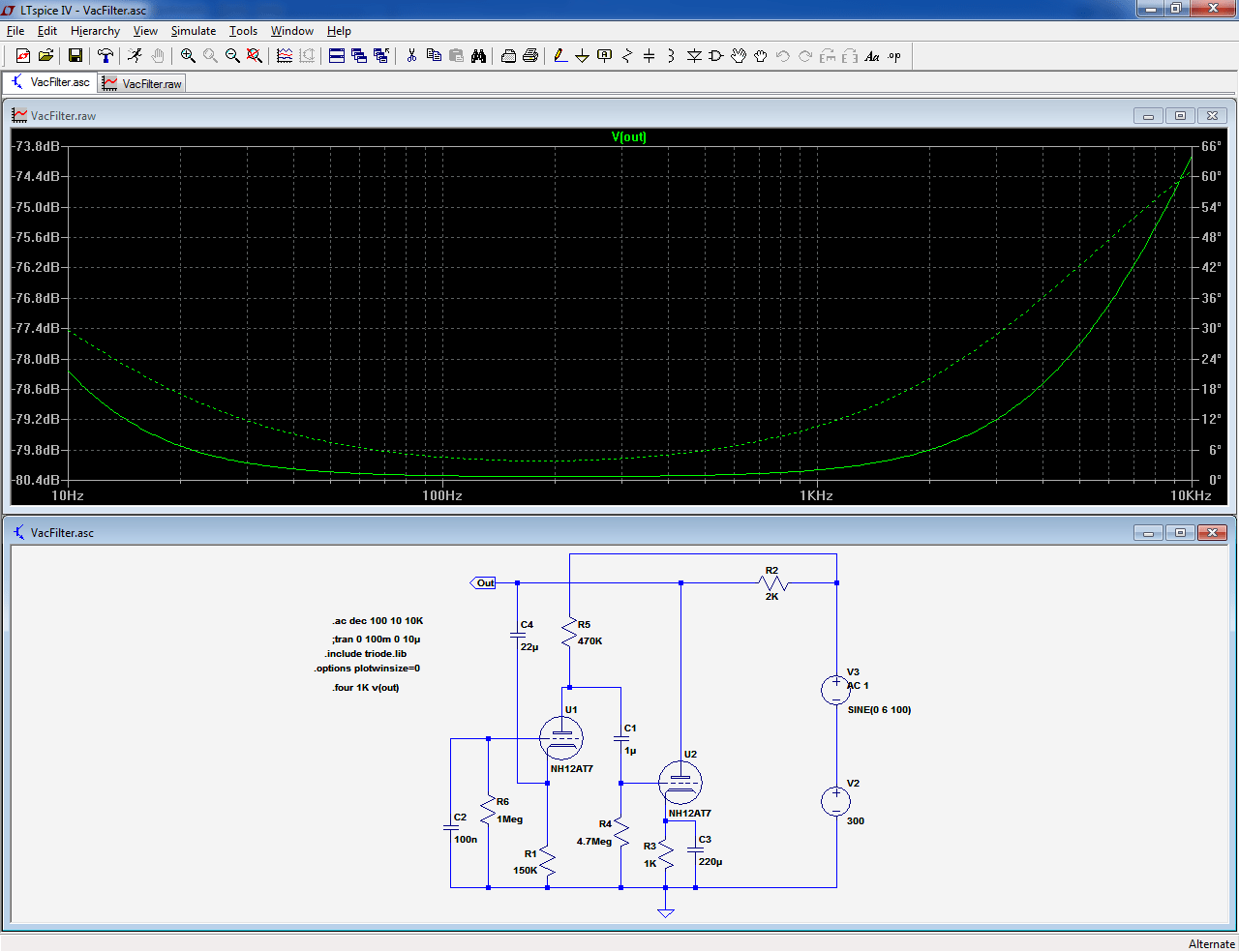

There's a world of difference between the circuit in post #1 and the 1937 article in post #10. For one, there's an order of magnitude difference in the size of the anode-grid capacitor. In the original, and strangely uncredited (have I missed it?) 1937 article, the intention was clearly to make a capacitance multiplier, which would have been worthwhile before the war, when capacitors were difficult and expensive. The article was poorly framed and misleading, but the modern "interpretation" of it is just wrong with no redeeming features.

The ripple killers I saw before have the adjustable resistor in the connection between the 0.1 uF (or an other value) capacitor and the plate connection.
The schematic on page 27 also shows the adjustable resistor at that position: Electronics June 1937
Thanks this is a nice article, 1937 Akido mojo! But the max plate voltage of 6A6 is 300V, this is across 400V? Just getting started learning spice, this is a good practice thing to model to answer my own question!
https://frank.pocnet.net/sheets/127/6/6A6.pdf

Schade worked for RCA. As a major mucky-muck researcher. And television development was important. (Had to beat-back the Farnsworth patents.) "300V" 6A6 will stand 400V for quite a while. If not forever, long enough to not drain RCA's resources.But the max plate voltage of 6A6 is 300V, this is across 400V?
Using a dual tube (and a not too simple circuit), it is possible to achieve performance levels comparable to semiconductor circuits:
For higher voltages, the components need to be adapted obviously
Thanks! A newby learning a lot here, I was starting to model this (newby spice) starting back at the power supply. But I see one can just superimpose whatever kind of noise you need onto the DC then see how well the circuit cancels it, very cool.
