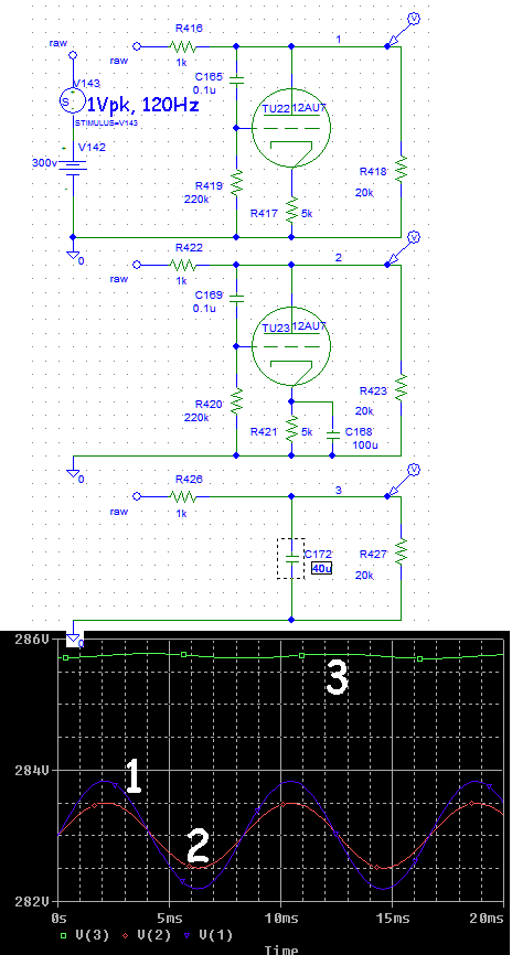

Using a dual tube (and a not too simple circuit), it is possible to achieve performance levels comparable to semiconductor circuits:
For higher voltages, the components need to be adapted obviously

Thanks! A newby learning a lot here, I was starting to model this (newby spice) starting back at the power supply. But I see one can just superimpose whatever kind of noise you need onto the DC then see how well the circuit cancels it, very cool.
