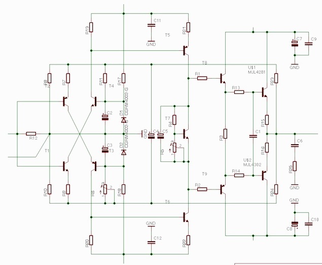

I've started the process of drawing a schematic into Eagle, the general concept is attached. The pcb will be around 75mm x 75mm for each channel. Ignore parts choices, those are just convenient to get the right physical package shape and size - it's the toplogy I need to get right at first.
Output stage is 'standard' AKSA / TGM1 / double EF. Any reason to use something different (all BJT) ?
What am I missing ? do I need to make provision for compensation caps ?

I really like Andrej's complementary approach here, it sims extremely well with almost an evenly descending train of artefacts. My only concern is that you invariably need to set up tight balance between upper and lower halves with consequences for offset control, but aside from that, his approach to avoid AC coupling is inspired and innovative.
Hugh
DC offset is not even an issue in SSA amp, it is in range of +/-10mV no matter what, of course if the input pair is matched and thermally coupled. 😉

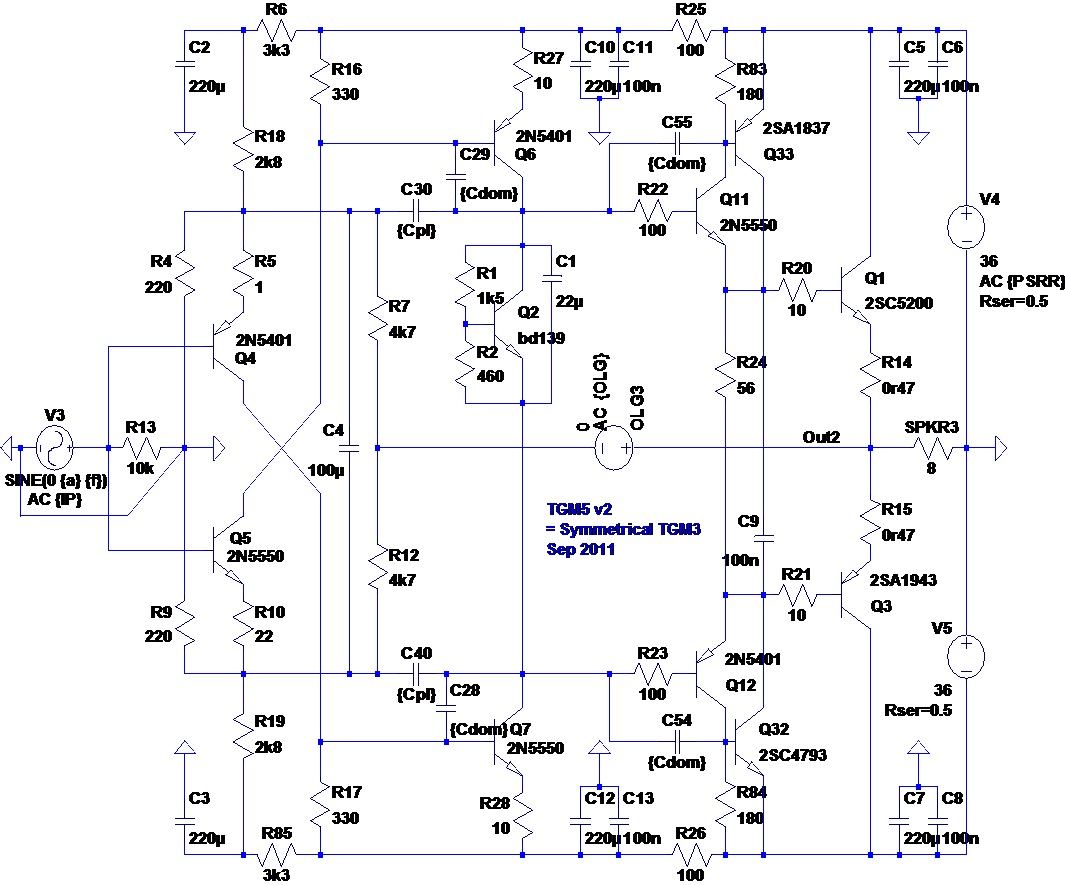

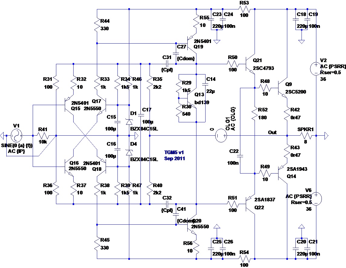

I've explored a couple of options in the simulator.
Attached first/left is the same version I posted above for an all-BJT version. [Note that my amplifiers are named TGM1, TGM2 etc. and as this is my 5th amp I'm labelling it TGM5]. It's a simple double EF output with the LazyCat SSA input. Works like a charm in the sims. No turn on bumps either. I take my hat of LC for this simple solution for symmetrical CFB.
Attached second/right is amodified version, I've taken the cascode devices and flipped them to the output stage. The result is a CFP driver. This design is now effectively a simple symmetric version of my TGM3 amplifier. The high current zener bias stage disappears and instead the feedback node is biassed from the rails (suitably decoupled). Is this still the SSA anymore if I do that so the question is - just because I can, does it mean I should ?
The CFP driver reduces distortion for both versions of the front end.
My simulations show the need for compensation - at the least it requires miller compensation on the VAS. It doesn't need much and the OLG retains an extended region of low phase shift - this thing really is a vhf amp.
Lastly, I noted in my sims that H3 is slightly higher than H2 - contrary to what has been reported for the LatFet output version. I expected a symmetric amp to have more H3. I can only assume, still, that higher H2 comes from device mismatch.
Now, if you look carefully at the 2nd attachment you will see asymmetric emitter degeneration of the input pair. In simulations this provides a nice touch of H2 without any other detrimental impacts.
Both versions are fine, also simulator confirms that too. Omiting cascodes in second version will certainly impact the sound signature because the input pair dissipate more power also Cbc will influence the freq transition greater than in the first cascoded version. I would also add zeners parallel to C2, C3 in second version. This one has an output buffer with a scale greater current gain than normal so you can expect really nice measuring results too. 😉
