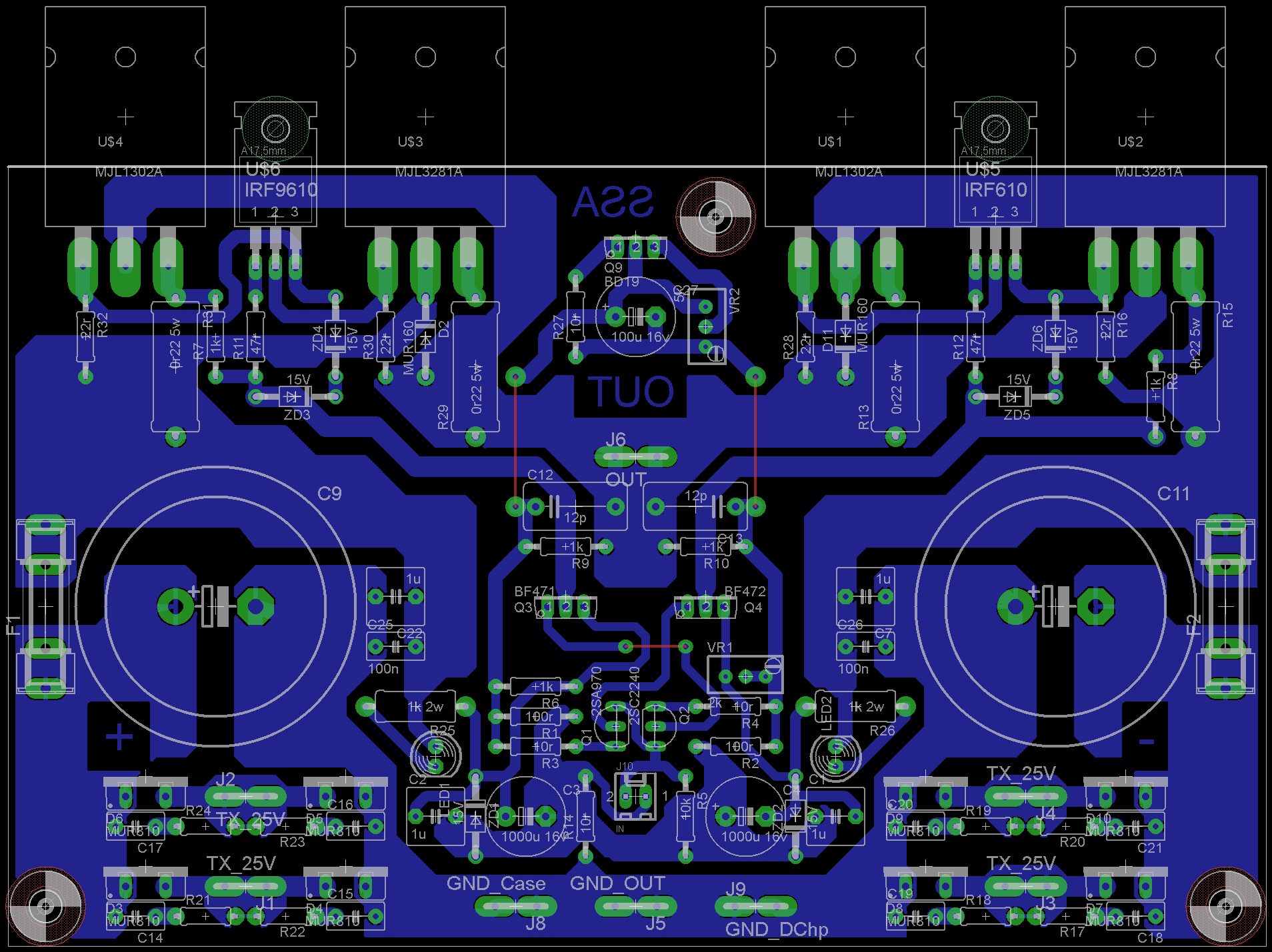

Lasy Cat i modify the pcb based on your advice.
Marc
OK Marc, fine but to mine opinion you could left fuses on previous PCB positions, it looked nicer before, just to perform a little copper connections adaptation. To have PCB in max symmetrical look you could also move single wire jumper to the middle position, otherwise very neat to the eye. 😉
Fuses are normally used to prevent fires, through prolonged fault conditions. In that case placing the fuse in the AC path as LC recommends is valid. This means the fuse will blow in the event of devices going faulty and the board/wiring starts to burn. A fuse should always be used when changing from a large wire dimension to a smaller wire dimension.
Fusing of the incoming mains to the transformer is normally sufficient and if it blows you do not have a possibility that a faulty component swings the output to one rail and remains there.
Hello Nico, nice to see you again. I always like to see way of clarifying things of oldschools.
By the way, it bothers me a bit to see fuse holders on those pcbs. As I mentioned before, pcbs should be without power unit on board in my opinion. This is a very early stage of an implementation and people may use just one PS unit for each pcb/circuit experimentation.
Cheers.
By the way, it bothers me to see fuse holders on that pcbs everytime. As I mentioned before, pcbs should be without power unit on board. Because this is very early stage of an implementation and people may use just one PS unit for each pcb/circuit experimentation.
Cheers.

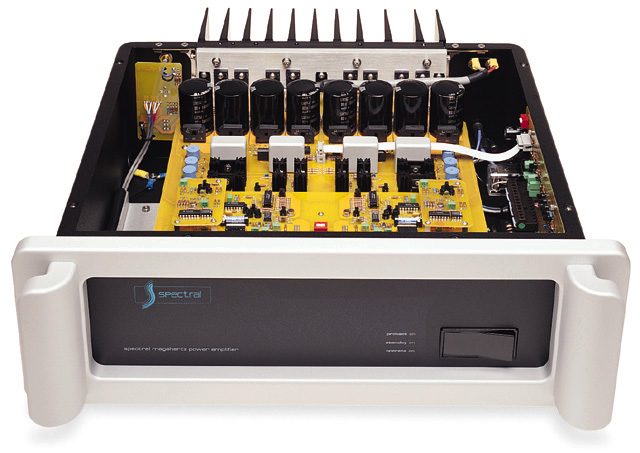

People who design PCB's on their own usually make them functional to their exact needs-wishes, I don't see any reason why not. To have PSU on PCB also means less wires (spaghetti) present in an amp's case. In according to high speed design like SSA is, where all AC paths are concluded in a very short loop, it makes a lot of sense too. Please look how high speed amps like Spectral are built (PCB, heatsink, etc.). 😎
