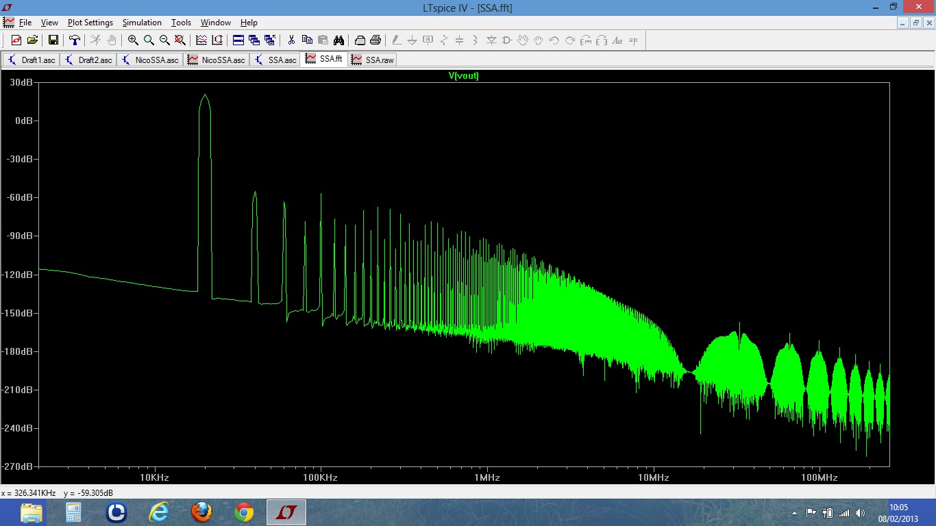

Hi shaan,
I've been doing simulations with LTSpice. I get a lot of harmonics. See the pic below. Is this a concern or just a simulation glitch?
