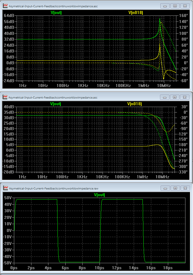

Example from a CFA i'm working on.
First image:
1 -no cap. the amp is not stable.
2 -7pF paralleled with feedback resistance of 5.9 k: Amp stable.
3- 1Mhz square wave with 1K/50pf of low pass filter.
(Yellow is the feedback )

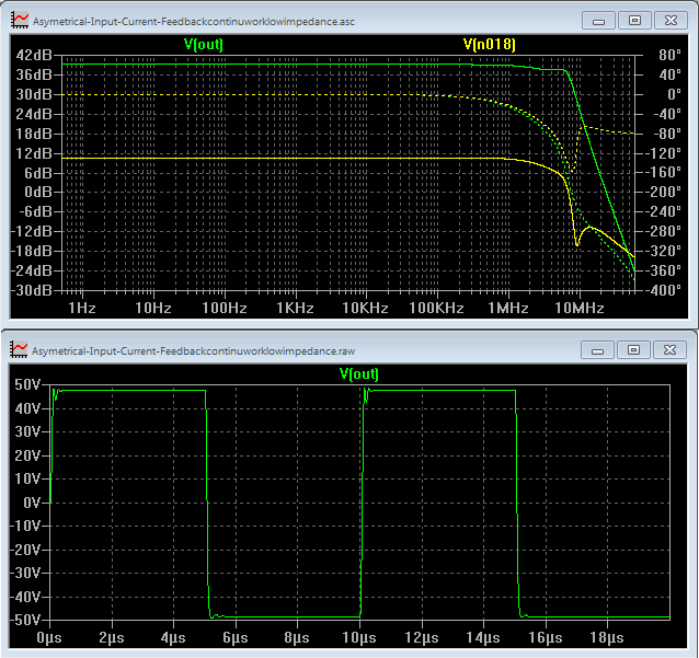

Second image: idem, Cdom: 0.6pF (for no peak in bandwidth) low pass: 1K/55pF
