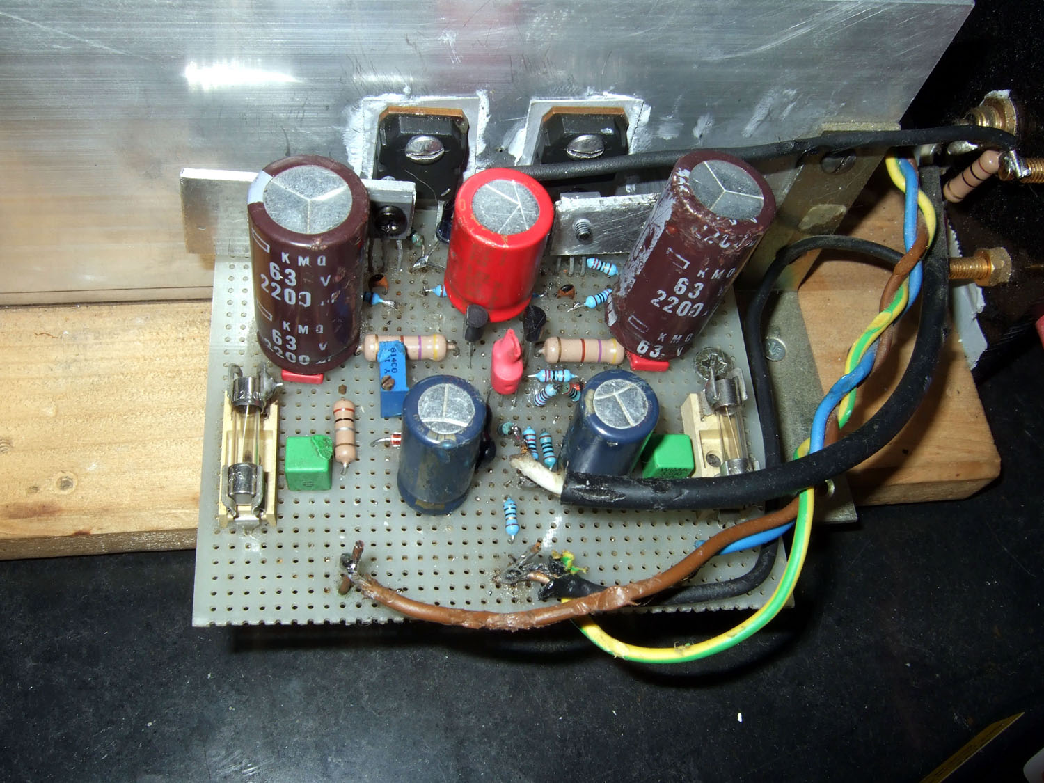

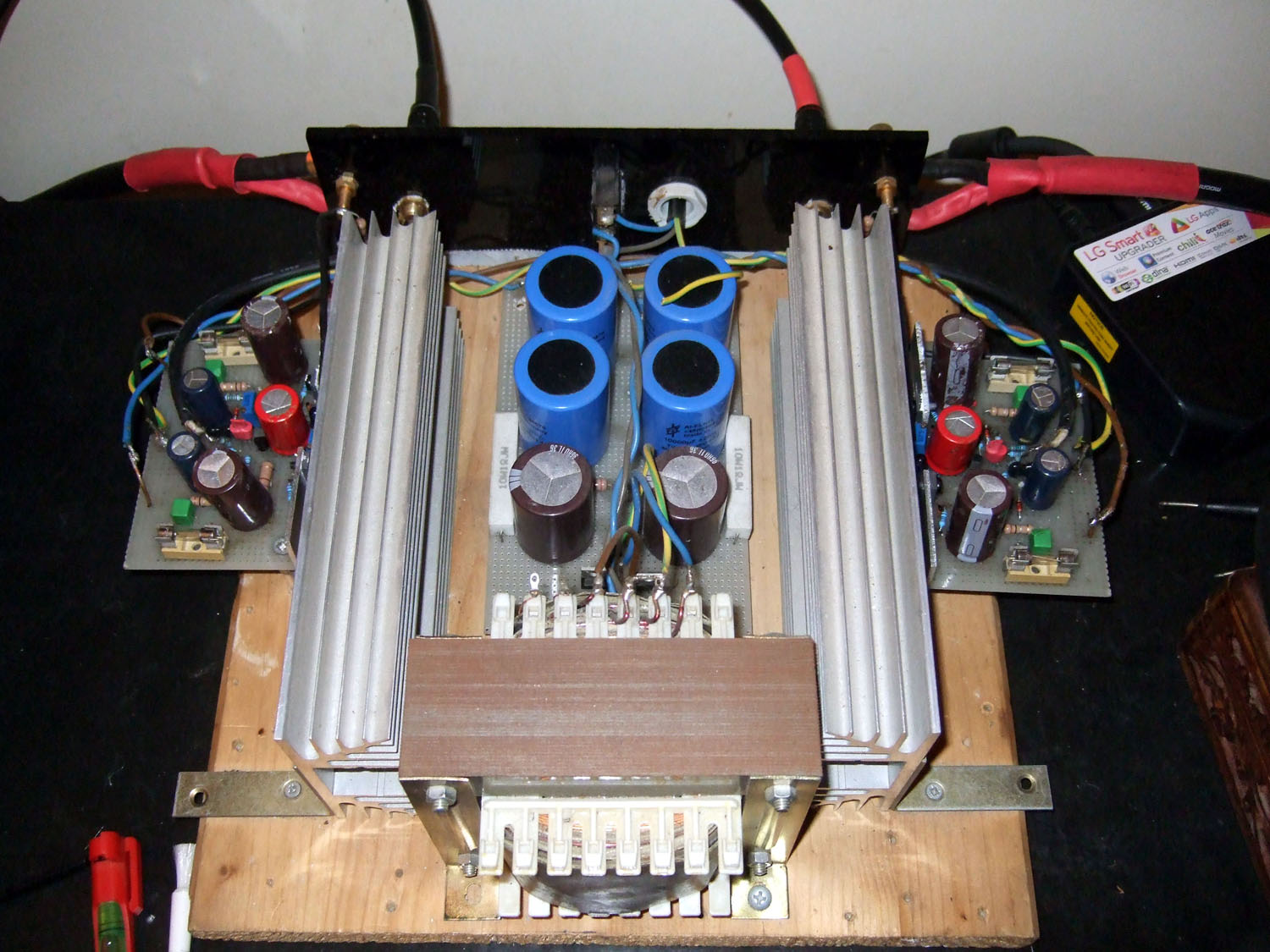

Went to a friend's to see and listen to his SSA build I was talking about lately.
Its based on Shaan's with the following differences:
1. No input coupling capacitor.
2. No 10K trimmers, no 1 Meg to input.
3. IR LED + 100R series trimmer output stage bias scheme instead of 2 X 1N4148. Bypassed by 470uF BGN as a whole. Gives freedom to match channels bias. Running at about 175mA in this amp's case.
4. 1.42K (1K2+220R) current feed resistor, its symmetric one is 1K trimmer + 500R in series. Does the offset trimming.
5. 270R instead of 220R as cascode load resistors. 1.5K instead of 2K2 feedback resistors. 24dB gain, 44dB OLG, 20dB FB instead of 27dB, 40.5dB, 13.5dB.
It did not show more than 10-15mVDC offset after many hours of play. No turn on thud, no turn off thud. Just a mute woofer pump maybe 1 or two 2mm pk-pk travel for less than 1sec at power off.
No noise no hum, built on iterated matrix boards, AC ground lifted though.
Smooth detailed expressive sound. Very good timing and presence. Maybe a bit softer than life IMHO in the brilliance region but it kinda shouted ''Latfet" to me about that trait. Fully retrieving though, just a slight tonal characteristic rather helpful with the many bit strident recordings or happier tweeters etc.
All in all, finally a current feedback rather simple 40-50W Mosfet amp you can expect it to succeed as a build when with typical DIY instruments and knowledge. Not too hot, not too big, but with a generous musical heart. Kudos to Shaan for arriving to a workable basic SSA with common semis example and sharing it, congrats to my friend Michael for keeping it stable when he reduced it to even less parts.

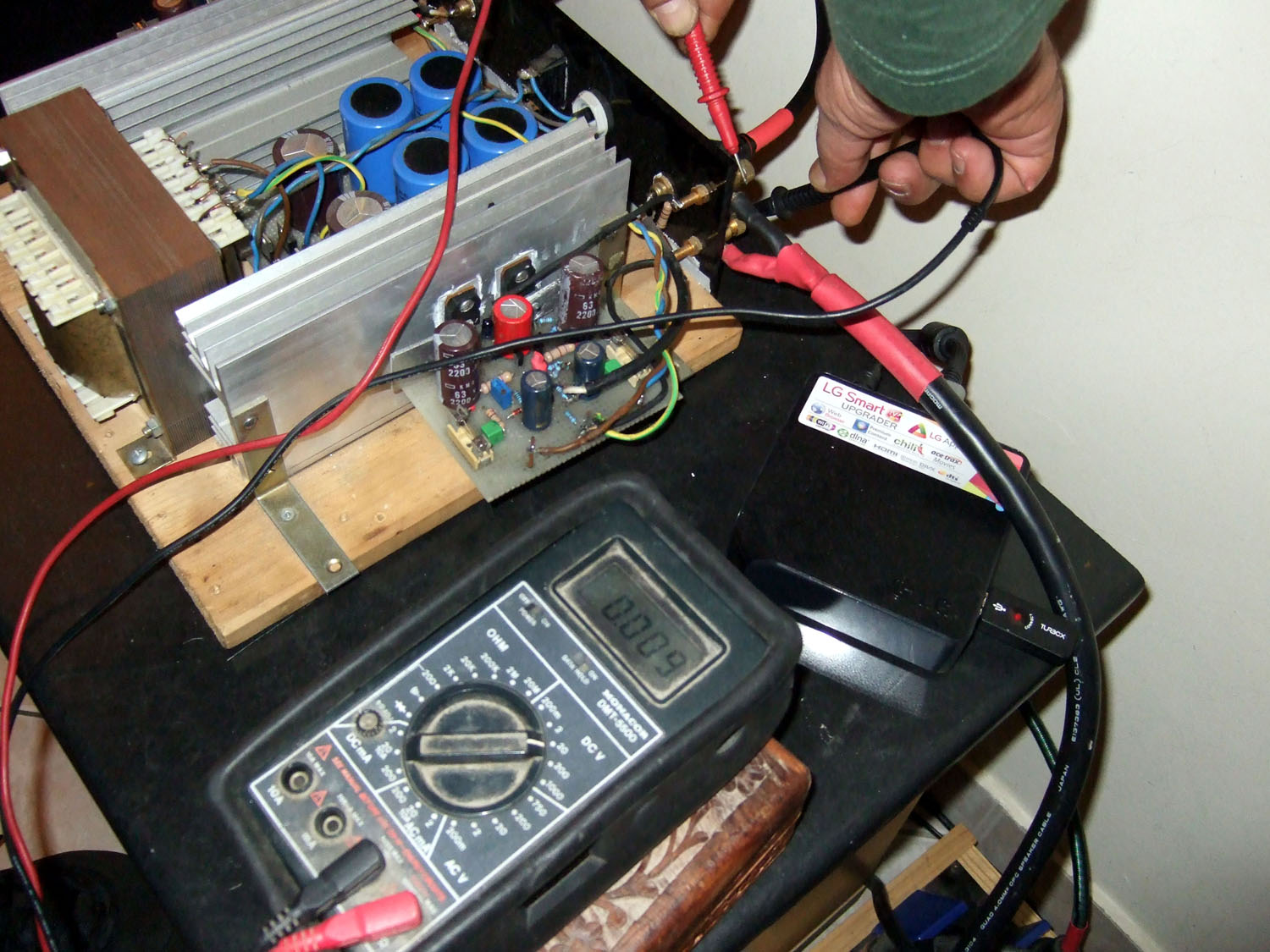

It is not measured in significant conditions...
It s not enough to power on the amp , wait a few minutes
so the input stage transistors have reached thermal stability
but with almost no heat transfer from the power transistors
to the small signal parts.
What about if the amp is cased , what would be the thermal
influence on DC offset from powering on the amp until it has
reached the casing thermal stability after let say half an hour
at modest level..?..
It was playing for 5 hours on 87dB speakers, he lifted the TT arm and I took the offset photo. The sinks were warm to hot when touching and were radiating on the boards, caps being little warm. Had also stayed on overnight many times without DC run away he told me. That's all the info I got.

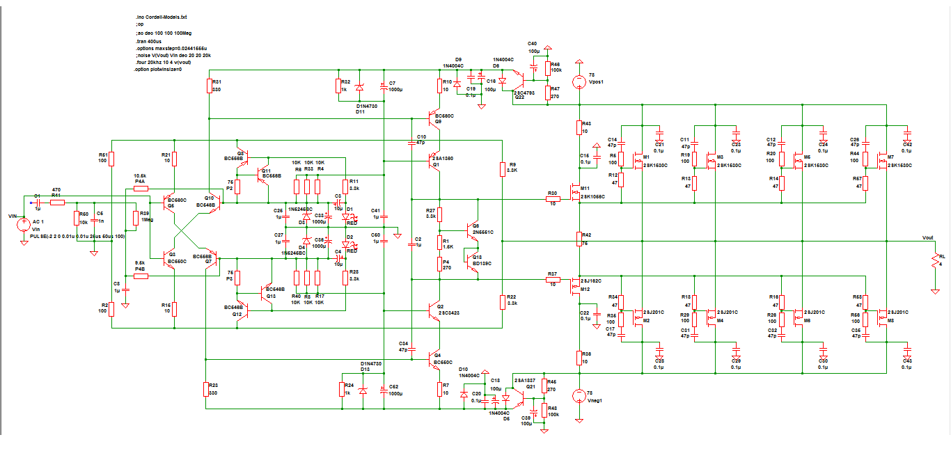

Thanks for the encouraging words...I've used the value of 1k from LC's schematic and haven't found any problem in simulation so far....As you've pointed out, i'l try to fine tune its value...
Hi LC,
Thanks you very much for the very interesting topology that you've given us...which actually got me in back to making amps... Yes...i'm planning to drive a pair of custom made 12" drivers...with this version of SSA beast.
Shaan,
Here is the screen shot of the scheme based on post 347....
Hi LC,
Shaan,

i'd like to use Laterals for drivers, to provide suffiecient current to charge / discharge input capacitance of these Vfets. I've sucessfully used this setup in another amp which i've made about 2 years ago. I've learned somewhere else from this thread that the PSRR is not great with this kind of topology and hence i've added a Cap multiplier at the rails to power input stage.
The amp performs brilliantly in simulation. The THD20 is less than 0.015% near clipping at 4 ohms. The square wave response is good, clipping action is excellent without any clamping diodes, etc. Now the question is will this circuit work...?as shown. comments please....
I didn't check your ASC file. But yes, the base front end with cascoded VAS as designed by LC has very low distortion. But when we believe that 0.001% is hardly different than 0.0001%, I cannot see no reason why to use cascode as I have suspicious with its sound quality unless another stage is added like in yours. Your output stage is very common and has good sound reputation and has been used in similar circuit of high end amp. I think the combination will produce very good or top result.
I will be building a cascoded VAS SSA without additional driver to see how good it can be. Rail voltage is 75V, bias is around 150mA. The good thing is that all harmonics are well below -100dB and the mosfet got more than enough current for a very wide bandwidth and speed. The bad thing is that it is not stable in simulation. After all other things have been "optimized" I can only get it to be stable against 27nF in parallel with load. But it seems that in real life it will have better stability.
Surprisingly, the SSA topology works very well with darlington outputs.
