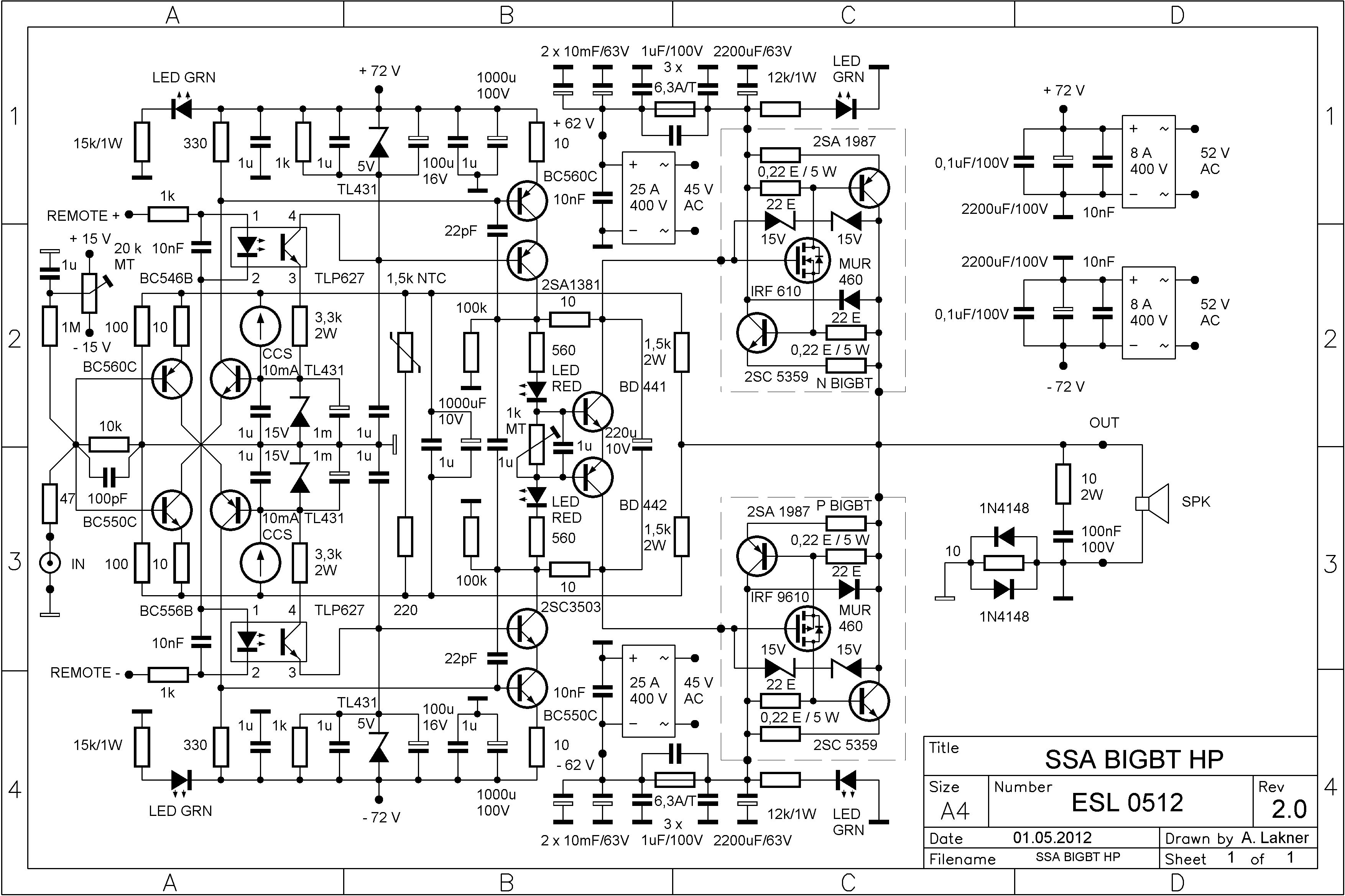

Simple in in the matter of working principle. If you design each part (Css, or power stage, as example) as a "blackbox", it is simple. And you can build a basic schematic designed with few components.but let us be honest and not call it simple
But i agree, if you look at this schematic with all the spare components, simple is a bad translation of the acronym.
Take-it for 'Sophisticated Symmetrical Amplifier".

Hi Lazy Cat,
I have been playing with different o/p schemes in spice including BIGBT and I have question about it.
It seems to be a combination of a MF / BJT darlington & a MF / BJT CFP so I was wondering why it does not suffer from the oscillation problems we hear about when CFP's switch ?
Regarding the harmonic spectrum that was mentioned a few days ago I have to say that I see almost no difference between:
MF / BJT darlington,
MF / BJT CFP
BIGBT ( combination of both )
All give a very nice spread of steeply falling off HD from 2nd down through 5th.

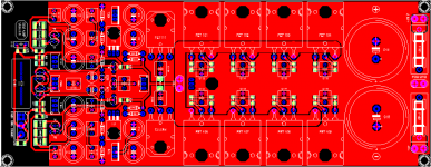

Magna... that is a neat looking PCB.. Do you have a schematic as well..?? output seems interesting...
sorry I Found your LT-spice file.....🙂 V-FET...
Nice circuit, like your CCS for current injection.. are you sure the 1k Ohm resistor from the rail to the inner spread is not too big..??

I'm not sure if I understand correctly what you mean but all share one common feature, that is mosfet driver, which serves to isolate sensitive voltage drive signal from VAS to transfer it almost ideally to base and consequently to collector current of the output device. Looks like a BIGBT as a combination of both, collects more positive features and at the end results in a superior triple-to-one device than just common BJT driver-output devices.
As higher harmonic distortions clearly showing to be lower, indicates that output regulation for circuit inside feedback loop can do better in a broader bandwidth region because of ease of drive an outputs - less VAS distortion.Regarding the harmonic spectrum that was mentioned a few days ago I have to say that I see almost no difference between:

Hi lineup
SSA BIGBT HP 2.0 sch has the same basic topology principle as the one from post one, only that is transformed to be much more universal to majority speakers demands available on the market, regarding power/current levels. Nothing really special here, three stage amp as usual, only that it has CFB topology, input/output signal subtraction in a first stage so all parts of the circuit inside feedback loop, except input low-pass filter. Basic principle of this topology attached. 😉

To lineup about "A difficult amplifier to build":
I believe not, because it does-not require complicated tuning or exotic parts and is rock stable.
