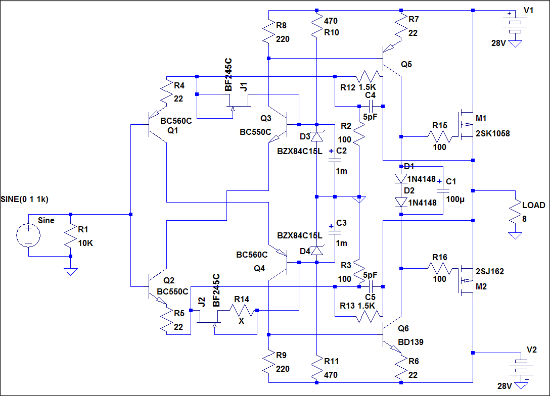

Can't say, more when I will visit. Meantime he will try BF245C local CCSs, 1.5K feedback resistor instead of 2k2 is next (ups OLG to 45dB and FB to 21dB).
Yes. But I was particularly talking in respect to the resistor current only. There may be many more ways to change the current through the VAS, like increasing the PS voltage. 🙂

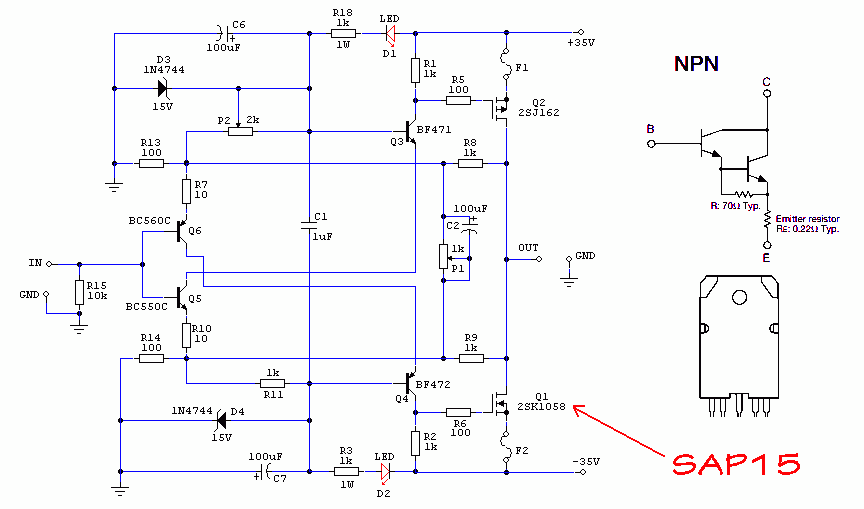

Its a bridge system, balancing factors are many to tweak, yes. There is no VAS by the way, its just a 2 stage amp, thus challenged for OLG. There is an input symmetrical cascode and a Sziklai BJT-LATFET compound output pair.
Common emitter output? Hmm, then I think the resulting sound will be way different from my build.
Sorry, its source follower like yours.

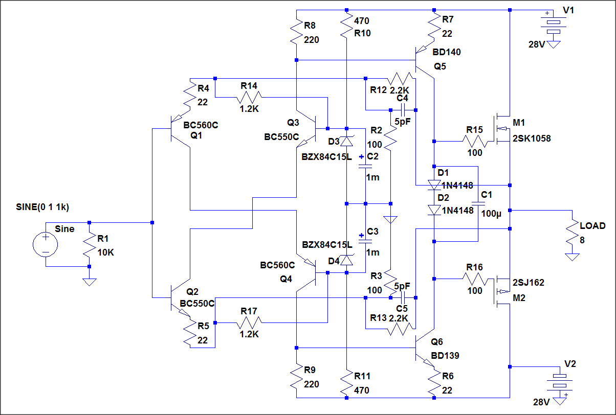

Can you please show a schematic, Salas?
He had made this, going to try that. (10pF C4,C5 is better if 2nd successful IMHO).
Hi Salas, I failed to see a BJT+MOSFET Sziklai in the schemas, as claimed in post 3367. Do I miss something? Also, IMO, Q5 and Q6 makes a symmetrical voltage amplification stage or VAS.
The schemas look very close to mine, however. All the best to the experimenter.
I wrote sorry, I remembered wrong (#3370). I also wrote he made your amp sans just few details.
Ah. I see.
In a much earlier post I think LC warned you of the thermal dependency of the BF devices. Is this okay? Coz offset can go trolling in a funny way.
They were OK in the old amp, their negative tempco helped the input pair even. As for what will do in yours, I will know in due time.

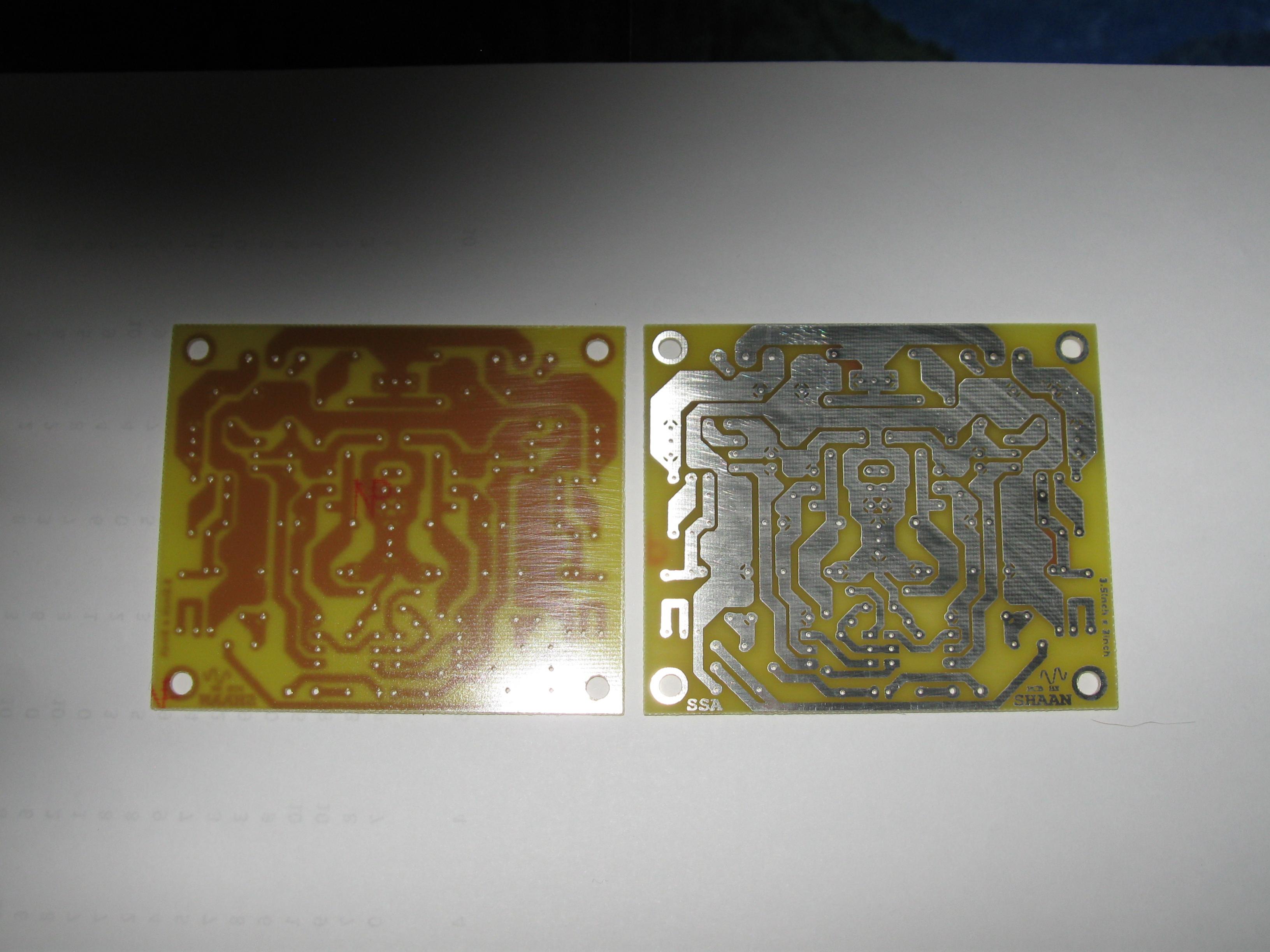

Nice and sharp job Cambe!
edit: Hi Cambe. Did you forget to mirror the artwork? The peeceebee looks like printed as-is, reversed
. Well, won't be a problem if you flip all the parts and PS also, I think.
nicely done!PEECEEBEE done. Now to order parts. 🙂 Thanks!
