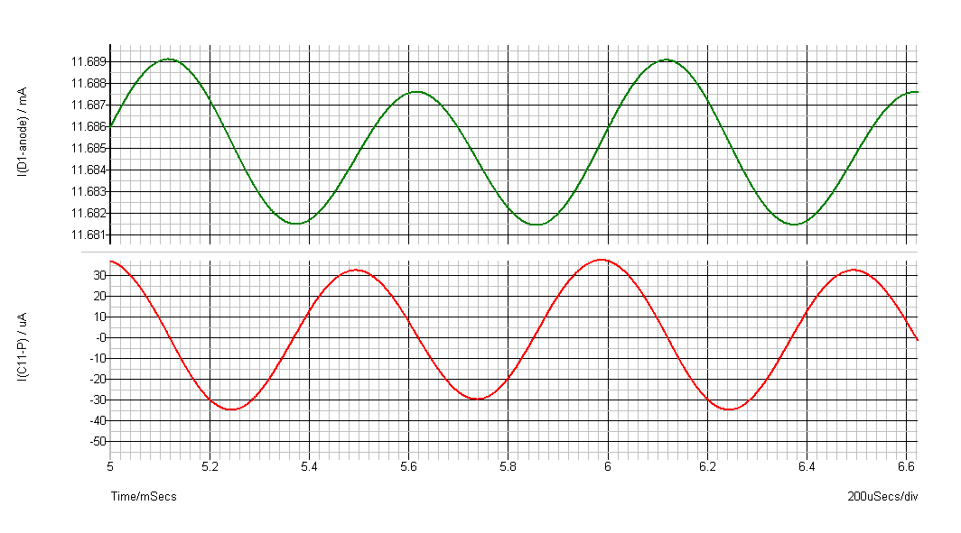

Shaan that is a fresh build, its only some news over the phone. I will see and listen at a point. Has to solidify in build details yet. 200mA is his per rail total, 170mA his output stage. It just gives 40dB OLG, 33kHz OL-3dB and 13dB FB if you close the loop in LT SPICE, maybe he misses some damping, who knows. What current you draw in your 1K2 resistor CCS on your amp? Just tell me the voltage drop over those. Is it in 12.5 to 15mA ballpark? That will help to choose JFETs and to see how near those amps are between them.
The current in the 1K2 resistor is indeed 12.5mA.
Still you bypass the diodes with an electrolytic for AC in your amp. What goes on if you snub that cap with 0.33R 1uF MKP?😉
I used the cap to bypass the diodes for the AC currents in the VAS (see attachment, green trace is current variation in diodes, red trace is AC current through cap, 8uA through diodes vs 60uA through cap!).
Now, why I did this? Coz its common practice, and makes sense.
