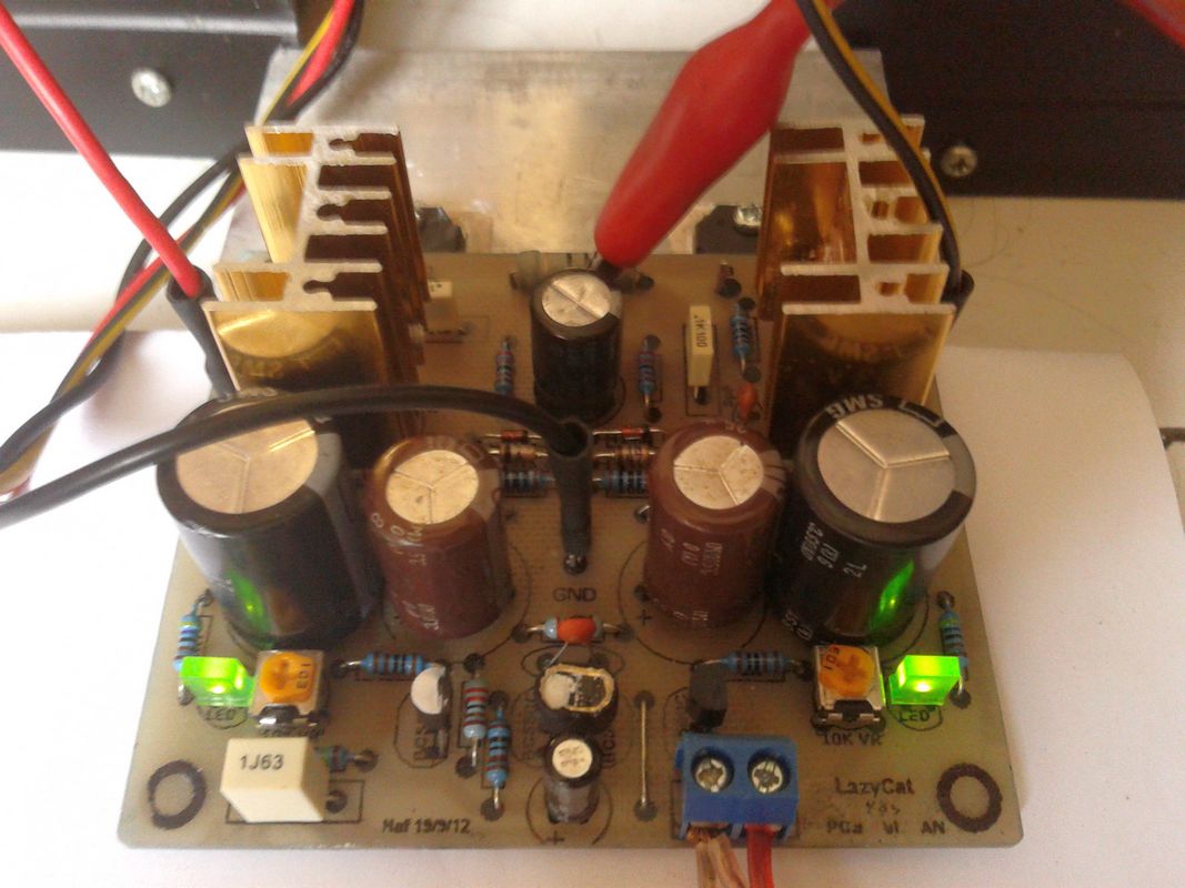

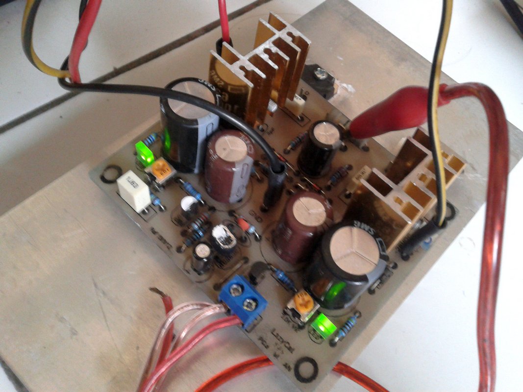

We need more photos with your amp at work, don't we?
Dear Salas,
this is the last picture i take when my SSA playing music... sorry for shake picture.
When you will pack it up in its final box measure the temperature on the electrolytics. Rule of thumb is you double half a quoted cap's spec sheet lifespan for each 10 degrees decrement from printed max temp on the cap's sleeve. The 85C black SMGs will go first in other words, but if the temperature is moderate they are going to live long enough. Example: If you got a 2000 hours 85C electrochemical capacitor working in a 55C environment, then 85C-55C=30C i.e. 3 times 10 degrees less than its max. Half 2000 hours is 1000 hours. 1000*2*2*2=8000 hours. That is how long it will live if the manufacturer is accurate and reliable.

Thank you Sir for the tips and sample calculation, i learn something new. :worship:

I can only agree with Salas. They wear out to fast in a class A amp.
@Shaan
When its boxed up and put to its resident place after an hour's work its good we know for any amp. 150mA is not low for A/B but it depends on sinks as you say.
P.S. Even when transported in non pressurized air cargo bays, wet electrolyte caps lose some by the way.
Mmmm, maybe a cabinet with good ventilation is the way to go, even for AB.
But then again just look at naf's main sinks! Whoa!
That should keep the fins under 50C probably. Key is the temp on the caps when boxed and installed Always good to know, the relative lifespan reference came in the flow of discussing Nippon and types but its generaly useful. Not that Naf's test build is a worrisome example.
