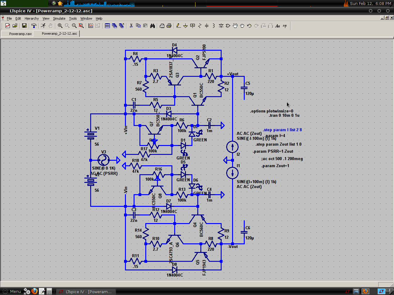

For supply filtering and impedance I don't need the diode... There is another goal... but anyway, the question is... to make it simpler, will you use it in Shaan schematic?
I was afraid that rough simulation will not be precise enough to predict it's behavior...
Simulation could tell you performance specs, but those specs on't tell you if you ill like the result or not if your goal is to enjoy the sound. Simulation ill help you understand hy something changes the sound, provided you already have empirical observations to begin ith. So the process in this sense is backards: test first simulate after to understand.
As for filtering, I think it is orth a try on the current sources and/or the VAS, since there are still unprotected Early junction effects, but I think the difference ill be small. I think there may be a bigger improvement if you filter the rails ith my poer K-multipliers, so the FETs get a regulated rail. Hoever my Kmultipliers seem to ork much better on BJT output amps. I don't have a lot of experience here but the small signal area of the amp seems ell protected from the rails.
Another factor is rectifier spikes on the rails, if your supply isn't ell filtered.

Simulation could tell you performance specs, but those specs won't tell you if you will like the result or not if your goal is to enjoy the sound. Simulation will help you understand why something changes the sound, provided you already have empirical observations to begin with. So the process in this sense is backwards: test first simulate after to understand.
So far I believe in simulations (coupled with good engineering judgements). I can build circuits and compare by ears, and my ears is very good enough to rely on, but I want a quick and precise approach by knowing what to look for in simulation. Then I will know how to get the best.
However my Kmultipliers seem to work much better on BJT output amps.
I don't use BJT regulators in FET amps. Sometimes I use FET regulators in BJT amps (class-A). But I prefer BJT regulators for BJT amps. I use the simplest BJT multiplier for my SSA_BJT. Might try your K-multiplier, but I'm skeptical.
Power supply should be part of amplifier design. I started with transformers I have on hand. Lowering and (often) raising rail voltage of a finished amp will reduce performance 🙂
I think it has a mix of dynamic effects, including sag reduction depending on hat the R value and here it is placed.
A silicon diode has effective R of about .033/Id. R decreases ith Id. This is nonlinear, so if you give a diode a sine current, the average resistance ill actually be loer, and the voltage drop of the diode. Thus you have a dynamically changing RC filter. In fault conditions, it prevents frontend rail sag, but not entirely because it pulls some current to turn the diode back off.
I think this behavior must be helpful for the amp, because I've heard from many people that DRC is the ay to go.
Another effect may have to do ith ringing on the rails. If there is ringing through the diode, the sine current ill raise the diode's resistance, and then the resistance ill recover after the ringing is gone. It is like a dynamic auto-damping effect. Furthermore, the nonlinear action orks like an RF mixer to convert the resonance to other frequencies here their energy is lost from the resonance.
Series and parallel resistors have been used to tailor this effect. A small series resistor may be in order to damp any resonances through the diode's parasitic capacitance depending on ho large a diode it is.
So it seems the diode may be having the effect of breaking don rail resonances. This seems useful, but it may also be a sign that the rails are resonating and decoupling needs to be reevaluated. After all the diode can only help resonance after it has started (unless of course Id is chosen beforehand to apply the correct damping resistance).
