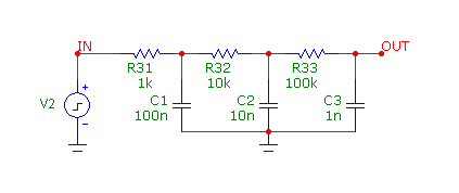

Look here why that is so:

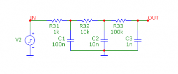

Fig. 1 is a simple 3rd order LP filter

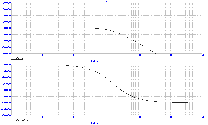

Fig. 2 depicts the frequency response. Notice a phase lag of 180 degrees at 2.84kHz. Does it means a delay 0.5/2.84k = 176 us? NO! Look at the next picture.

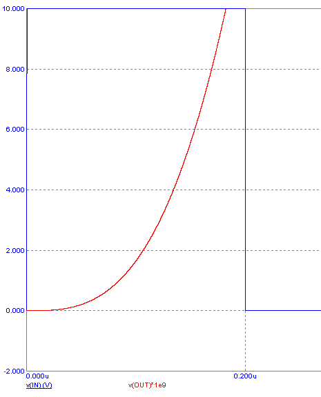

Fig. 3 shows the onset of the step response. Notice that the output starts immediately to rise. Due to a limited resolution, you will see the rising only a few nanoseconds later. Anyhow, it doesn't start to rise 176 us later.

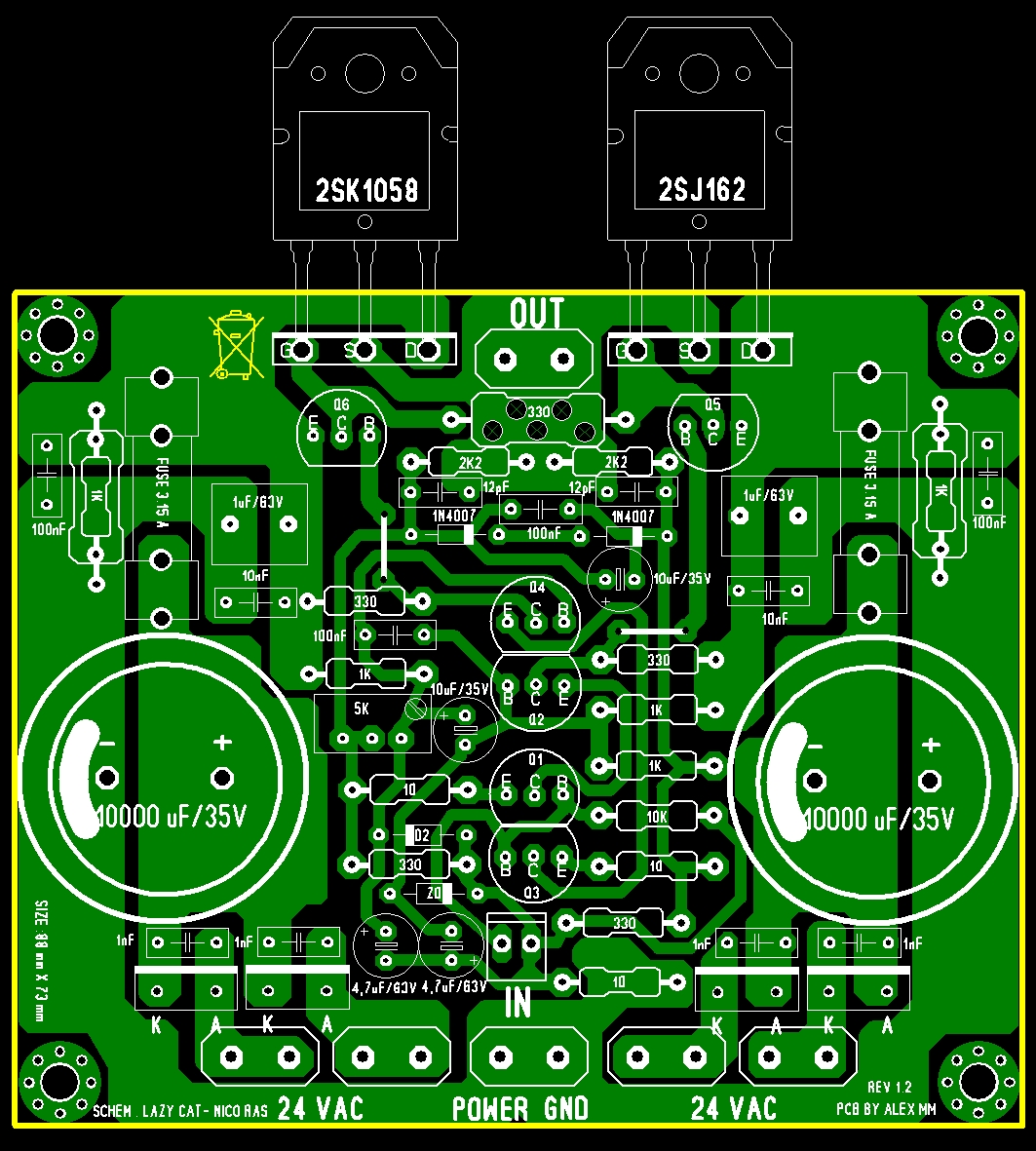

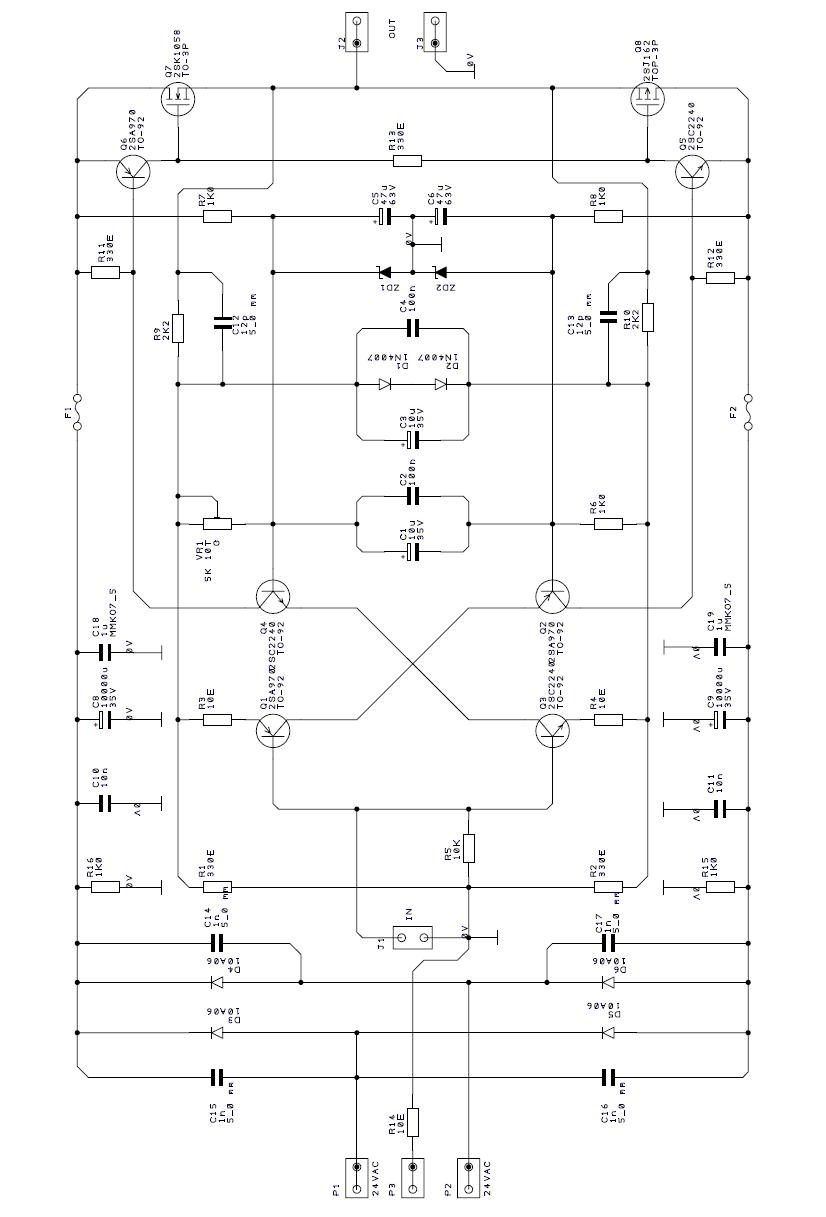

.... thanks to all for helping me to layout the correct PCB 🙂 and kinds words , I do my best , learning something all time .....😉
Alex.
Hi, Alex MM
I just wish the "PCB", without components
to do with the method of the pplancha, "heat transfer"
"Post number 158"

Sonnya, Apart from propagation delays of the medium at use (e.g. copper or whatever), the onset of the response isn't delayed. If you keep thinking in terms of delay instead of phase lag, you will never understand why NFB works as it does work.

delay time (or latency) vs phase lag.
Sounds like semantics to me. Whatever you choose to call it the voltage rise is delayed so there is a delay - even though it is called current feedback in fact the i/p transistor compares voltages. So if the voltage rise is delayed, there is a delay before the signal gets back to the feedback transistor. - end of story.
A time delay, IOW a latency (caused by long transmission lines or so) is mathematically expressed by: exp(-sT). It delays the arrival of signal at the receiving end by an amount equal to T without altering the amplitude. Thus the onset of the step response is also belayed by T seconds.
OTOH, a phase lag (caused by a LP filter or capacitances of a tranny etc) are expressed by e.g. (1-exp(-sT))/s, which does alter the amplitude, but it does NOT delay the onset of a step response or so.
If you call these crucial differences just semantics, you've missed my point (and fundamentals of FB theory).
