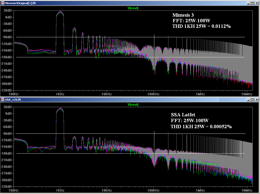

I have been long waiting for good high power amp utilizing Hitachi Latfet, and I have been hoping for the circuit to appear from SSA/TSSA thread.
But from a few circuits utilizing the latfet output, they are not very interesting because:
1) Low power (It seems that in TSSA topology the latfet cannot be operated at high power, and I couldn't solve the stability issues, but what the heck, IRF device works wonder. Ain't hexfets are so good at class-A!).
2) Not sufficient mosfet drive (Nico's version is the best among others but I'm not comfortable with simulated performance).
3) Not so good simulated performance
4) Not stable enough
Currently LC is developing the CSA, I think it is not latfet output but the old trusted BIGBT output. So I cannot wait any longer, I have to take the big risk 🙂D) and design a latfet output SSA/TSSA
The reference/benchmark is a Goldmund Mimesis3 clone. So the SSA will also use 2 pairs of Latfet, powered from the same power supply and set with equal gain.
From preliminary design today, the SSA and Mimesis3 has equal simulated performance except:
1) SSA is much better at distortion. High order distortions have been reduced at the price of 2nd order (and overall) distortion, by increasing the output bias to around 400mA per mosfet.
2) Mimesis3 is much better at stability.
3) Mimesis3 is better at high frequency performance (especially my clone of the original). The best I have seen actually.
So for now I will take a break (have been sitting for hours) and post the distortion spectrum (Fourier chart) of Mimesis3 and the SSA:

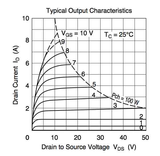

I have been working on the amps (testing).
But i am struggling to find the right solution for the TSSA AMP i promised. The following Will start a discussion.
I have three AMP here right now.
The TSSA , mirand modified, simple cfb AMP.
The mirand and simple cfb AMP shares the same topology and Sub -3dB point. The mirand is an bjt's output stage. The simple cfb AMP is an lateral fet output type. Both "EF" types.
basicly those two AMP should have the same bas reproduction. But that is not the case. The lateral AMP is a bit lower level in perception, and less detailed. There is information missing.
But the TSSA which is a Drain output type does not miss level.
I now a lot Will not agree with me. Some would say that this is not the case with pass amps. But they are actually Drain output types. (aleph)
We are now 4 Independent people saing the same here in Denmark. Sourcefollower lacks precision and level in the Sub region.
But Drain follower Will be tested wednesday by two more. But until now we are two saying that it does not lack precision and level.
Maybe i Will end up with a 100watt TSSA 2 stage AMP.

When you use lateral Fets at the output it is a good idea to go out of the drains. They are fantastic constant current sources. On Gm they are quite poor against bipolars so i think bipolars are a better choice when you want to go out of the low impedance output, emitter in that case. Laterals could be configured driving bipolars from the drain and the bipolars driving the output through the emitters. One problem remains : an emitter or source follower does not like capacitive loading. When you want to drive an ELS with a source or emitter follower you need an output coil and a Zobel.
I think it is more the positive temperature coefficient that come into account than the poor Gm.
In Sub bas impulses it has time to heat up, and the Gm decreases.?!???
