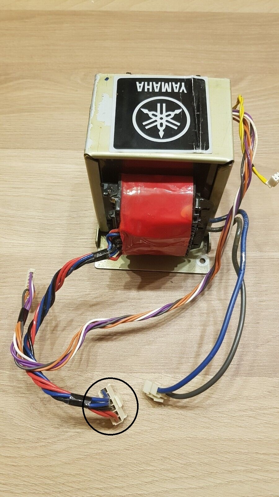

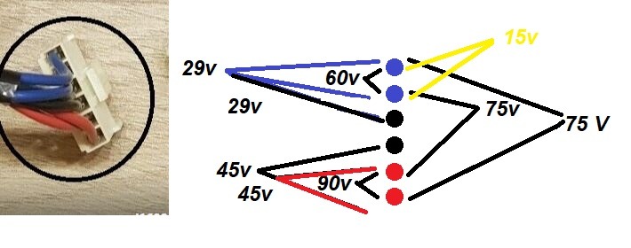

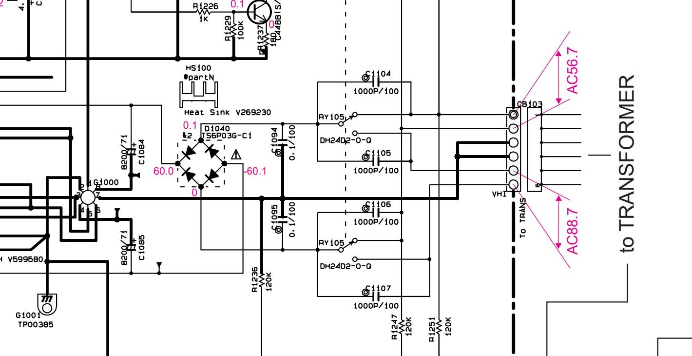

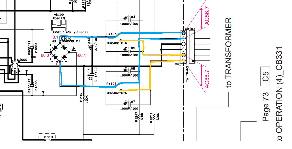

Someone gave me one non-functional Yamaha rx-v459 to use for scrap parts. The transformer has 6 wires ( the power ones ) with two ground and two sets of voltages, I think it is wound like double tap transformers for a set of voltages and a few more turns for a higher voltage, I do not know why there is a " selector " in the amp from low to high voltage. ?!?!?.

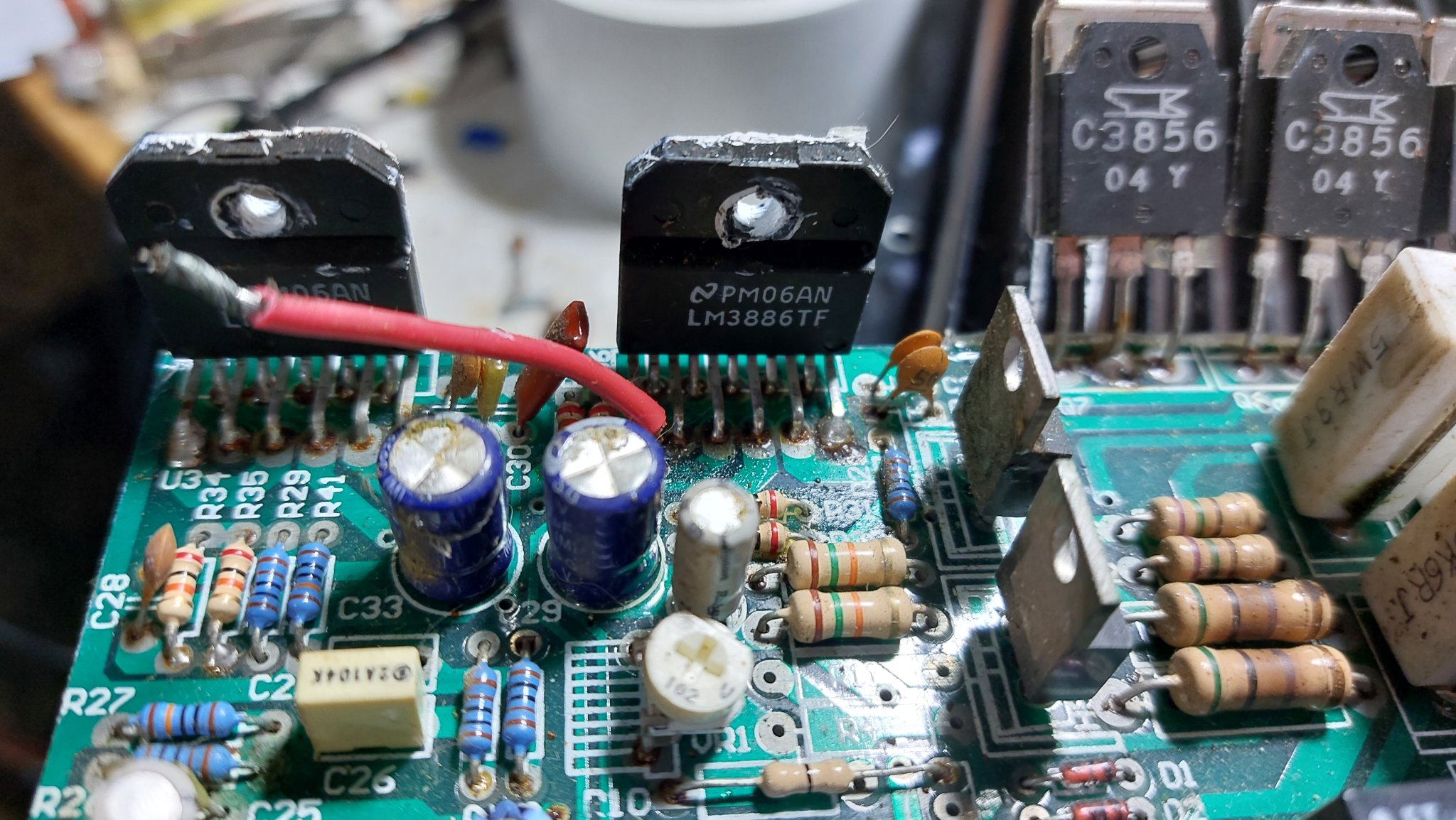

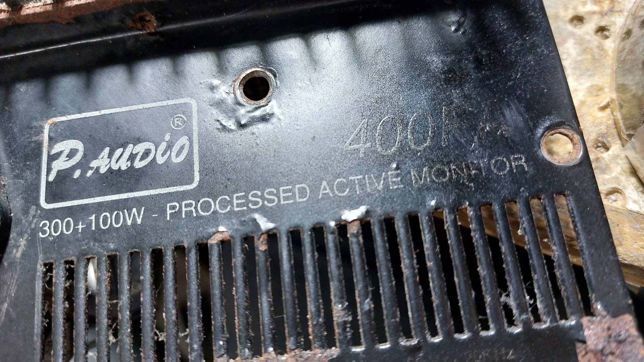

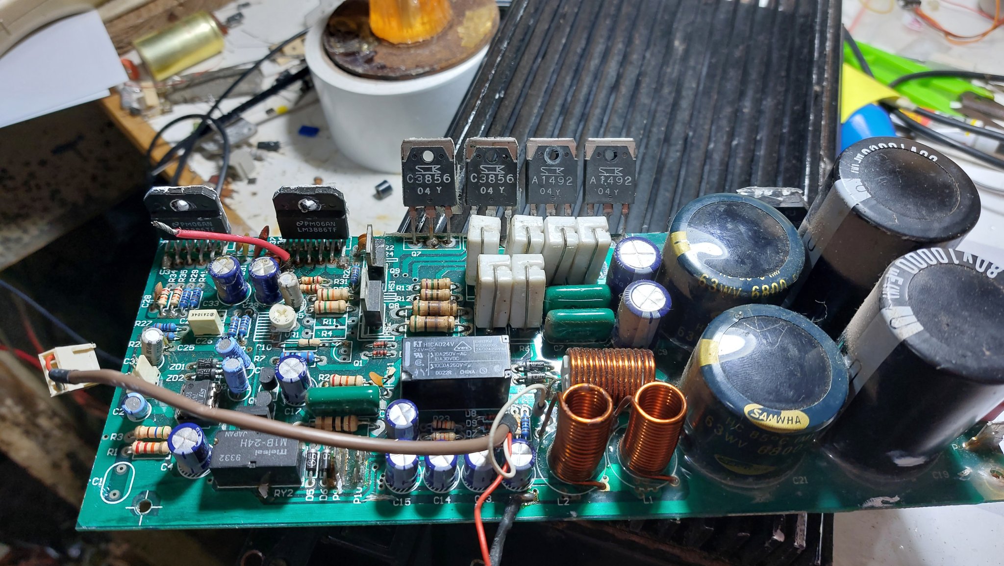

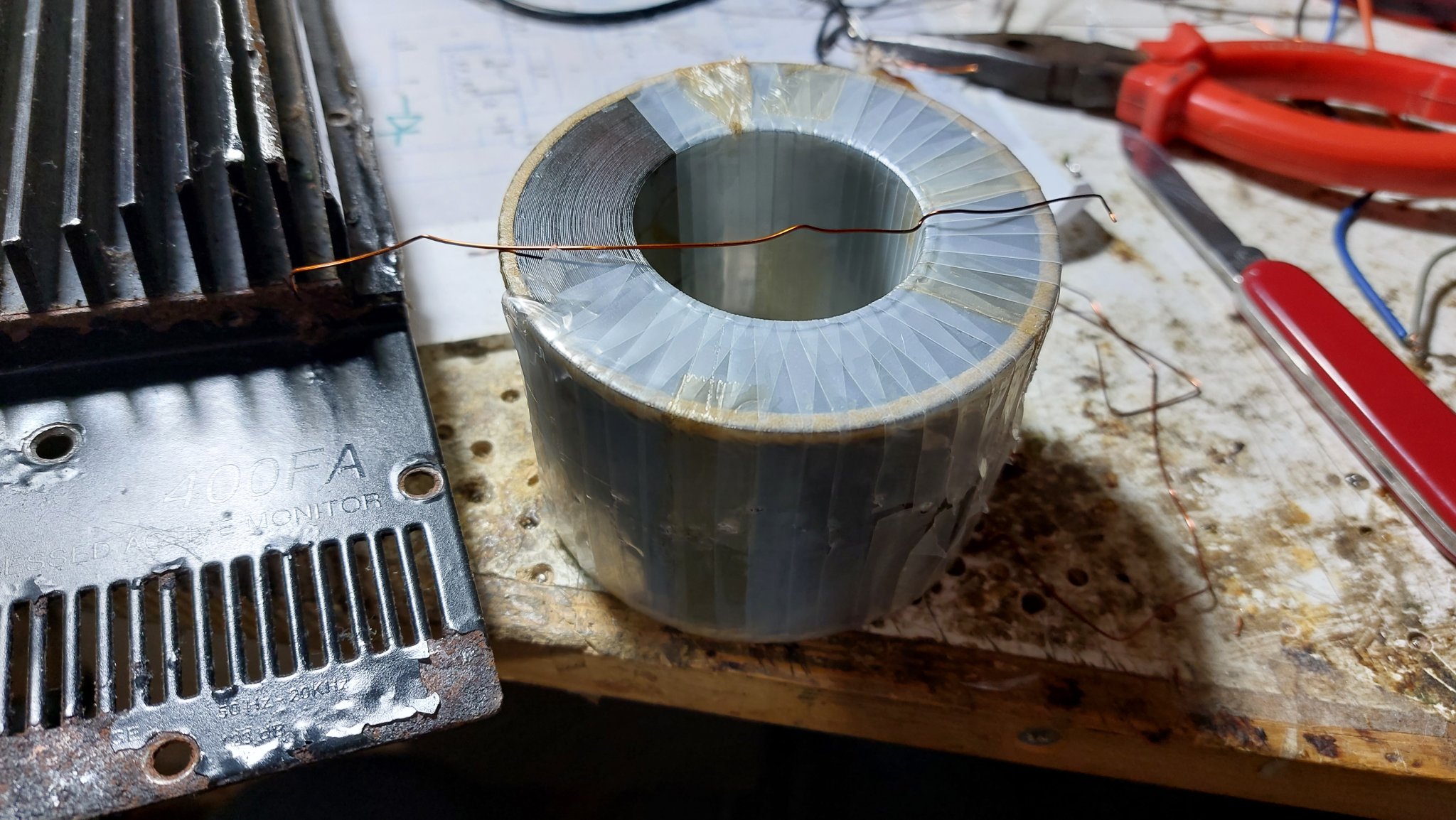

- I also took apart one power amp for a active PA 15inch speaker, it had two LM3886 and 4x 120w transistors, I think boosting the power of the LM's from what I've seen on the PCB, not sure if the LM's are in bridge , or one LM is for the tweeter. weird design, also the transformer from that one WAS VERY WEIRD, maybe auto transformer?? in an audio amp??. the secoundary was wired to the primary ( 220v ) on two of the wires, another wires to fuses from the transformer , I took it apart for pure curiosity ( RIP ) , it had only one wire like 0.6mm . Usually in transformers there is the primary with a smaller gauge for mains and the secoundary with thicker wire, this nope, had only one gauge wire for the entire transformer, never seen somethign like this for audio, I will post pictures later. !!!

Transformer is one part of consumer products that is mostly smoke & mirrors. I prefer to buy blown PA amps, which a have a real rating; usually are copper bound, also have the heat sinks case AC conditioning, fan controls etc.
Or new transformers with a rating. I think wgski said you needed something like dual winding 37 vac to produce +-50 v peak, at about 600 va. If your sub amp is 150 w mono, you could get away with a +-37 v 400 va transformer. Apexjr.com has a selection of useful transformers sometimes, or antekinc.com has usual stock. antek has +-15 v windings in addition to main winding to run op amps for filtering, input section, protection circuit, or whatever. My favorite supplier newark is usually cost prohibitive on transformers. Or If you can package one in a RF proof cage, you can buy a switcher supply. Those you buy the DC voltage you want, not voltage/1.4 like transformers. Beware switcher supplies on ebay/alibaba etc they tend to ship without heat sinks and fans, input spike protection blah blah. In case you didn't know 120 vac lines can have 1300 vdc spikes on them from A/C compressor shutoff. All PC's, flat screen TV's etc, have a MOS suppressor and a y rated cap after the breaker/fuse on the front end to absorb the spikes before the 200 v main caps see it.

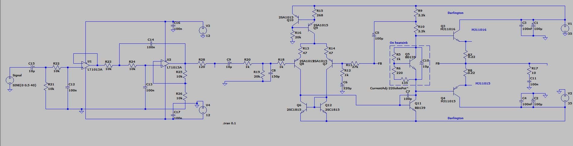

This is my final schematic, included low pass 18dB/ octave at 160hz . from here https://sound-au.com/project123.htm
For +-35v I used 2sc1815/2sa1015 , BD139 for Vas , and output trans MJ11015/MJ11016 .
Quiss current 80 - 100mA.
Measured output 24V (Couldn't go higher due to mechanically limits of my test sub. ) on 4ohm load, ( around 140w ?). +-35rails .
For higher rail voltages u can use almost any PNP / NPN .
BC546/556 for 40 - 45 v rails could work.
MPSA42 - MPSA92
MPSA44 - MPSA94
2n5551 - 2n5401
for VAS, anything with high voltage, hFE 50+ .

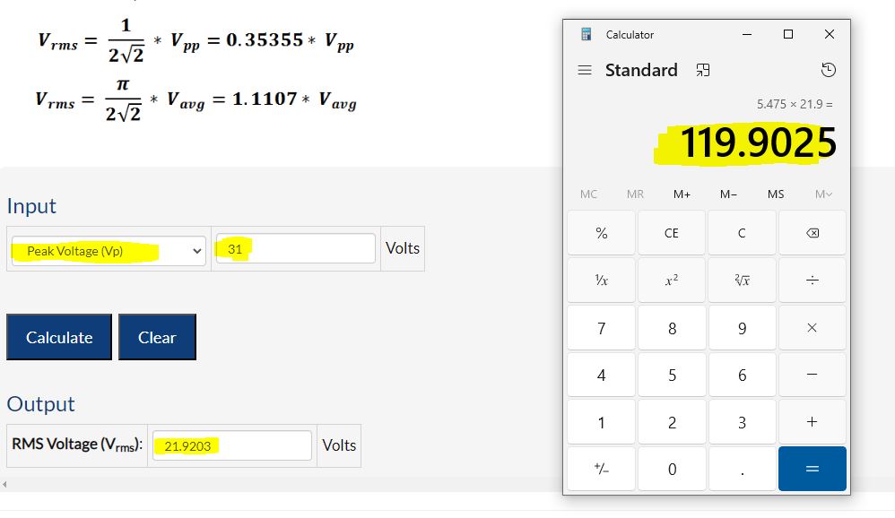

24 volts RMS requires 34 volts peak. You wont get that off 35 volt rails. 32 if you’re lucky, and if REGULATED. 24 volts peak is 17 RMS, or 72 watts. You might get a little more than that, but not much.
If that is all the sub will take before bottoming out there isn’t much point in going for more watts. I’m guessing it’s not a big pro 15” or car “superwoofer”.

Maybe I should've used other LTP, CCS, mirror transistors , for higher rails 40 -45 v , but there's plenty of power as it is now .

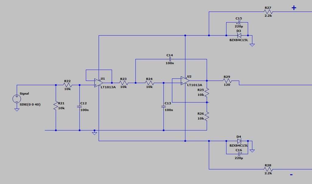

@Boden I haven't tested in real life but, in LTSpice it seems ok, 50n in parallel with R11 (27k Feedback res ) would do.
But the filter is simple enough to be built, can be powered by the rails with two 12 or 15v zeners , two 100uF caps and two 1 - 2.2k 1-2W resistors.

@wg_ski I don't know , my multimeter showed 24v max , average 20 - 22.
Multimeter? With what as a source? With music you could be reading almost anything. A low frequency sine wave and readings become believable. It’s easy to get 60 Hz (Find a little transformer and put a pot on the secondary). And the meter is accurate enough too at the frequency it was intended.
With a sine wave right at clipping one could expect 24 VAC (RMS) if the supply stayed right up at 35 volts. It would take about a 600 VA toroid, maybe even 1000 to be stiff enough not to drop more than a volt or two. What does the DC read, as well as the AC output?
