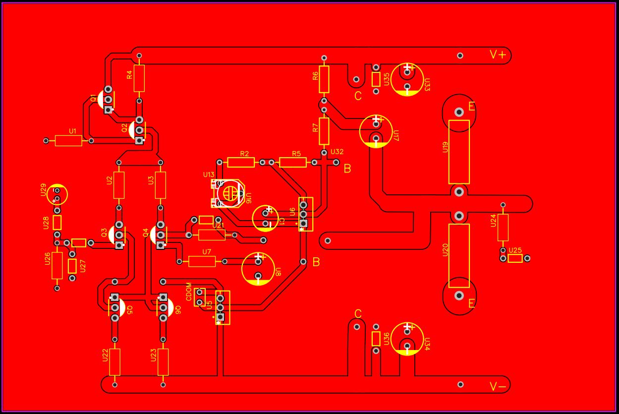

Hi, I'm currently building a simple amp for a 10 inch 150w subwoofer for a friend.
I don't have LTSpice models for mj11015/mj11016 , I just simulated with BD and some 2SC/2SA might not be the way to go, but...
  • Using darlingtons in the output stage might be harder to keep them not thermal run away? Should I place Q5 on the heatsink with the output trans or close to it?.
  • is it ok to limit the bandwidth with C12 ? or I should not and build a op amp based low pass filter at the beginning.?
* use low pass filter and also limit the bbandwidth as well? since it won't play past 150hz.
- 100W output is what I aim here. 200W 30A output transistors I think are sufficent , Since you can get 60W from a pair of 2SC4468/2SA1695 100W/10A trans.
- Bruno.

In my schematic there are no pre drivers, just the Darlington output transistors MJ11015/MJ11016 .
Maybe use pre drivers and mount the vbe multip on them on a heatsink, separated form the output darlingtons?.
I thought i don't need pre drivers as MJ11015 has high gain .
Also heatsink will be actively cooled by a fan.
Q11 BD139 should be big enough to drive the drivers Q1 Q2. Triple output gain (with predrivers) is for 3 or 6 pairs of output transistors. The output transistors are emitter followers, don't need a lot of gain. The drivers do.

@indianajo I already have two pairs of MJ11015 / MJ11016 . So , can I connect them directly to Q11 ? or I must use pre drivers before them ?.
They say hFE 1000 (min ) at 20A .

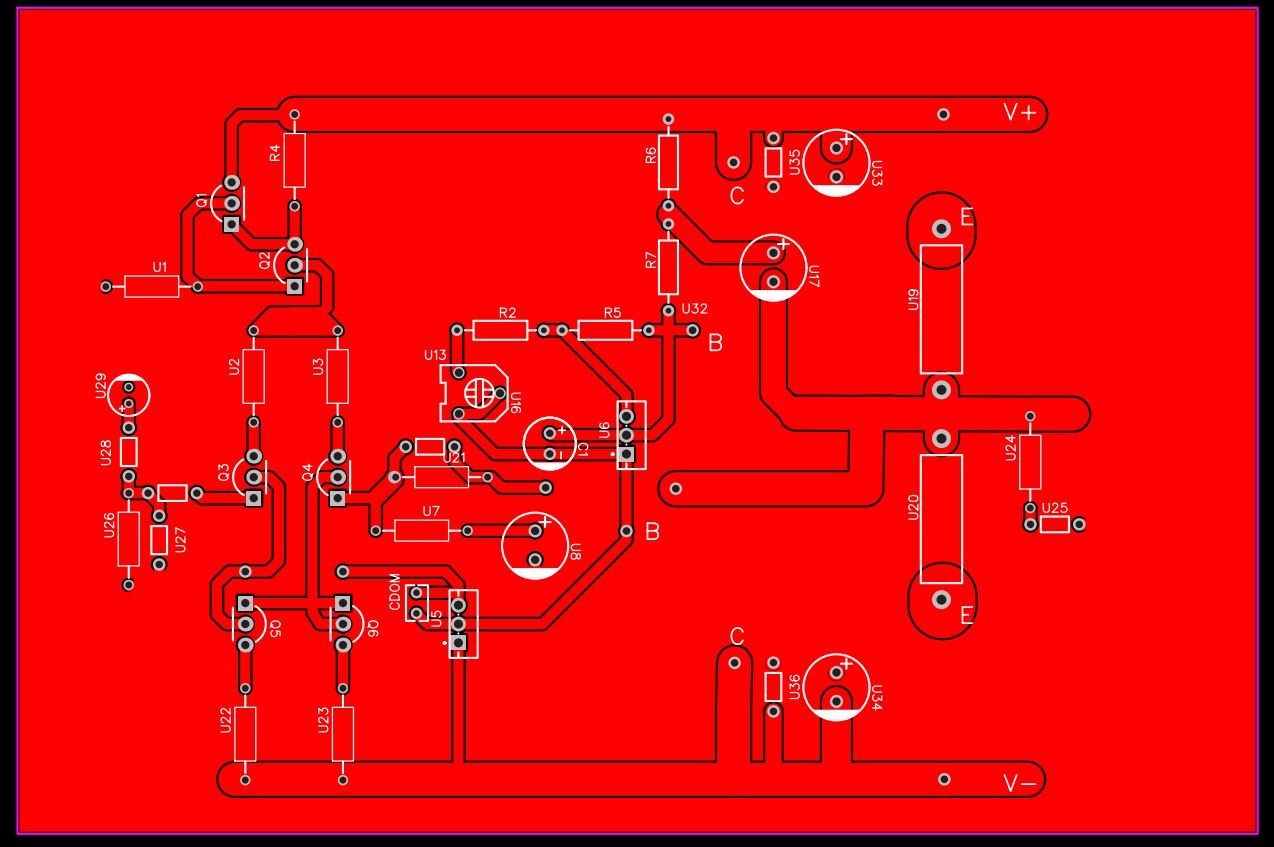

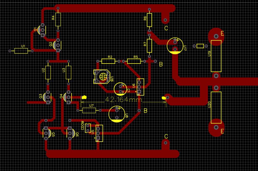

* For the Feedback is gonna be around 4cm on the PCB, should I leave it like that or use coax cable ? maybe with the shield on GND connected ?.

If your board is inside a metal case with RF traps in and out, you should not pick up radio on your feedback transistor. Even with 4 cm land to it.

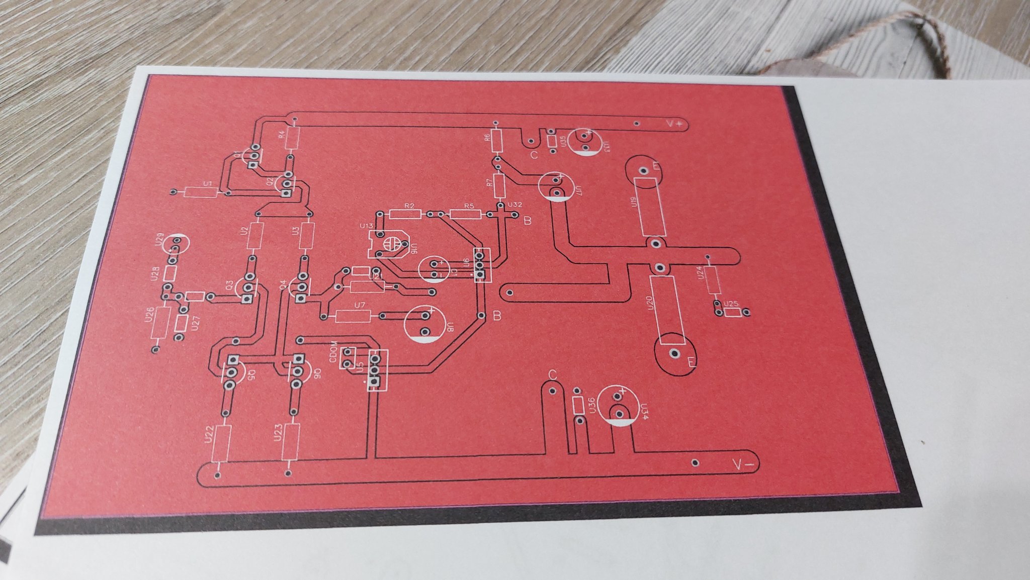

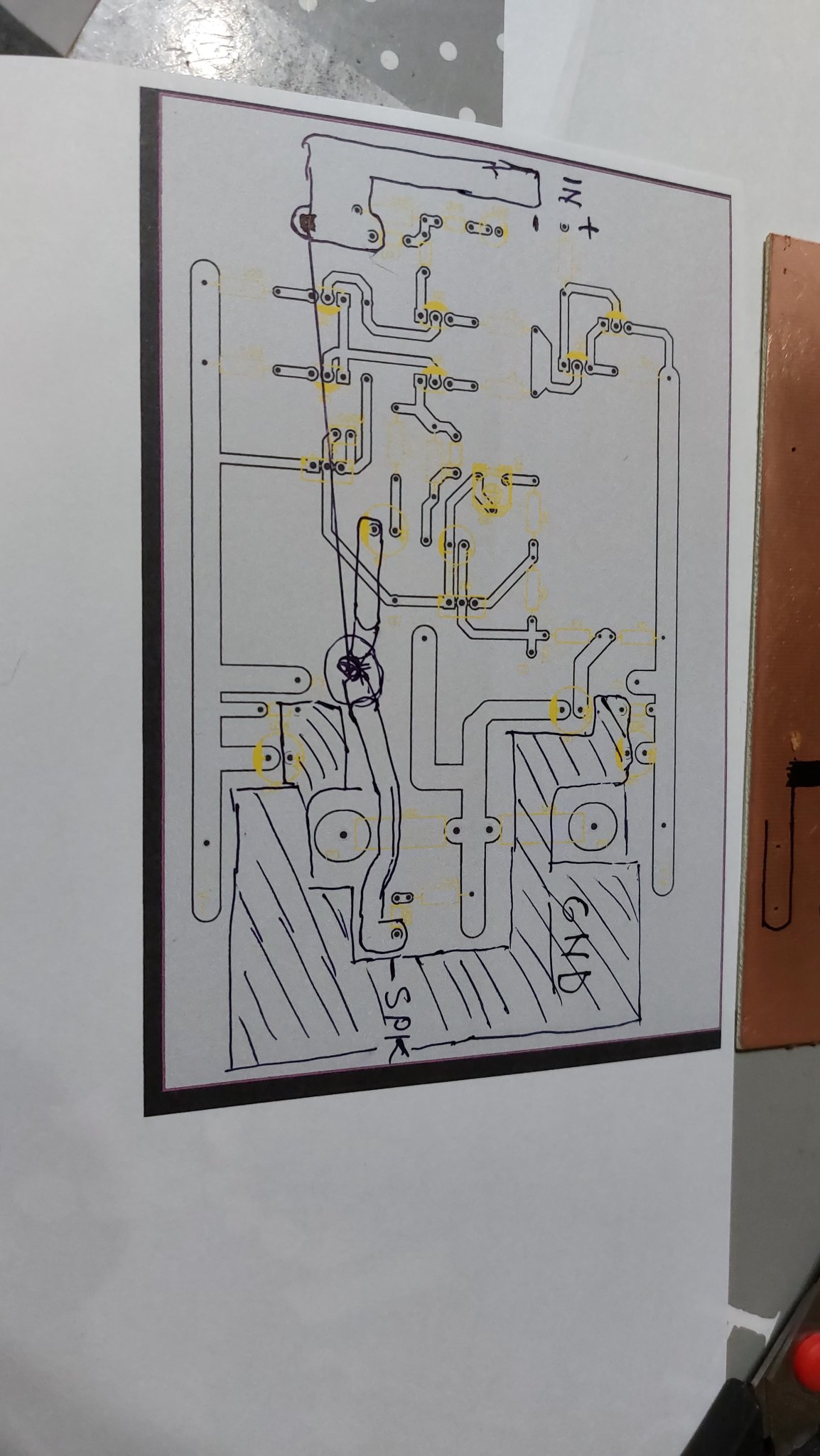

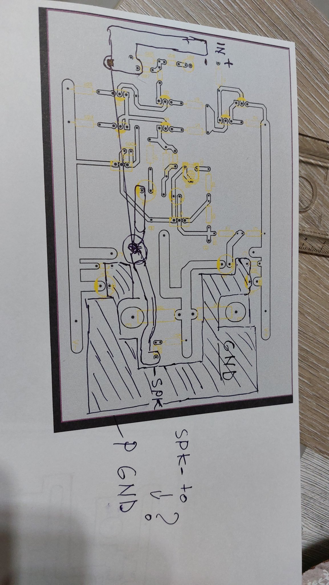

Ground plane is probably “good enough” given the application, but I probably would have tied the speaker, feedback, and input grounds to a single point, then ran a short trace from there to the ground plane.
I see youre doing it the old fashioned way. And pre-drilling, which actuslly makes it easier to draw. It also makes doing double sided boards possible. Harder to do an actual ground plane though - it’s a lot of coloring to do.
If you are going to pre drill, you could do the heat sink or mounting bracket at the same time and not have to run flying wires.

Sorry, I don't analyze PCB layouts. I hook up in 3D with wire. One tip, do not make long parallel runs of sensitive inputs to bases parallel with high corrent outputs from collectors. Capacitive coupling can cause oscillation.
