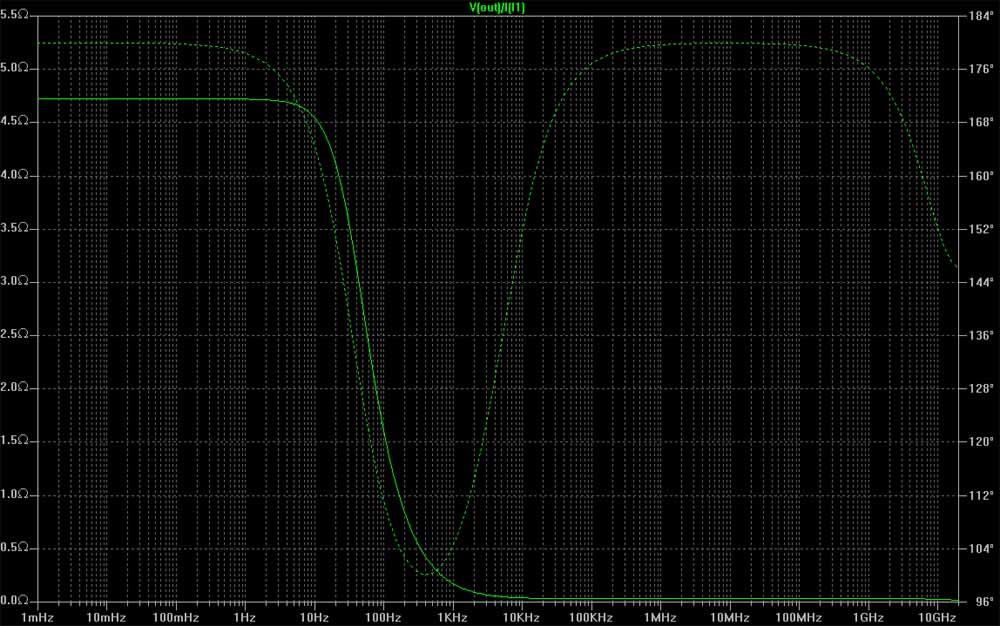

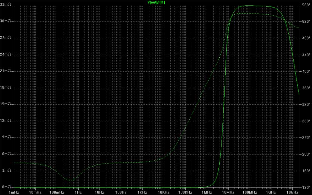

The sim indicates a output impedance of 2.8 mOhms at 1Mhz (12µthrough the audio band. Isn't that far to optimistic?

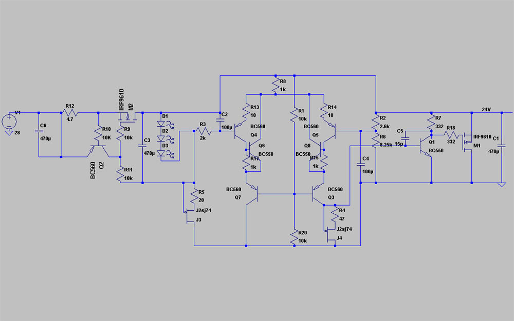

an open loop (= no feedback) design it is not.
Imagine a Zener fed Emitter Follower. It's open loop.
Your circuit monitors the output voltage across the resistor string and compares that to the fixed voltage across the LED string. It then adjusts the LTP output to control the severity of the shunt. Very much a closed loop feedback circuit.
Please post the latest schematic.

It surely has feedback, but I think it is *in a way* local. Since the input and the output voltage are the same in a shunt-reg (in respect to the error amp), you don't have the output devices working in both the load and the feedback path, only in the load.

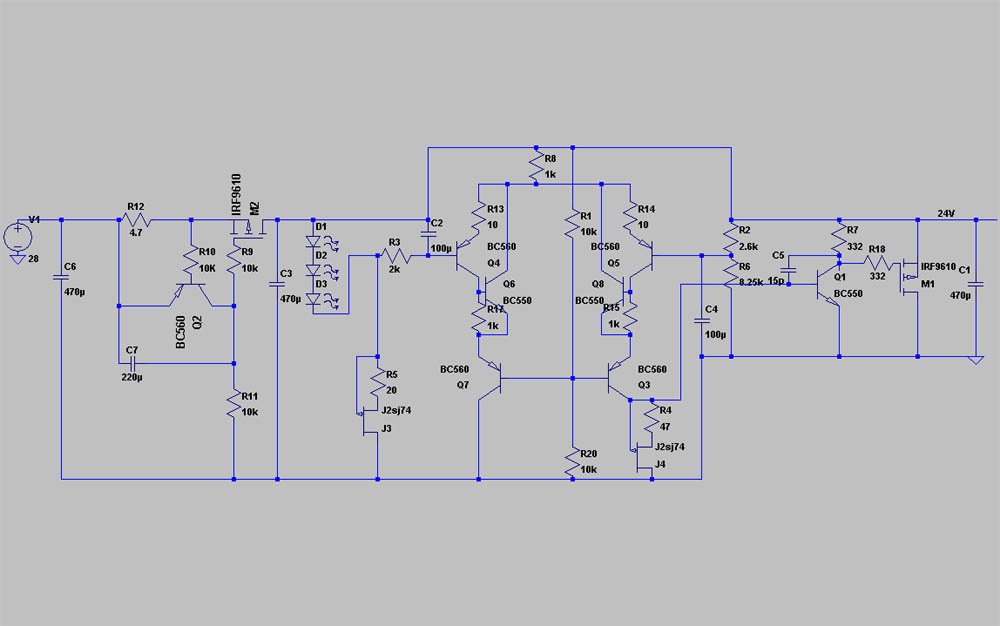

Here is the updated schematic. The cfp-input pair is meant to be an replacement for those now hard to get Toshiba FETs in respect to linearity. It additionally lowers output impedance as indicated above.
Please note, that for the moment I don't have a 2sc1775 so I used a BC550 as driver. That rises output impedance by a factor of 5 according to simulation.

Wrong! I updated the schematic, see below.

It is convenient to make R8 adjustable since there seems to be an optimum current share ratio between Q4/Q6 and Q5/Q8 in respect to regulation. It *seems* to be best to: Q4:Q6 = 1:2 -- 1:3 but I don't know why. (It regulates best in reality and has lowest output impedance in sim)

I remember now. But my cascodes are correct! Funny, I'm just fiddling with current mirrors as in your design at the very moment.
What's wrong in my schematic is that J4 does not get enough voltage to properly act as current source.
More flaws may of course still be present.
A question rel to your noro style shunt: You use css for the diff pair; in my sim, that really screws up Zout.
Rüdiger

As long as your master current source supply current for differential, voltage reference and at least current for shunt element=load current, your Zout will be ok.

I see your point...at least a bit. For a real cs (simple jfet with R) it's quite the same as with resistor alone.

Use Masao Noro style master current source (with M-fet if you like), size resistors around it accordingly (be sure to connect your present R11 to output, not to ground, use better voltage reference, not LED string (TL431 maybe, with J-Fet CCS and filter), your R12 should be parallel resistance of R2 + R6.
