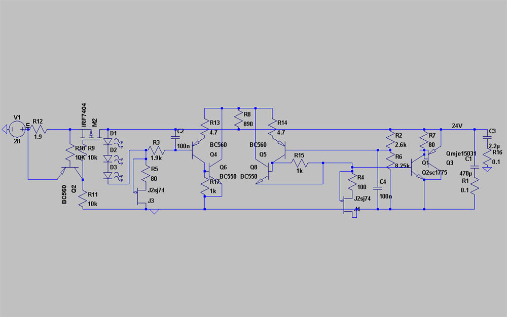

Here is a simple shunt regulator with good isolation and low noise. One of the design goals was to use things waiting in the parts bin for too long. Another was low parts count because I plan to use some of those in a phono pre.
Not shown are output/input caps.
There nothing too special about it except it works really well.
One thing I'd like to know is: How can I test/verify for output impedance?

By simulation: attach a 1A current source as load and sweep it over the frequency range of interest. The voltage measured at the output node is 1:1 equivalent to the output impedance.

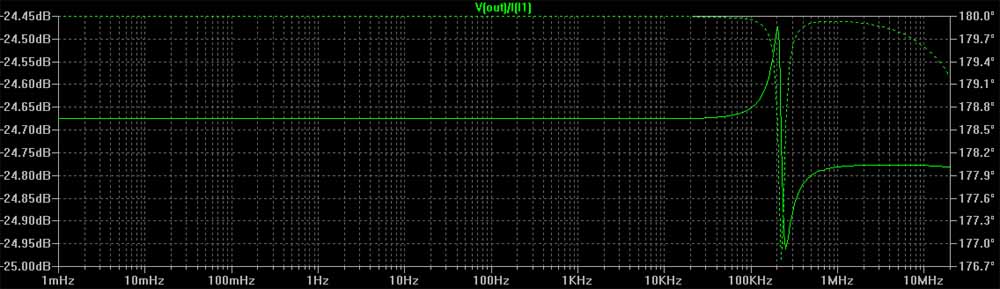

Since you are using LT SwCad do this: attach an 1A AC current source I1 at ouput, run AC analize, when card popoup, mark Vout, change Vout to Vout/I(I1) by presing Alt, OK, you will be able to see output impedance vs freq.
Place a cursor on the Y-axis, press left or right ( I can't remember right now), mark linear scale instead dB.
Impedance shuld be as low as posible and flat as well to 100kHz to 1Mhz region, after that you will see a rise up, play a little bit with a "real" capacitor at output (or without it).

How does this circuit work? Where is the voltage reference? If it's dependent to the transistor parameters, I don't think it will be very dependable.

I'll do my best:
Q2/M1 and R12 form the current source against the shunt reg will work.
The differential fet (2sj109) is the error amplifier. The leds are the voltage reference, held stiff by J3. A portion of the ouput voltage (both DC and AC) is compared to the voltage reference through R2/R6. I made part of R2 a trimpot, so I can vary between 20 - 26 Volts DC.
Q1/Q3 give further gain and provide current. The current through Q3 varies against load changes, so net current through R12 is always the same. In fact, you adjust the amount of the netcurrent through this resistor.
The point to see here is that Q3 shunts current to ground, the less is needed by the load, the more it eats.

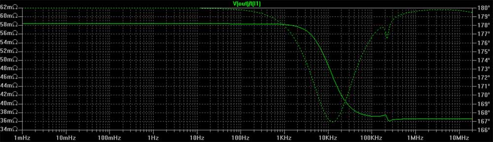

I replaced R7 with a 10mA current source (only in sim for the moment). The output impedance drops 'a bit': flat till 20kHz at 0.2mOhms, then rising at 60mOhms at 1MHz.
Sim indicates that replacing Q1 with a 2SC1775 almost halves those numbers.
I guess that extending the bandwith (e.g. falt to 1Mhz) is not that easy?

You should try to increase current thru CFP shunt transistor (as much as thru the load and more, if needed), size a CCS accordingly.

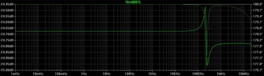

Placing 100n across R6 (and 0.1R in series for simulating (a really bad) series resistance) lowers Zout to 150µOhms in the audio band and 5mOhms at 1Mhz. I filtered the led's with 1.9k/100n as well.

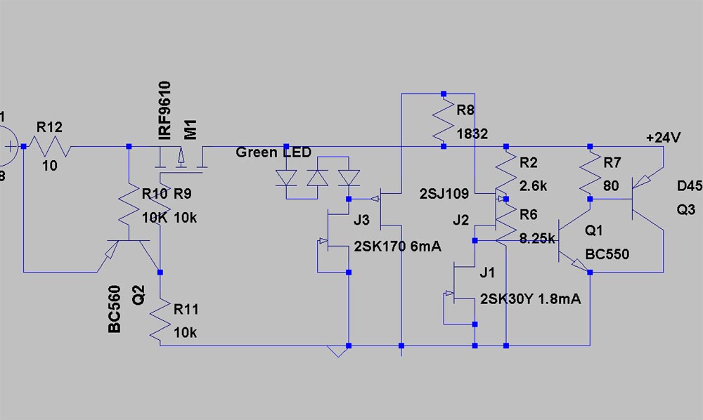

A different error amp (with cfp compound pair as well) simulates shocking 3µOhms in the audioband and 150u at Mhz. Not too bad for open loop...
This thing would be a pain to get stable, I fear.

Since no-one is asking, I post it anyway...
this circuit has not been build yet! I expect it to be very nasty to calm down possible oscillations!
It sims with 9uOhms in the audioband and 250uOhms at 1Mhz.
Noise sim is 2.4nV/Hz(1/2) from 10Hz-1MHz. Did someone ask if I think these are realistic numbers?
