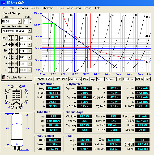

I did a search and did a lot of reading but cannot find the answer to some specific questions.
What components of the Simple SE circuit determine the grid voltage?
I am playing with SE Amp CAD and I understand the effect of of the cathode bias resistor (Rk) on the current (mA) but how do I know what value to enter for grid voltage (Vin)?
I have been using values from George's simulation tables, but I want to understand how those values were/are determined?
Is it a value that can be changed independantly/manually, or is it a result of a combination of B+, cathode resistance, etc.? Is it something I can calculate based on the other three values?

You don't say it but I assume you are interested in the DC conditions.
The grid voltage in itself is not of particular interest, what is important for the circuit is the Vgk, the voltage between grid and cathode as that determines the tube 'positioning'.
Since the grid is at gnd for DC, and the K is at (Ia*Rk), the grid voltage is simply the negative of the cathode voltage.
You get the negative grid voltage (referred to C!) by raising C with Rk and leaving G at DC gnd.

At the 12AT7 grid, the ac voltage is determined by the level of ac drive. The dc bias voltage is determined by the voltage developed across the cathode resistor, just change the sign. edit: this will usually be - 1.7 to -1.8 vdc ish.
At the power tube grid, the ac voltage is the amplified input voltage from the 12AT7. The dc bias voltage is determined by the voltage developed across the cathode resistor, just change the sign.

Technically speaking the output tube in an amplifier has both an AC voltage (the test sine wave, or the music signal) and a DC voltage applied to it. Both are required to control the flow of current through the tube.
These voltages are applied between the grid pin and the cathode pin of the tube. For most tubes the grid must have a negative voltage on it with respect to the cathode. The magnitude of this negative voltage will control how much current flows through the tube. A DC voltage of over -80 volts on the grid will cause all current to cease flowing through the tube. A voltage of near zero will cause maximum current flow through the tube. In an amp we adjust this idle voltage to get the desired idle current flow through the tube.
This DC voltage can be obtained two ways. The cathode can be connected to circuit ground, and a negative voltage can be applied to the grid of the tube, through a resistor, vacuum tube, mosfet, or transformer winding. The Tubelab TSE and TSE-II use this method.
The grid can be connected to ground through a resistor, or other path, and a positive voltage can be applied to the cathode, usually through a resistor in parallel with a bypass capacitor. The Tubelab SSE uses this method.
The DC grid voltage shown in your SE Amp Cad simulation shows a typical SSE type design with a 680 ohm cathode resistor. This puts 42.3 volts on the cathode and zero DC volts on the grid, resulting in an idle current of 63.2 mA and about 26 watts of tube dissipation at idle. Under IDEAL conditions with an IDEAL vacuum tube these conditions should not change from zero volume to the point of clipping.
Up to this point there is no signal applied to the amp, or the volume is turned all the way down.....and we are listening to nothing.
We can apply signal to this amp. This is an AC voltage that is fed to the grid along with the DC voltage. This is called Vin by SE Amp Cad.
If we applied a sine wave and just cracked the volume pot we might be putting 2 volts Peak to Peak into the grid of our tube. This will cause the grid of the tube to move up one volt to -41.3 volts on the positive peak of the sine wave, and move down one volt to -43.3 volts on the negative peak of the sine wave. This movement increases as we turn up the volume.
The 12AT7 as it is set up in the SSE will have a gain of about 45 to 50. This is enough gain to ram 50 volts into the EL34 when driven from a typical consumer device without requiring a preamp. It also has enough head room to deliver over 100 volts to that poor output tube when overdriven. This is done to minimize distortion in the 12AT7, since it is not operated anywhere it's maximum capabilities. So, how much signal does our amp need.
This is where the 38 volts comes from.
Your sim shows that when 40 volts is applied to the EL34 under the conditions chosen, you will get 13.1 watts of power (neglecting OPT losses) and be creating 8.3% of second harmonic distortion, and 0.3% of third harmonic distortion. If you were to run the same sim at less Vin you would see less power output, and less distortion.
I typically run several dozen sims at various combinations of DC voltages, cathode resistors, and load impedances to find out what works best for a given tube. To get an apples to apples comparison, you keep ALL of the conditions the same from sim to sim except for what you are looking at. For example I could try a different cathode resistor, but keep all other things the same.
I always start at a low Vin and keep increasing it until I reach a distortion threshold that I do not want to exceed. The sims I did during the development of the SSE probably used a figure of 5% total 2H and 3H. My guess is that you will probably get pretty close to 5% if you back your 40 volts down to 38.
15 years have passed since I did those sims. SE amp cad was a good tool in the day, but it relies on good vacuum tube curves like any simulator, and like most sims, gives optimistic distortion and power output numbers. Today, I use LT Spice, and set my max THD threshold at 3%. LT spice allows for simulation of the entire amp at once, not just a single triode only stage. It is also far more involved to use.
Linear Technology actually came into the plant where I worked many years ago to demonstrate LT spice. Myself and their tech guy spent a couple hours simulating the SSE amp design. I probably still have that sim on a hard drive somewhere. I think it used a 6L6GC since that was the only model that we could find.
If you were to start at 1 volt and run 40 sims at one volt intervals and plot the results, you would see a typical distortion curve with pretty low numbers up to a point where it takes off and climbs near vertically. This is the point where more drive into the amp gives no more power output, only more distortion, often called clipping.
Once we find the Vin needed to push the output tube into clipping, we have the data needed to figure out how much gain is needed in the driver (12AT7) stage. That's where TubeCad was used 15 years ago. A typical iPOD or cell phone puts out about 0.75 to 1 V peak. A gain of 45 to 50 is needed to turn this into 38 volts of drive. A good CD player puts out more than this, so a volume pot is usually all that's needed between the CD player and the SSE.
