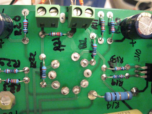

Would it be possible for you to post a picture of the components on your board that is good enough that we can read the resistor colors. I tried again to check the components in your previous picture but the colors aren't clear. If you have a picture that is clear enough, but too big to post, email it to me. A picture of your input wiring may be a good idea too.

I took a careful look at the photo of skippers board and don't believe that is the case here, but that is the reason that I asked for a clearer picture.

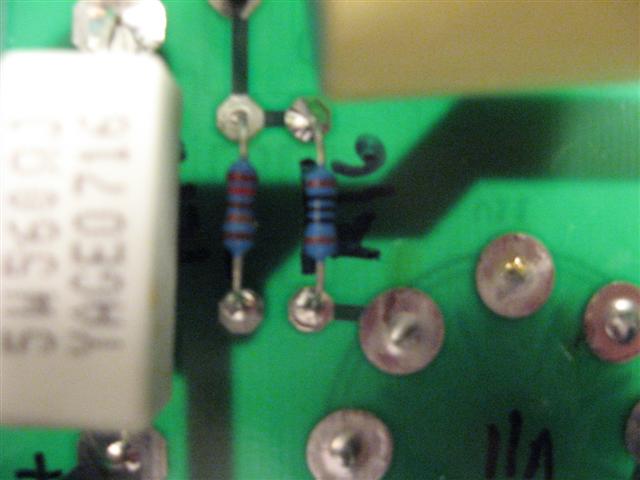

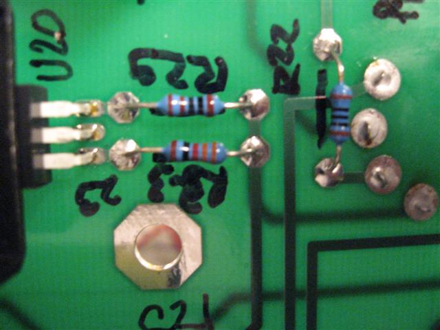

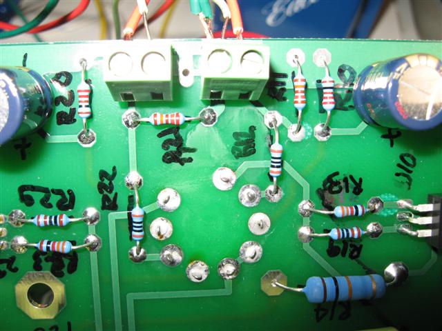

Hi All,
I measured R16 and R26 on the board and read 100 ohms. I measured R15 and R25 and read 220 K ohms. When I was soldering them on the board I had also measured them first and wrote down the right numbers. I am attaching several pictures on my components. Sorry about the bad quality but my camera is not very good. Let me know if you want to see something specific and I can take more.
