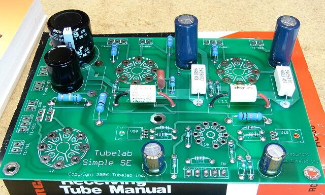

I got my Auricaps coupling caps but have a question. The caps are not labled with a +/-. From the board, C11 and C21 show a longer leg on the silk screen. I assumed that this was the positive side (like the longer leg of the radial legged caps). From the attached pictue, both caps have oppisite wire coloring to each other. Can I assume that if I install the caps where the lettering is upside down to the board that the polarity will be correct?

All film/foil caps have no polarity, so you can connect them either way. If you visualize that the cap is built like a jelly-roll (it's a strip of mylar and a strip of foil laid on top of each other and rolled up), one lead is connected to the foil on the OD (outside dia) and the other lead is connected to the foil on the ID (inside dia). Some folks like to wire the foil OD side to the input (I think) for sonic reasons but I cannot notice any difference either way. They'll work just fine in either polarity.
If you buy boutique caps from Michael Percy, he puts a dot on the foil side before shipping them out. I typically wire them with the text facing the same direction for both caps (or all 4 for a PP amp), that way the foil ODs are all connected the same way (hopefully). That assumes that the text on the caps is always put on in the same orientation. I can just visualize caps shooting out of the cap-making machine into a big hopper and then going to the printing station in the factory.:clown:

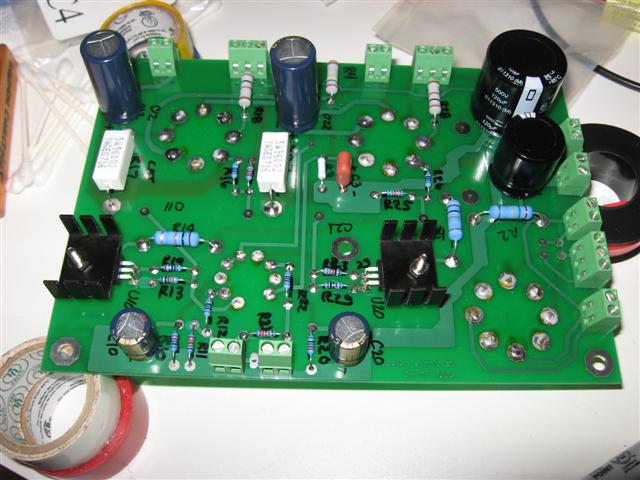

Here are a couple of pictures of my board. I still have to add the coupling caps. I plan on running it on a test bench. The inputs and spreaker jacks, where should I run the ground to these for the bench test? Do I just run them to the ground on the power connector?

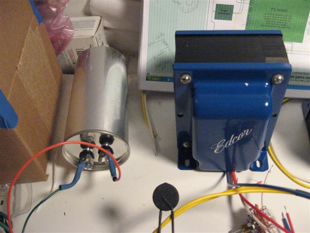

Also, I got the currently limiters from mouser, so these should come off the fuse and to the power transformer?

Put one on the primary side and put another in series with the center tap of the high voltage winding. The first one will heat up right away as the heaters come up due to their large current draw. The second is there to limit current when the rectifier comes up to temp. It takes a long time for the 5AR4 to come up, but once it starts it comes up fast. Those big caps draw a lot of current even before the rectifier is up to full temp and that's hard on the tube.

Another question, tonight I completed all the soldering on the board. I double checked the resistors as a sanity check. Everything checked out except R2 150K 3W and R4 150K 2W. The both seem to measure in the M Ohms and the values change,, they are not stable. I even put clips on the resistors to get a good reading. Is there a reason these are reading funning (.421 M ohm ) or are they just bad?

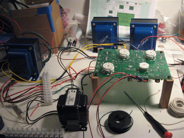

Hey guys,
I am almost done with wiring up my bench top set up. I still have to connect up the OPT and add the tubes and I think I am done.

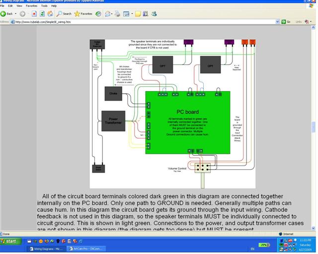

Should I ground the OPT and the PWRT cover to the inlet power conector ground (center pin) for the bench test?
Anything I should check before powering up? I added a current limiter to the high power CT and to the out let of the 2.5A slo-blo fuse.
Here are a couple of pictures of what I have so far.
I generally put a clip lead on each transformer/choke to earth ground, just in case. Don't forget to ground the OPT commons if they aren't already going back to the PCB for CFB as well as earth grounding some point on the PCB (George's instructions cover this).
