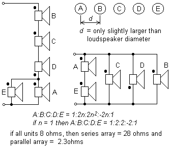

Bessel functions have wide ranging applications for wave direction…..microwaves, directional antenna, radiology, etc…technology far beyond the commercial/home audio industry. There’s no construction details…….close spacing of the drivers where C to C spacing is less than or equal to the point at which the driver begins to beam is all that is required.I really do not want to poo poo the Bessel Array but I just do not understand how it does not result in comb filtering, etc.
If I have five speakers lined up horizontally, driver D is out of phase, all others in phase.
For a left right combination I assume one would reverse the order of drivers for the other channel?
I just noticed the issue of ohm load; If using 4ohm drivers the load would be 14ohm or 1.6ohm - correct me if I am wrong but could that not be an issue?

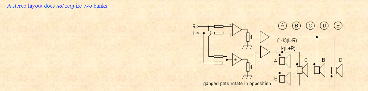

Not sure where the whole ‘stereo’ thing came into it….I don’t think you raised the point….each 5 element array would be for a single channel of signal………for an LCR soundbar, three 5 element arrays comprise.
I guess the thing to do if you might want a center channel later is to build it with three channels to begin with, that will save a lot of screwing around later.
So either 15 drivers in three chambers, or three drivers in the same. Figure out what 15 of what size drivers will sit nicely in 57" if you want to do the bessels, and that will get you a start on drivers. Mayhem13 sounds like they know what would be good too.

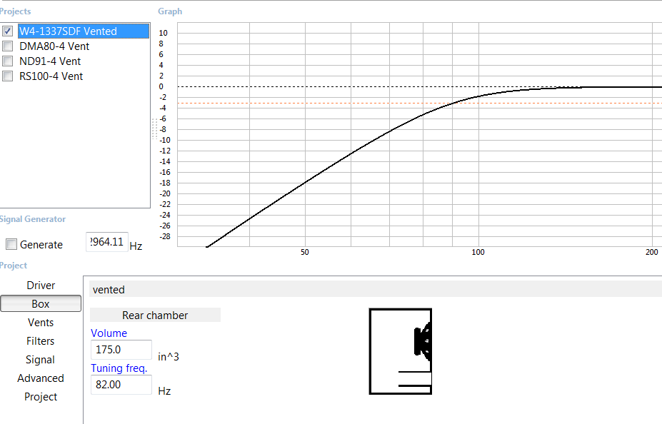

This is what I have so far have tried pretty much every 3"-5" full range driver on Parts Express with a response about 17k.
Tang Band W4-1337 seems to be about perfect but costly.

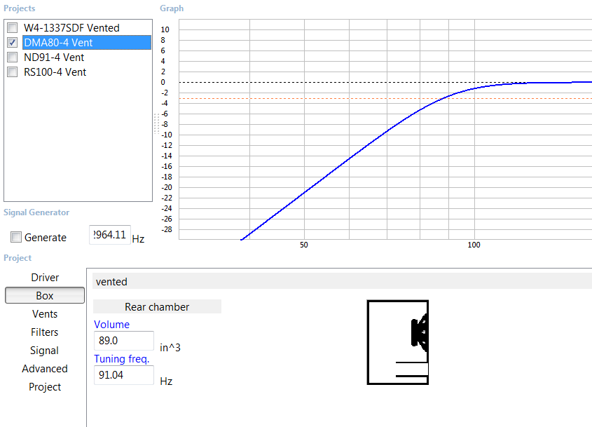

Dayton Audio DMA80-4 is also very good.

Feel free to tell me how I misused WinISD.
I've only ever used it for one other project, a pair of sealed 12" subs.
I know it appears I am turning my back on the Bessel Array - I did model the PC83-4 and 8 and the math/graphs do not seem to work in their favor; cabinet volume, response, etc.
If you can show me where I went wrong with those two drivers I would consider buying 5 to play with.
Tang Band W4-1337sdf

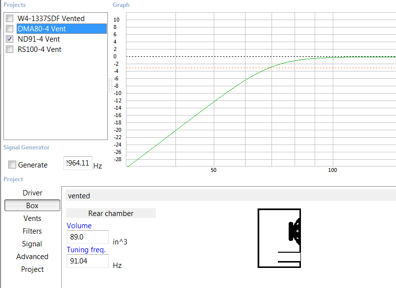

Dayton Audio ND91-4

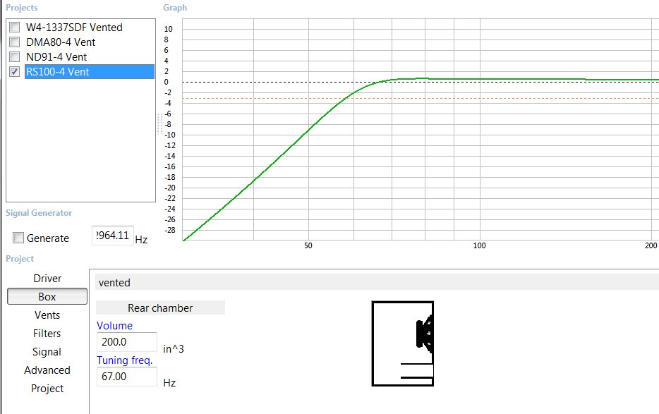

Dayton Audio RS100-4
- $79.98
- Spec. 70-20k
- Box 175 Cu.In
- Tuning 82hz
- Port 4" x 5/8" x 8.55"
- -3db 90hz
- Max SPL 100.5db
- $18.98
- Response 90-20k
- Box 89 Cu.In.
- Tuning 91hz
- Port 4" x 7/16" x 9.9"
- -3db 87hz
- Max SPL 96.5db
Dayton Audio ND91-4
- $26.98
- Response 65-17k
- Box 89 Cu.In
- Tuning 71hz
- Port 4" x 5/8" x 24.54"
- -3db 70hz
- Max SPL 97.5db
- $37.98
- Response 80-20k
- Box 200 Cu.In
- Tuning 67hz
- 4" x 3/4" x 14"
- -3db 59hz
- Max SPL 95.5db
