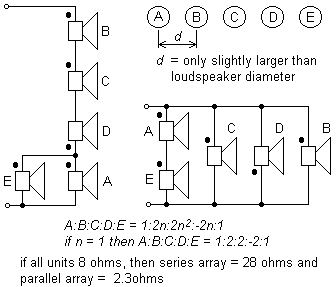

I’ve been working on this solution for a while now and have been prototyping my design over the past couple of weeks for just a center channel with good off axis response.
Small drivers behave much like extended range tweeters and produce the needed off axis response. Problem is still their range is limited and they don’t handle much power. The solution is multiple drivers but in a typical array arrangement, their off axis response is terrible. The answer to that is Bessel Array wiring where 5 identical drivers are used and wired in such a way that their combined response is the same as a single driver…….and it works.
Three groups of 5 of these wired in a Bessel series array will do exactly what you need in a compact, thin LCR
https://www.parts-express.com/Dayton-Audio-PC83-4-3-Full-Range-Poly-Cone-Driver-295-154?quantity=1
Port tune each group to 100hz as your spec calls for. Each array with 5 drivers will now handle the low end load without issue. Keep the baffle close to the screen and use the screen surface as boundary gain/extended baffle……you won’t need to add a baffle step compensation network.
For $165 US dollars, you’ll create a sleek, great sounding LCR with excellent coverage and off axis response.
Here’s a link to Bessel function and wiring recreated from Floyd Toole’s work
https://www.angelfire.com/sd/paulkemble/soundf.html
Good luck! I’m extremely encouraged with my center channel prototype that I’m working on. My design is intended for high output use and differs in that it’s a two way and uses 2 shallow mount 6” sub drivers to handle to low end and crosses over to the array at 400hz. It can easily hit 105db with no power compression or distortion to 55hz.

While I truly appreciate your suggestion I think this is way more effort that I am willing to put into watching television. Maybe its not as complex as it sounds? I also though comb filtering was an issue with arrays? <-- likely I am ill-informed or just dumb.
Reactions: mayhem13
A Bessel array doesn't behave like a line array......it uses either 5, 7 or 9 drivers only but it is preferred to only use the 5 driver array for audio. The drivers are wired in an arrangement where 2 are out of phase which creates the point source polar pattern of a single driver. The advantage is power handling with 3.5x the power handling of a single driver.
A brief explanation and wiring can be found here https://www.angelfire.com/sd/paulkemble/soundf.html
A detailed use explanation and measurements can be found here https://pearl-hifi.com/06_Lit_Archi...ns/Effective_Performance_of_Bessel_Arrays.pdf
It's not complicated at all and requires no crossover components. The driver i suggested has the needed response pass nband for your application and because it's so small, has a polar pattern much like a 1.25 inch dome tweeter. 3 groups of 5 would fit your application for 65" with three sealed chambers of .2 cuft each which should give you an F3 around 110hz so a perfect match for a subwoofer crossover at 100hz.

I really do not want to poo poo the Bessel Array but I just do not understand how it does not result in comb filtering, etc.
If I have five speakers lined up horizontally, driver D is out of phase, all others in phase.
For a left right combination I assume one would reverse the order of drivers for the other channel?
I just noticed the issue of ohm load; If using 4ohm drivers the load would be 14ohm or 1.6ohm - correct me if I am wrong but could that not be an issue?
I did some google foo and found bits of info here and there on Bessel Arrays but the few links I followed did not dumb things down enough for my Neanderthal brain.
I searched youtube and found several lectures on bessel function. The ones I sampled did not seem audio related. Maybe the search algorithms are against me?
Maybe I just need to see the details of construction and some measured results?
Also I'm trying to understand the schematic for the stereo wiring, (A stereo layout does not require two banks.) It says ganged pots rotate in opposition? Can this be omitted? Where is the other speaker lead connected to the amps?
Maybe it would be better using 10 drivers with one set of 5 for each channel?
What you could do is build it with 5 drivers, each with external speaker connections. Then just use two drivers for stereo for now, and if you need to convert it to a mono center channel bessel array in the future you can just rewire it up that way. The drivers would each have to have their own chamber, might be hard to keep them close together.
edit: actually no, only the drivers intended for stereo need their own chambers, much simpler!
That stereo wiring diagram makes me motion sick.
Honestly, I just assumed two banks of 5 would be required for stereo and 3 banks of 5 for LCR setup.
