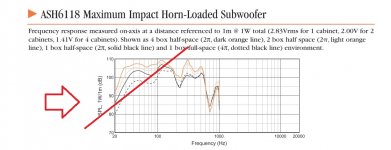

A JBL 2242H (18") and, lo and behold in a horn loaded sub (JBL ASH-6118WH Horn-Loaded Subwoofer). (pic)SIMPLE QUESTION: Can a 10" woofer give me the same bass of a 15" one?
This picture from JBL (1x driver in 2 Pi space) showing ~85dB's is very similar in SPL to the simulation of the 10" woofer I presented in post #37 (from the point of view of the lower frequency roll-of). So where is the difference? The difference is in the upper frequencies and sometimes max. power between different drivers, nothing else.

If you want to make more comparisons you can pick the Eminence Lab12 used in the most/best SUBS in the world (like the 12π Basshorn Subwoofer by Pi Speakers) and it's only 89.2 (Sensitivity) from the spec sheet (and in a simulation was calculated as a 85.7 dB/2.83V/m for 2 Pi space/loudspeaker or 89.9 dB/2.83V/m for 2 Pi space in a baffle/"free field") or for that matter with my recent post for a ~140 L (BR) enclosure of the Stereo Integrity HT 15" Subwoofer here.
And after all this is very similar to the picture presented here by tinitus in post #50.
