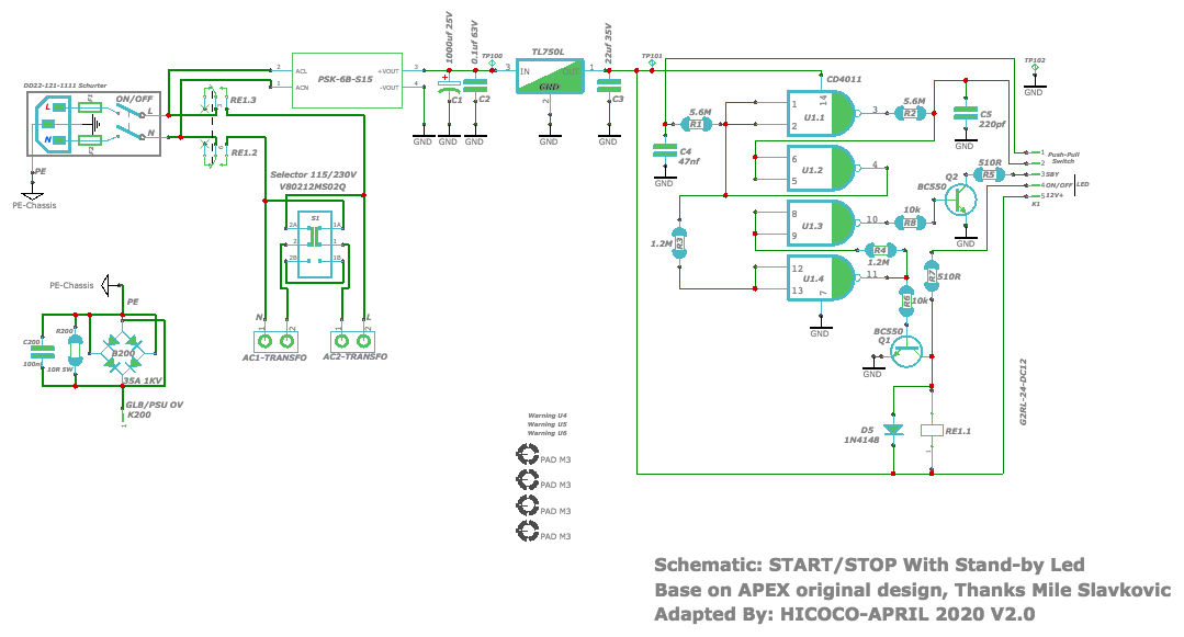

Hello,
Has anyone seen a simple on/off relay circuit for an SMPS without soft start?
I would like to have a low voltage Anti Vandal type momentary type switch that when pushed in for a few seconds lights up and turns the amp on and then when pushed again for a few seconds goes off and turns the amp off.
Anyone seen such a circuit?
Preferably a board I can just buy.
Looking around the webs, I didn't find anything suitable.
Thank you,
David.
Joined 2018
