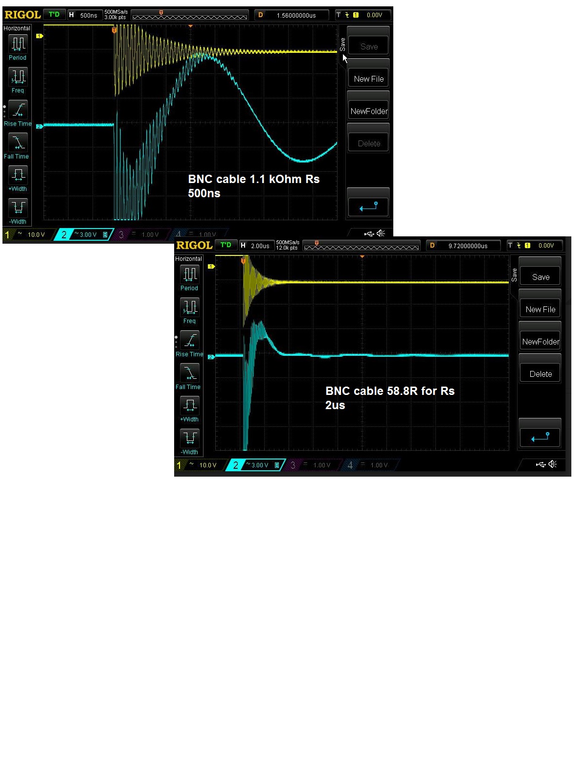

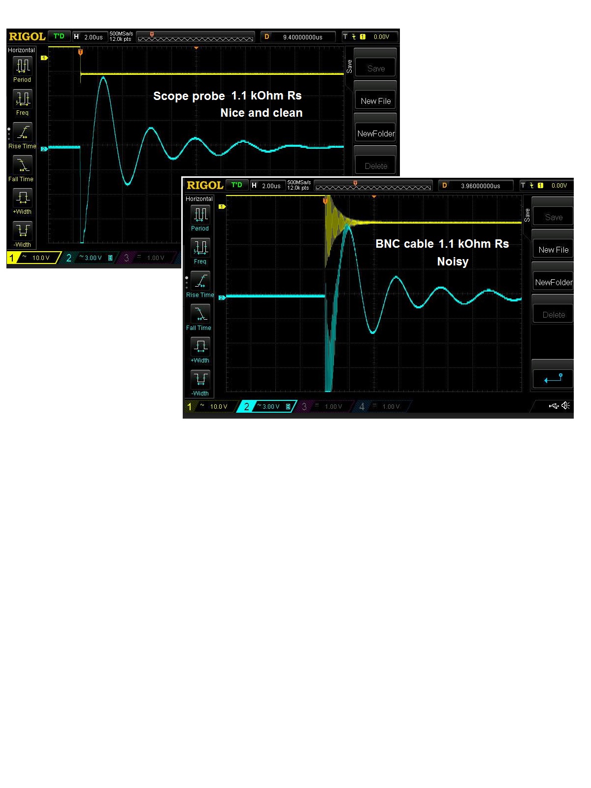

Hi Mark and all,
Need your advice and it might be off the subject but related to Quasimodo. I boxed it long time ago and used scope probes with no issues. Started to use BNC to BNC cable and I see signal reflection on scope. Any advice how to defeat that efficiently? Thank you.
Hi Mark, I probably confused you with my question.
I have varies probes and no issue with them at all. They all works with Quasimodo perfectly fine.
Question is for cable with BNC to BNC connectors. I installed Quasimodo into box with BNC outputs for CH1 and CH2. Probably Scope Probes use active impedance matching and my BNC cables are 50 Ohm steady.
Two things I would check:
Is the cable terminated into the right impedance?
Are the connectors niece and snug and making good electrical connection?
Hope that's at least a start. Good luck
Phil
-edit - I think you have it, Alex, with impedance matching. Terminate the cables into 50 ohms.

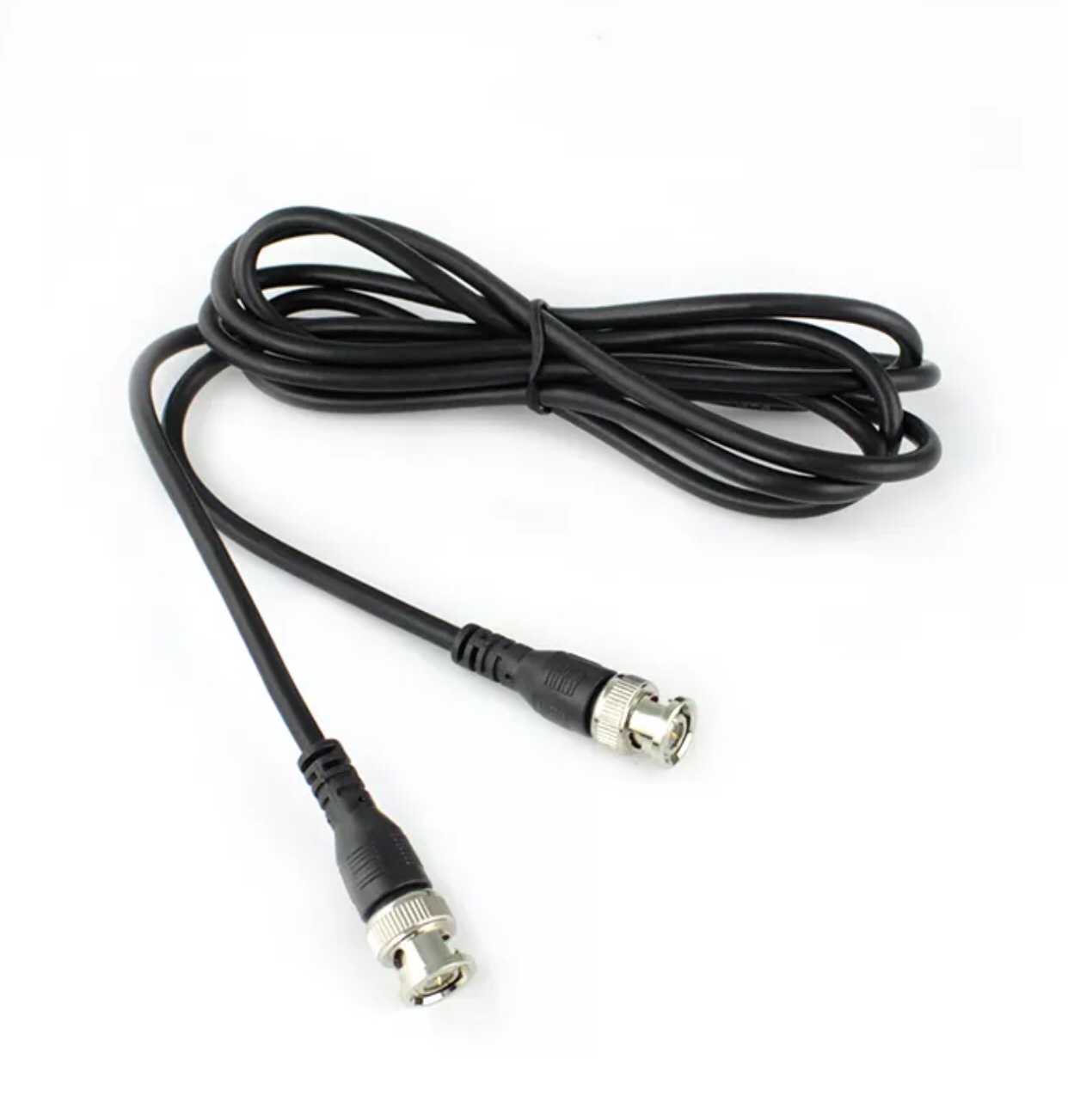

Hi Phil,
I use both ends industrially made BNC RG58 coax. It is 50 ohm impedance and 2 m in length
You measured 50R between the center pin and shield on that disconnected BNC interconnect?
BK
No. What is the point to measure that? 50 Ohm is impedance, not resistance. RG58 coax is 50 Ohm impedance by spec.
Point is depending your scope/settings you might need to terminate the connection with a feed through connector, etc.
BK
BK
BK
It is infinitely.
Do you have the scope set to 50ohms? Most of them will default to 1Mohms.
(They also have a much lower max input voltage at the 50ohm setting. Depending on the transformer you're measuring, you may need to leave it on the 1Mohm setting and put a 1Mohm resistor in series with the cable.)

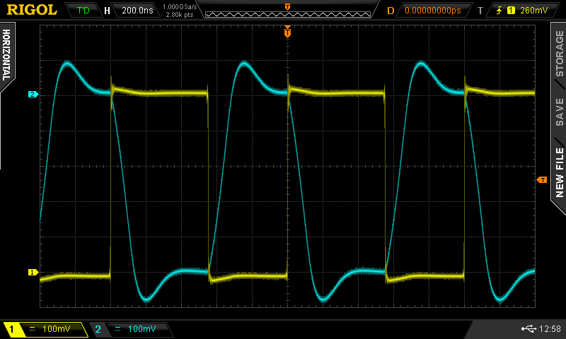

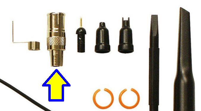

I purchased object #1 from post_1271. It includes a little bag of add-on goodies. One of them is an adapter which lets you plug the scope probe straight into a BNC male socket. It makes solid connection to both the tip needle and the ground collar. See figure_1 below.
I used that adapter on a BNC male, to make the measurement shown in figure_2 below. (It's an opamp not a Quasimodo!) Notice that the horizontal scale is 200 nsec/div --- considerably faster than the 500 nsec/div rate in the pictures of misbehaving traces in post 1270 above.
