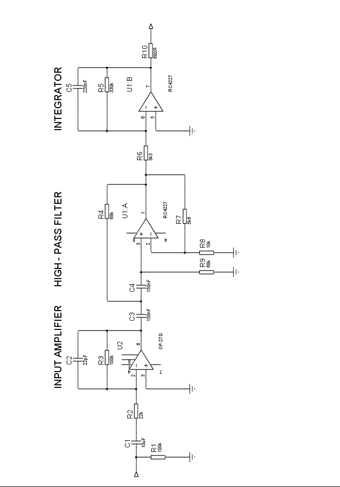

Here's the integrator and input sections.
Er....That's it.

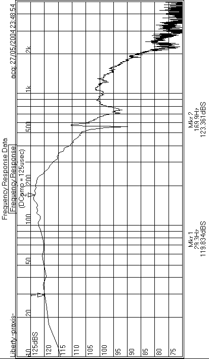

Measurements at last
My Praxis system is working now, except distortion for some strange reason, so here are some measurements of the system.
I was surprised at how accurate my original measurements were, considering the equipment I had at the time.

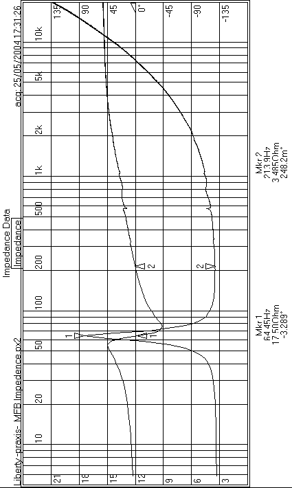

I built a stereo pair, the resonant frequency of one is 61Hz, and the other is 64Hz.
I modelled the drive units is WinISD to see what they would be like un-aided. The resonant frequency in the 45l box (each unit has 22.5l) would be 64Hz, with a Q of 0.617. WinISD recommends a reflex enclosure for them.
Here's the TS parameters, only one coil on each unit used.

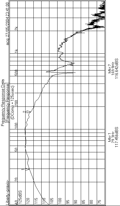

More....
I want to show the effect of changing the ammount of current feedback. Rather than change the value of the current sensing resistor, R8 in the diagram of post#41, I changed the value of R2 to 11K, and inserted a 47K preset pot so that the value could be "tuned".
This is with R2=11k, too much current feedback.

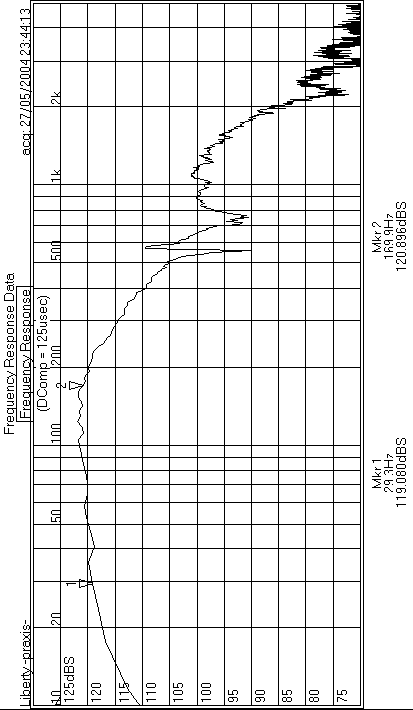

more & more
The shape of the curves is the important thing. The gain changes as you would expect. Praxis thinks it's a normal speaker, and calculates it's sensitivity from sound out/volts in. In this case, I'm using the input to the system as the reference for the volts in.
The following is a bit of a surprise. In the equations, if Rs=Re then the B terms cancel, so I thought it would be the response without feedback, But when I replaced R8 (current sense or Rs) with a 3R3 resistor, I got this.....
last for now...
The peak in the last one was at Fs. Curious. Any ideas?
When I "tuned" the pot to give the flattest response, guess what? I got 22k!
So I think that maybe the errors due to inductances cancel or something. It shows that this technique works🙂
You will have noticed a slow downward trend towards the lower frequencies of about -3dB/octave. Dunno what that is. It isn't a measurement artefact, because I noticed it with the first plots made with sig gen and scope and electret insert mic. It's not the room either (different rooms) Leaky integrator? Dunno. Any ideas?
Ok let me know what you think.
I'll post distortion measurements when I sort the problem out. The residual distortion is <0.003% above 45Hz, but rises below that to 28% @ 10Hz, this would cloud any subwoofer measurements, so they'll have to wait for now.

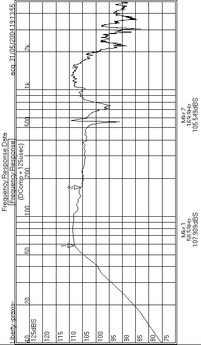

It's The Integrator!
Of course, when the feedback cancels in the case when Rs=Re, the output is no longer proportional to velocity. The integrator skews he shape of the curve.
Below is a plot of the system without the integrator, with R8=3R3. A much more familiar result.🙂
