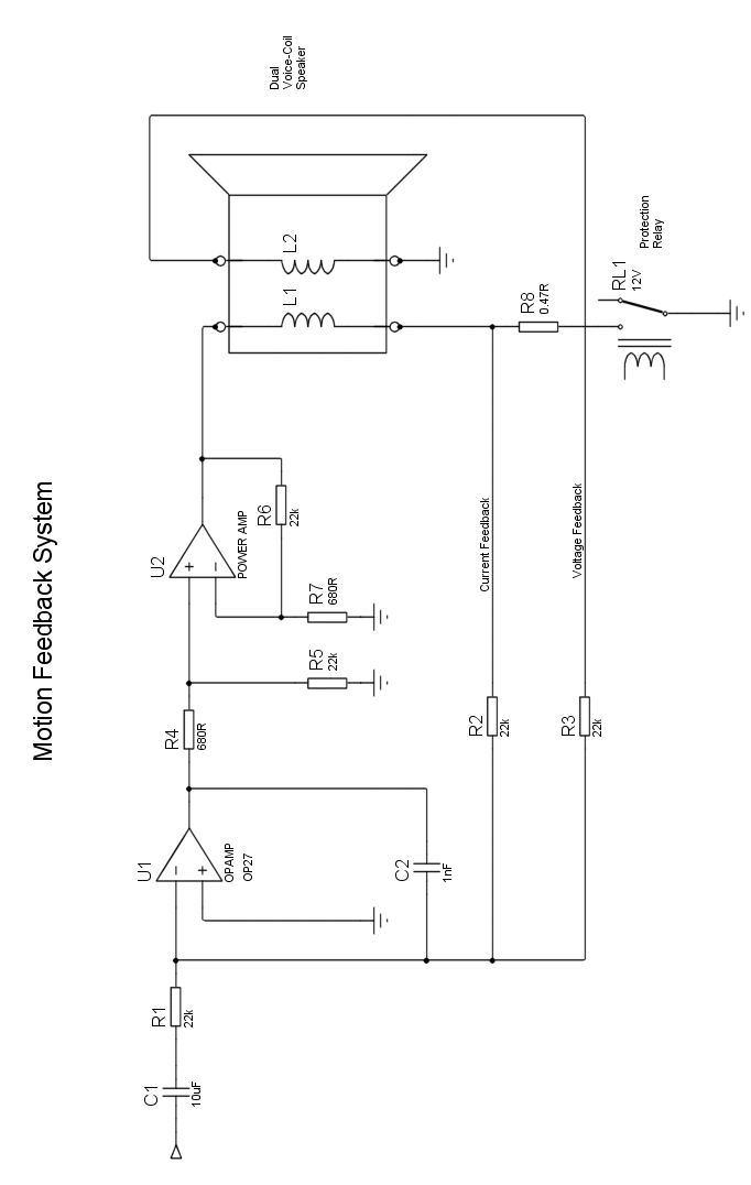

The expression for the complete system is;-
Gain = 1/(Rs/Re - B Rs/Re + B )
If Rs = 0, then Gain = 1/B as before
If Rs = Re, then gain = 1,
The current feedbackand voltage feedback cancel because their effects are opposing. Current feedback damps the series resonant circuit by effectively increasing the series resistance, while voltage feedback damps the parallel resonant circuit by effectively reducing the parallel resistance. So the response is as though there is no feedback at all.
These results show that the expression is correct.
A flat response is obtained if the gain at Fs is the same as the gain at Fm. So the question is, what value of Rs in the above expression fould give the same gain for the measured values ofB at Fs and Fm?
In my system it came out at 0.43 ohms, I used 0.47.
Having measured it with what little equipment I had at the time, I think that the errors and assumptions err on the side of too much current feedback. but it's not far off, considering. My system has been in use for 5 years.
BTW, this is only part of the system, you need an integrator to give an output proportional to acceleration. If the input is double integrated you get an output proportional to excursion, I thought of using that to trigger the protection relay but never got round to it.
The idea was to get a computer and CAD stuff to make more accurate measurements, but in the past few years I've got bogged down with computers and neglected the audio. So thanks for the inspiration to work at a subject I love.
Hope all this makes sense, any questions?
Re is voice coil resistance
Rs is R8 in the diagram

May I jump in here. I might have missed something earlier in the thread, but what are the general thoughts when using a second voice coil for feedback? Is it that it somehow measures the cone velocity, and that the feedback loop would correct the input to the speaker such that the output (presumably proportional in some way to the cone velocity) closer to the audio signal?
If so, how is the mutual inductance between the two windings accounted for? I mean, even if the cone is forced to stand still, there will still come a signal back from the second winding, the system will act as a transformer.
Or did I miss something?
Mutual Inductance
Yes the mutual inductance between both coils is an error term.
I would like to find a way to either cancel it out, or to include a term in the gain expression to account for it. When I get my new measuring system maybe I could find a way to do both, but I couldn't do it when I was designing the system.
The questions are, how big is the error? how does it affect the results?
To find out, I built it. The error is frequency dependant, as you would expect, and affects the feedback at Fm much more than at Fs.
Even so, the system works. As I said previously, the errors result in a bit too much current feedback, when calculated as shown previously.

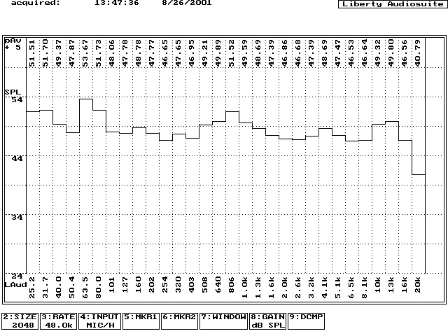

Have you measured your system acoustically? If so, it would be interesting to see the graphs. If not, may I suggest a measurement with the microphone *inside* the box. The resulting curve will be tilted by -12dB/octave, but a double differentiator will fix this. I could point you to some software that does this too if you want.
I have a 3rd octave RTA graph of the sub together with my cheap satellite speakers. I have a LAUD measuring system, but had problems with the computer. It uses an ISA sound-card by Turtle Beach, and is good, but I've had no luck getting the computer working. I had so many audio projects on at the time, I didn't take many of the MFB sub. I've just ordered Praxis by the same company, Liberty Instruments, which should be less dependant on the computer. So watch this space!😀

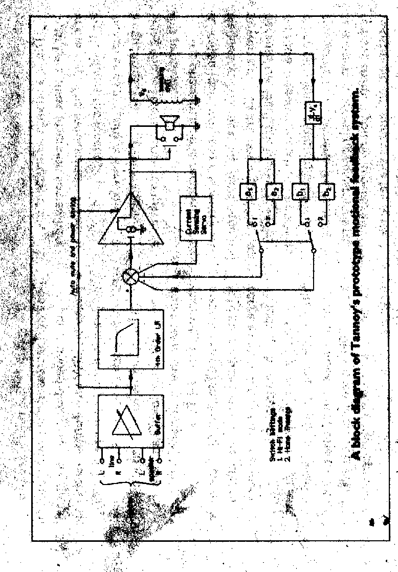

Tannoy had a commercial model using the principles we are discussing here, the ALF625. It was while reading a review of this in Hi - Fi World sometime in 1994 that I was inspired to try doing something similar. Later that year, the ALFie 625 was reviewed in What Hi - Fi? who described it as "slow" 😕
They also ridiculed the acronym, "Advanced Low Frequency improved electronics", saying; "More Arnie and less Alfie would be better". Maybe such a review in the popular hi - fi press can stifle a product in the marketplace, I think it ceased production in 1996.
In their system they differentiate the voltage feedback which is, I think, what you are suggesting, this would give a flat response by itself. They too use current feedback to raise the output impedence of the amplifier, so maybe the current feedback provides sufficient stability to allow such a thing.
Here's a block diagram of their system, hope it's readable🙂
System RTA
Here's a 3rd octave RTA response of the system. The bass is my MFB system, the rest is some small speakers I made. I was trying out an active crossover I bought, intended for in - car use, but it was after I was burgled and lost my 4 channel amp with active crossovers, so I just needed something quick. The LAUD system allowed me to average several mic positions, but I don't think it eliminated room nodes. I remember setting the mic in position for a near - field measurement of the subs but I cann't remember what happened.:xeye:
