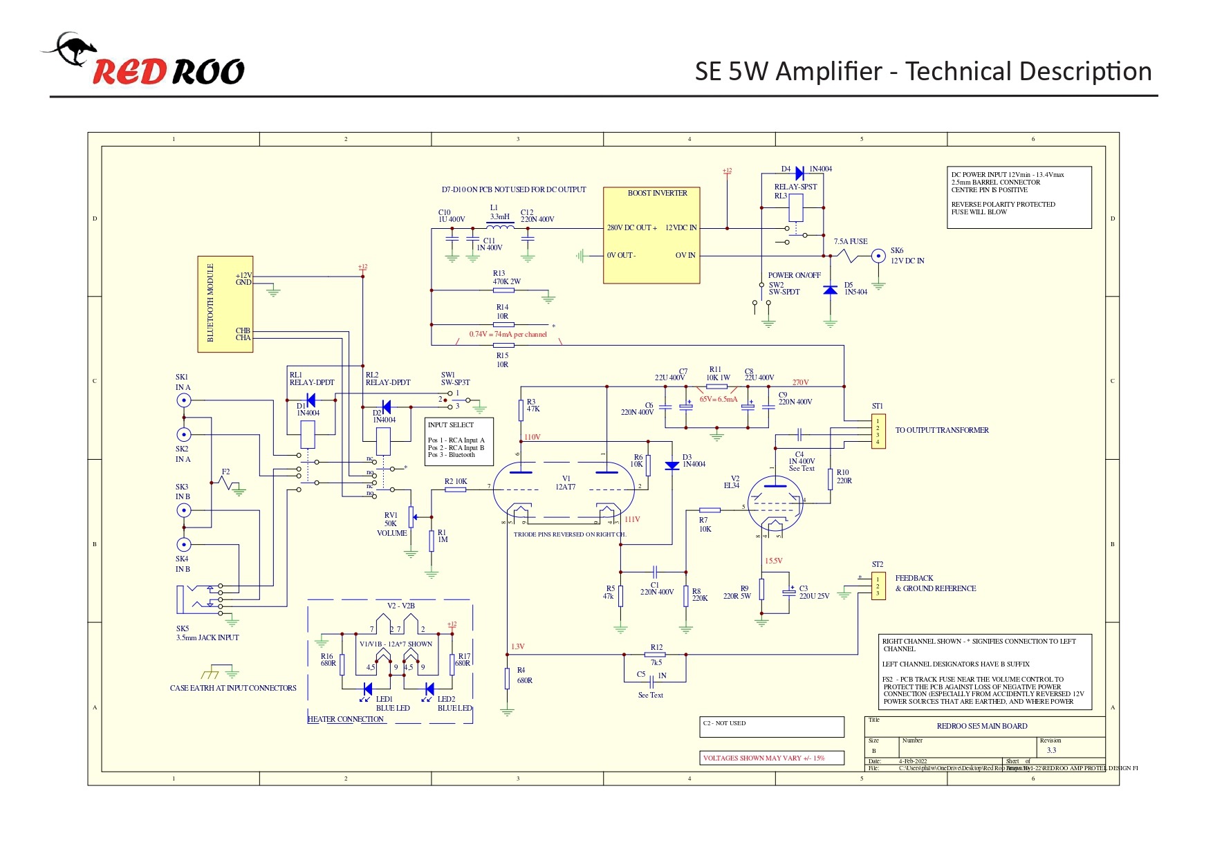

The circuit is included in the attached PDF - it's a large schematic so might be easier to read on PC/tablet than a phone.

@6A3sUMMER we were just writing at the same time, schematic is now attached above.

lordearl,
I was still editing my Post # 24 when you posted the schematic.
I needed that schematic in Post # 1.
I very much like the amplifier you picked to build.
Looks like a well designed circuit, and looks beautiful too.
But . . .
That amplifier does not go into A2, unless you want to have large bias shifts on the EL34 output tube.
The Cathode Follower drives an RC coupling to the grid, g1 of the EL34 (That causes bias shift the moment you draw grid current).
And bias shift might not be so bad in a transient moment, except for the time it takes for the bias shift to go away as the music quiets down.
It takes about 48 milliseconds to get rid of 63% of the bias shift voltage.
Given no global negative feedback; no output tube cathode negative feedback; and no Schade negative feedback; then . . .
An EL34 in pentode mode has the highes power, highest distortion, and Lowest damping factor.
An EL34 in Triode Wired mode has the lowest power, lowest distortion, and highest damping factor.
And for an EL34 in Ultra Linear mode has medium power, medium distortion, and medium damping factor.
(All relative).

Thanks @6A3sUMMER, agree, it's an excellent design - will report back on the sound.
The designer seems confident it goes into Class A2 so I will check with him.
I'm building it in Triode Mode, hence the queries around sensitivity and the most appropriate valve for the input stage. 👍

petertub,
Probably the greatest low pass filtering effect in that amplifier is the 1 nanoFarad cap, C4, from the Screen to the Plate (Plate to UL Tap).
I wonder how much ringing that 1 nanoFarad cap causes with [60% ?] of the primary winding.
And there is the capacitor, C5, across the negative feedback resistor.
If I got the capacitor numbers wrong, correct my bad eyes.
The low frequency rolloff response causes I see are:
The RC coupling from cathode follower to output tube grid g1
The capacitor that is across the self bias resistor in the output stage
The output transformer's primary inductance
I do not think that the 50K volume control and grid stopper resistor interacting with the input tube's miller effect capacitance do much filtering below LF radio frequencies.
And I do not think the grid stopper on the output tube and its miller effect capacitance has much effect below LF radio frequencies.
Sorry that I can not read the resistance and capacitance values on the schematic.
Sorry that my analysis powers are quickly degrading with my mini-strokes.
That is all I saw on schematic in Post # 28.

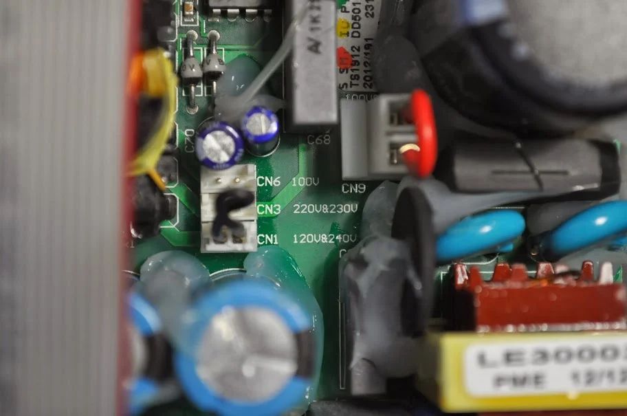

None of my boards nearby ("Sunday" 😉 ) but a couple Net pictures:Thanks @JMFahey this looks like a good approach. Any chance you can show a few photos of these in action on a board as I can't quite picture how the system works. Thx in advance!
Imagine you build a singe triode stage, want to select:
- plate resistors 47k or 100k
- Cathode resistors 1k5 or 820 ohm
- Cathode capacitors: 10uF / .68uF / none
plenty options for tube rolling, huh? 😉
Call pins 1 - 2 - 3 left to right
* For plates: put 2 resistors side by side; join 1 end which goes to tube plate.
Free ends go to pins 1 and 3 ; pin 2 goes to supply (say +200V)
Now you can choose either 47k (1 - 2) or 100k (2 -3)
* For cathode resistors: resistor junction goes to ground, 1k5 to pin 1, 820 ohm to pin 3, pin 2 to tube cathode, connect what you want.
* for cathode capacitors: same thing:
10uF to pin 1, .68uF to pin 3, pin 2 to cathode.
I can choose either cap or none at all , by not putting the jumper.
Way more flexible that switches ... did I say Cheap? 😉
Strong enough for 200V or more, and significant current, one such jumper system is used in PC suppies switching between 120V and 240V Mains, go figure
The jumper mentioned here is same size and type as shown above 😱 :
Mark Bass amplifier uses 2 jumpers and 3 pin pairs (CN1 CN3 CN6) to select 100V Japan, 120V/220V/240V US/Europe mains.
These little beasts are versatile and strong.
Again: cheap!!!
Meaning you can use as many as you wish in your boards.
