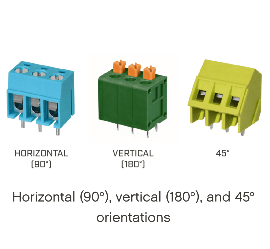

What about something like this?

Yes that could work - you mean bend the resistor leads at right angles and put them into the 2 way terminal block?
This approach might even work using a vertical style of terminal block:

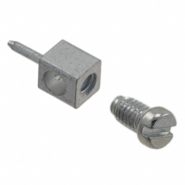

Mount both on the board, and use a jumper on a pin header to switch the connections at one end.
https://www.digikey.com/en/products/detail/assmann-wsw-components/AKSPT/G%20BLACK/1830241
https://www.digikey.com/en/products/detail/adam-tech/PH1-20-UA/9830398

Yes exactly.you mean bend the resistor leads at right angles and put them into the 2 way terminal block?

Excellent. So how would we use these in this setting? (need to make sure here as two way terminal blocks are harder to desolder than single resistor leads!)

Yes, you'd have to make sure the resistor leads fit well. I didn't look at the data sheets.Machine pin headers are restricted to a very narrow range of part lead diameters

Thanks @tonyp063. That's probably the simplest and best solution, can get resistors in and out in a jiffy!
