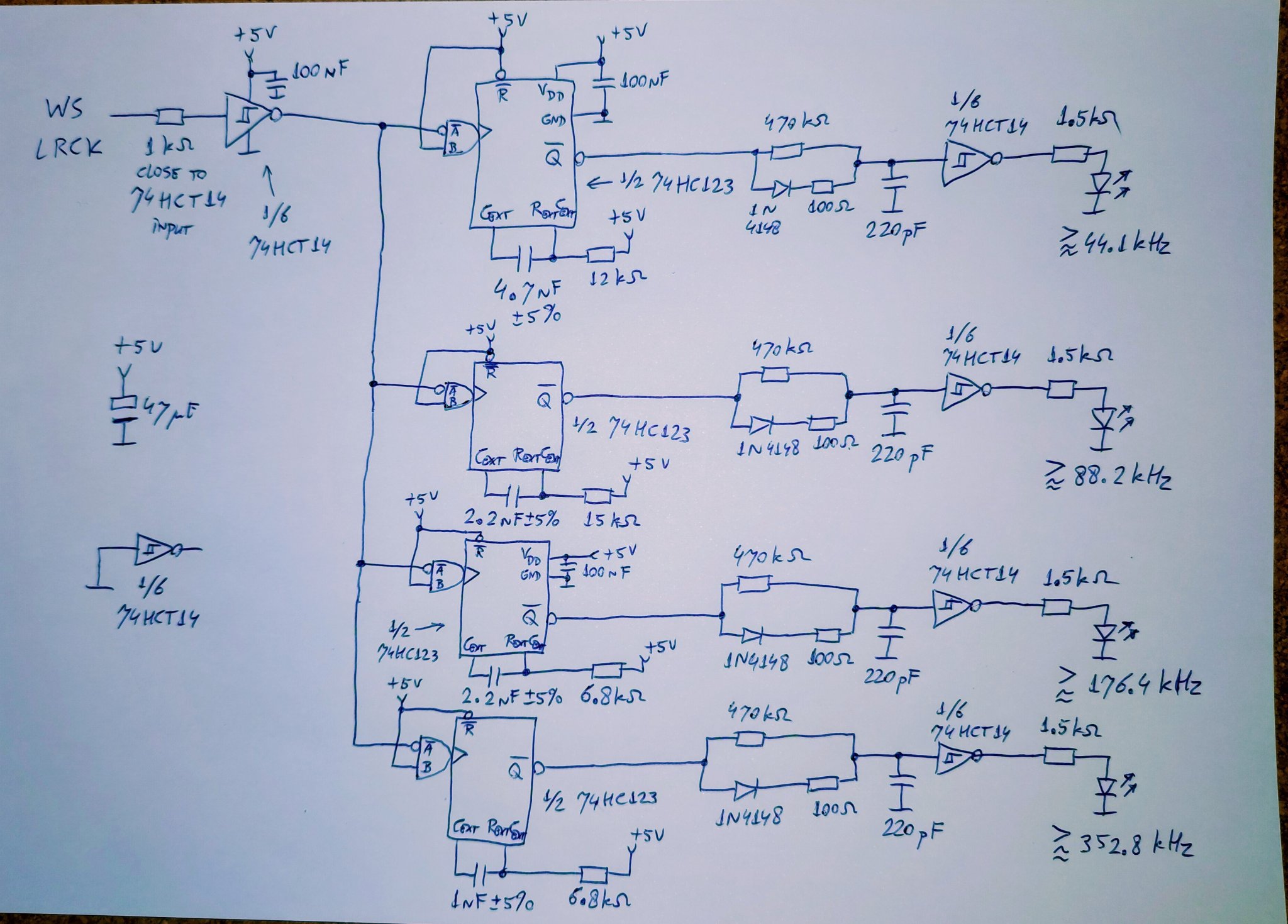

Simple LED display for DAC freq?
This solution do not solve my problem becouse i Need to have fs informations from i2s ( lrck bck data) and not from PIN 1 3 4 5 6 7 becouse i use also a cd transport (that not have those PIN) connected by RJ45 that feed my Dac .
