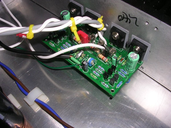

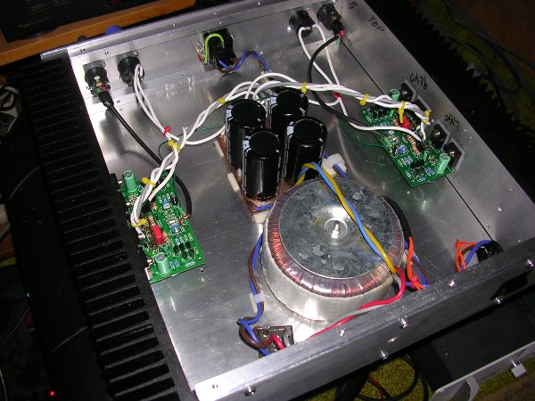

A different angle
I used Conrad heatsinks, 3 mm plate aluminium and 12 mm square rod all tapped and bolted with M4 bolts. The heatsinks are overkill but they make a great chassis.
The intention is to put another channel in there maybe sometime
The rails are right on 50 volts, the supply +-20,000 uf. A Blue LED will of course go on the front ..shortly.
As I was saying to Greg, its bomb proof.
While building the boards I was distracted by the Aust Open Tennis and put all the power fets in the wrong place and baked the 10R bias setup resisters. I fixed that and it still goes! Those IRF Power fets are incredibly tough.

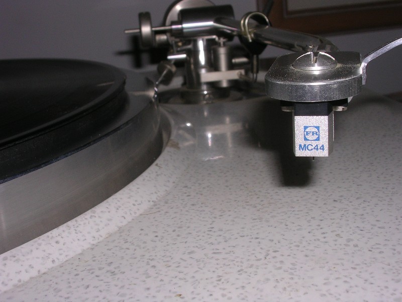

Time to raise the Bar to run the Turn Table.
If time permits I will post some more auditions during the week.
