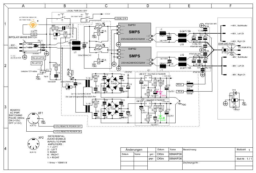

Re: SKA, Greg Balls "wonder box" 300D / SMPS
stoeffle said:
Hi, all together.
To make things short: it must be understood that the most annoying noise current path is not the one of differential mode ripple across the output terminals. Nope! It is the common mode noise riding both terminals in parallel, against chassis ground. This floods your neatly designed equipment and drives you nuts. There is a simple cure: Once you insert a balanced choke in your output LC-filter, together with a pi-filter for that hoppy triangular switching ripple, this former "impossible" noise vanishes. My DC supply has a high frequency noise of <0.5mVpp and a residual 100Hz hum of < 50 mVpp under full load (6.7 ADC).
stoeffle.++++
Hi Stoeffle,
WRT CM noise, I am assuming you are referring to SMPS OP and not
mains IP noise.
Where does the SMPS ref to chassis/mains gnd or is the OP
floating?
At hwat frequency are they run at?
Cheers
Terry
Re: Re: SKA, Greg Balls "wonder box" 300D / SMPS
mfc said:
Does this noise originate in the power supply, externally, or
both?
Hi mfc,
noise on power rails has several sources/origins:
1. external ones, coming from the AC power network have a wide variety of forms:
1.1 broadband noise, usually at a low power level, reaching up to several MHz;
1.2 50/60Hz multiples (typical "comb structure") generated by phase control devices (dimmers, etc);
1.3 commutation noise from series operated universal motors (AC/DC type in vacuum cleaners, hand drills and alike);
1.4 switching noise from light switches and alike, capable of providing very high dV/dt values (may blow your tweeters easily);
2. internal noise from the power supply itself,
2.1 be it from a bridge rectifier conducting only for a fraction of the cycle and thus generating abusive current spikes. The transition from conduction to cut-off is usually compleneted by a damped oscillation, capable of generating EMI spectra way up 60..70MHz. (add some 1nF foil caps i // with the diodes, to kill this oscillation)
Then,
2.2 having a SMPS we get its own noise contribution, of course. But, as the modern SMPS rather do their swiching at high frequencies (mine works at fixed 100kHz), this part can be filtered out quite easily.
So, in a nutshell you have to protect your circuit against EMI threats from outside as well as your own, home made one.
Using a proper dimensioned EMI filter at the firewall of your equipment is good practice and highly reccomendable, as you protect yourself against external intrusion and, at the same time, reduce your EMI contribution into the power line network.
Filtering the SMPS output leaves a neat, clean and regulated DC power source. 😀
One thing to remember is that the usual home AC power line wiring is a quite high lossy one, regarding high frequency responses. Large switching amplitudes are reduced quite well after some metres of cabling. Nevertheless, a VDR surge limiter is helpful to supress kV spikes which may easily destroy sensitive electronics.
I hope you got my idea...
so long,
stoeffle.++++
Terry Demol said:
Hi Stoeffle,
mains IP noise.
floating?
Cheers
Terry
Hi Terry Demol,
in fact, we have both! Due to induction effects alog the long power lines, some of the DM noise, converts to CM noise. This is the reason for the balanced current toroidal inductors in those ready available mains filters.
The CM component of the SMPS is a quite large one which, if not dealt with properly at the root, may cause severe headache(s).
The chassis of the SMPS case is at PE potential. The case is used as a heatsink for the internal switching devices and diodes, thus by capacitive coupling, induce a CM component at the "floating" output terminals. "Floating" is at DC, but at AC there is a measurable link of several nF to chassis ground! And this loop has to be closed at the shortest distance aoutside!
Another point to keep in mind is to use twisted pair wiring, wherever possible. This reduces stray inductive EMI fields to a minimum. Keep in mind that the current flowing out of the source has to return to it and opposing magnetic fields cancel themselves to the gratest extent, keeping the stray fields only at very close range of the twisted pair.
The MeanWell SMPS I used, is a 100kHz switcher, a 320-48 unit in a case 321W, with built-in PF correction, a thing a toroidal/rectifier/capacitor power supply never will be able to supply. Huge current spikes at the apex of the sinusoidal AC mains voltage are the result, generating vast amounts of 100/120Hz and multiples, harmonics.
so long...
stoeffle.++++
Re: smps
japjag said:
hi stoeffle, what meanwell smps model no. did you use? looking forward to the tweaks you mentioned in the constructor's thread..thanks!
it is the MeanWell SP 320-48, case 321W, capable of supplying nominal 48VDC @ 6.7A. Output voltage is adjustable from 41 to 56VDC. Switching freq is fixed @ 100kHz, stated ripple is 240mVpp, which is a value I could verify. Further details on the schematic attached.
so long...
stoeffle.++++

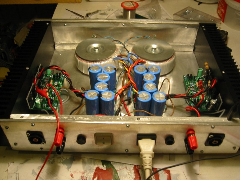

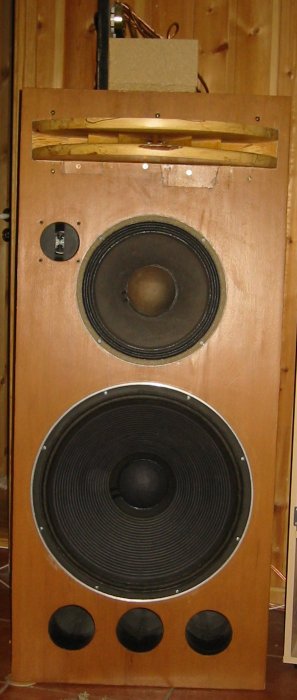

I finished my GB150D yesterday. This is my first DIY electronics project, so naturally I have some problems.
Here are my listening impressions: Very impressing. Very dynamic. It has the same dynamics all the way down. From 1K and up it is different from my old amp which is a little tube-like. I won't say anything about preference there yet, but from 1K and down it is incredibly much better. Same level of details, same dynamics and steel control. E.g. the cello made my couch vibrate significantly more than with my old amp. My chest too. The amp seems equally powerful and dynamic throughout the whole spectrum. Plays really effortless. I'm eager to play more in the days to come...
Music played on a Pioneer PD-S06, passive pre-amp and on DIY 4-way JBL monitors.
This is an amp I can recommend.
