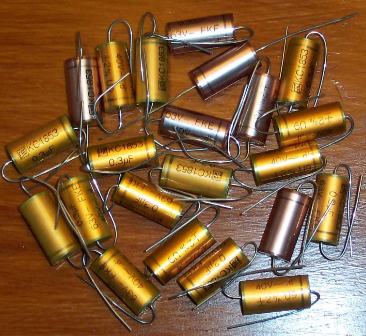

mastertech said:
film caps
Mastertech😎
Yes, if caps can't be avoided in a practical way (like on the output of a single voltage delta-sigma dac), styroflex caps are the best (IMO and IME) that can be used on the signal path.
Just today in the morning I went to order some PCBs on one of the local parts stores around here.
This store is old, and sometimes I find amazing things there, talking with the guy.
Just bought today these 0,3uF/63V (+/-2%) styroflex caps.
Oh glory, oh joy... 0.4 € each. 😎
PauSim said:
Nice caps, Carlos. What´s the name of that old store? Is it Minitron or Radiolux?
Thanks.
Total, near Areeiro in Lisbon.
Hey Paulo, you are not going there and buy the full stock, are you? 😀
They had 0.36uF, but only 6 caps... the man told me he used to have these ones on values up to 1.2uF. 😱
When I need small values, in the pF range, I go to this store, they always have styroflex caps (the transparent ones), while on other places they only have ceramics. :dead:
Today I asked what was the highest values he had for styroflexes, and he showed me these 0.3uF and 0.36uF (which he only had a few).
Jacco, these must be old stock, as he told me that this 40 cent price is while he has them, because (his words) "these caps must cost much more these days"...
Oh, I know that store for some time. I´ve bought a few things there. Friendly people (and patient) 🙂 .
Well, thanks anyway.
Edit: Don´t worry, I won´t buy the caps full stock 😀
BTW, when you´re looking for custom inductors and transformers for a very low price go to Retralinhas. The old man also rewires loudspeaker drivers (just remember him to wire both drivers in phase and to not use any varnish).
Cheers
Apologies for hijacking this thread.
