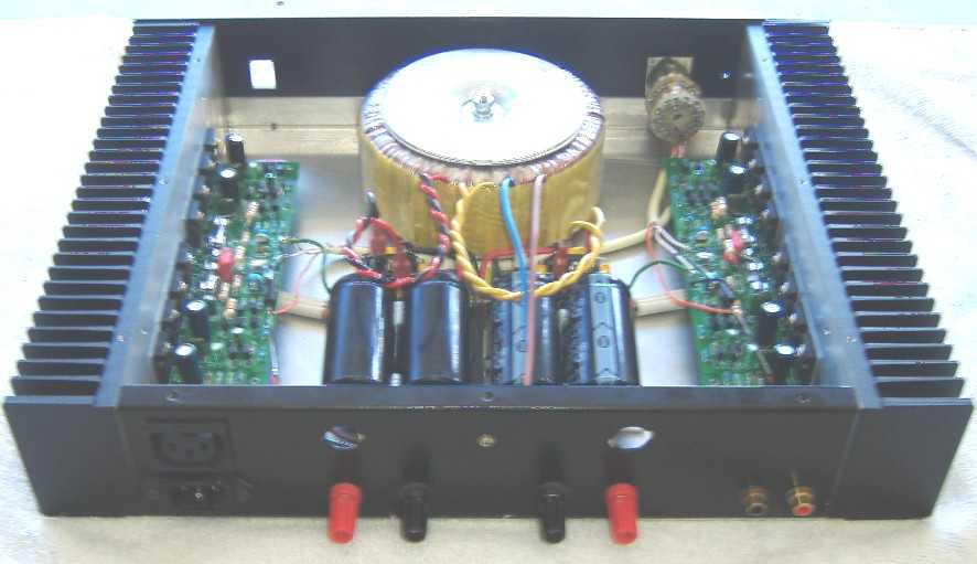

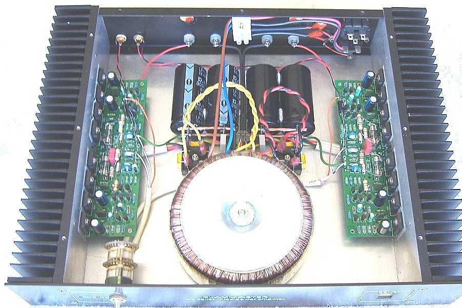

japjag said:wow, how does the gb300d sound in your system?
Hi japjag
Still running the modules in, but, I will post my listening experience once they are run-in 😎 good sofar 🙂
rgds
Those modules look enormous compared to the GB150's
Nice work KLe. I've ordered a pair from Greg but it looks like another couple of weeks before I'll have them since he ran out of PCB's.
Will be interested in your thoughts. You have the GB150's also don't you?
ShinOBIWAN said:Those modules look enormous compared to the GB150's
Hi ShinOBIWAN
Thankyou and no, I only have the GB300D's. As they keep running in, they sound better and better, but, I will report once they are more run in. 🙂
Did you notice a run in period for the GB150D's
