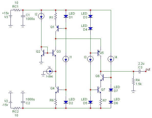

Folding cascode I/V for TDA1541A: component values
rbroer said:
After all suggestions I've come up with a version I'll try next (still enjoying the 1st version though);
I added a PNP cascode on the current conveyor to keep it's Vce pretty constant and as a bonus it creates more Vce voltage headroom on Q5 since it's referenced to negative rail.
I have cascoded current sink Q7 with Q6 since this one will be "seeing" the output voltage swing.
I1 ~ I4 are constant current sources made of jfets with resistor.
I'll be using 2SA970´s & 2SC2240´s
bias Q3, Q5 = 15mA
Vce(Q5) = 19V,
Ve(Q5) = 11V,
Vc(Q5) = -8V (+/-3V signal swing)
Any suggestions for a "bigger" Q5 ?
Questions about the folding-cascode "upgrade" to rbrorer's I/V -- and specifically with respect to its use with TDA1541A:
Are all Q's now 2SA970's & 2SC2240's?
What are the values for R1, R6 and R7 (are these best off as pots)?
Are the LED colors still green ... or will red work better ... or does it really matter?
For anyone who built the orignal and the folding-cascode "upgrade" ... how big of a sonic difference is there between the two?
Thx for any info you can provide.
rbroer said:
Built this the last week; it's a variation of Jocko's simple I/V, using all generic unmatched parts, larger bias currents, and the R4 upstream of C3.
This is used in a non-oversampling cd player with Kwak-Clock version 3 and TDA1541A-S1.
I have adjusted Vc(Q3) with pot R6 to 10.0 Vdc
Ve(Q3) is adjusted with pot R3 to 0 Vdc, and readjusted after a few hours. It doesn't change much over time, within +/-1.0mV.
Current source Q1 is about 23mA, of which 6mA flows into R4, 17mA through Q3 and 15mA through current sink Q4.
All bjt's have hfe of ca. 300-400 measured with multimeter.
Since I didn't measure Vbe on Q3 and Q2 I ended up with different R3 values; ca. 5.6k and 22k.
I suppose one could select to get the lowest R3 value, that is, have some moderate current flowing into Q2.
Have fun,
Hello
Did you sim or measure how much distortion this first version of your circuit do have ?
Thank you

Hi Rudolf,
Can i substitute 2n3904/6 for the 547/57? Their specs are very similar...
Thanks!
i've built the circuit, and when the volume on the cd is low, it sounds fine. but as soon as samples come above a certain level, they transform to a harsh 'click' or 'pop'. all initial adjustments have been done, but even when seriously offset (try and error-method), the behaviour doesn't change. both channels have the same problem
is hfe very important?

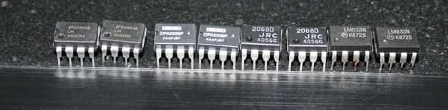

You need DUAL OpAmps to replace those - 2xOPA627 need to be mounted on a brown-dog adaptor.
Personally I didn't want to complicate thinks. I liked the best the sound of LM4562.

fyi, we were just discussing this DAC's opamps a few topics up on the forum:
New Small DIY Gigawork Dac? - diyAudio
I'm burning-in a Burson module in the output now, the other guy recommends LM4562's in the I/V. Those OPA Sun, Moon and Earth modules pique my interest as well...:scratch:
how to increase the output level
Hi powerflux, and anyone who can help
I built the original circuit from rbroer too, but I didn't encounter the problem of click and pop, but I did find out that the output level is low., only 1.1V or so.
Does any one can help me to increase the output level to 2.5~ 3 V??
Any resistors or setup to increase the gain??
I know this is an old thread but since I built so I would like to know how to do further, hope someone can help!!
THX
Hi Tubee,
I've built a couple of these recently, and I get the same low output.
As a stopgap, I'm using a simple opamp circuit afterwards, with a gain of about 10.
Seems to bring it up to a more usable level (not that I'm actually measuring anything).
Unless I'm doing anything wrong (I'm using rbroer's first Jocko's IV stage, but doubled the output resistance), I shall begin on a discrete gain stage and buffer.
Phil
