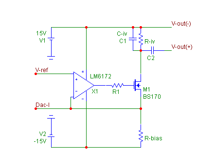

Hi Elso,
I had been using opamps for I/V like most others, and much preferred the LM6172 as least evil above others like OPA2604, AD811, LM6181, AD797, OPA627, AD828, AD826, AD825, etc. etc.
About 1.5 years ago I made a real big step forwards using circuit shown; applied it to TDA1541 and TDA1543 cd players.
Didn't use opamps as I/V anymore since then.
The common base circuit is another step forwards and to quote Droopy "I'm happy".
If the Thorsten proposed circuit SOUNDS better, I'll use it, it is minimalistic enough for my DIY activities.
So, if anybody could send me a few OPA660's, I'll try it, compare it to my current common base circuit and post the results.
In the mean time, I started this thread to let other DIY know they can get good sound from a very simple discrete circuit, using generic parts and sounding so much better than the opamp I/V circuit used in many cd players and dacs.
As always, I'll try to pick up as much hints and suggestions as possibe, to complete my quest to audio nirvana...

Re: IV-Converter
Kuei Yang Wang, is your schematic a <B><I>working</B></I> circuit?
If Burr Brown writes accurate application notes - yes. You can simply check their app note for the common base circuit, it's pretty much electronics 101.
As said, I would not use this type of circuit myself for any number of reasons, however if anyone wants a zero feedback, fully complementary I/V converter using the OPA660 is the best bet, plus you get your own buffer on chip too, so it is a single chip soplution for a feedback free I/V conversion.
Yet I too have not much against feedback,if applied apropriatly and in apropriate circuits, again, it is not WHAT you do that matters, it is HOW you do that matters.
Sayonara
