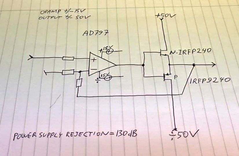

This is a known technique used in instrumentation.
There are two tricks involved:
- The supply is bootstrapped by the output (which is current-buffered by the transistors in this case)
- Positive Feedback is then used to then bring the input voltage at the opamp in non-inverting config back to the allowed input range as this range now rides on top of the output.
The drawbacks are:
- If the source gets disconnected or gets high impedance (even when only in specific frequency ranges), the positive feedback dominates and the output runs into the rails or oscillates. That's why a good fast buffer is required.
- The noise gain the opamp actually is seeing now is higher which gives a noise and distortion penalty (that might be tolerable in a power amp).
- and for this amp specifically: the bootstrap stops working with high levels at low frequencies or DC, again perhaps tolerable here.

Thanks for the detailed explanation.
I agree with everything you write.
<- The noise gain the opamp actually is seeing now is higher ..>
----But since I use a super good audio opamp, the result is still very good, and it sounds good. THD + N = 0.006%.
<the bootstrap stops working with high levels at low frequencies or DC>
----Since I use large capacitors at 1000uF, this works to well below 20 Hz. AD797 tolerates this.

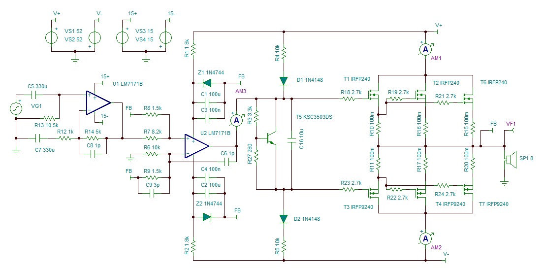

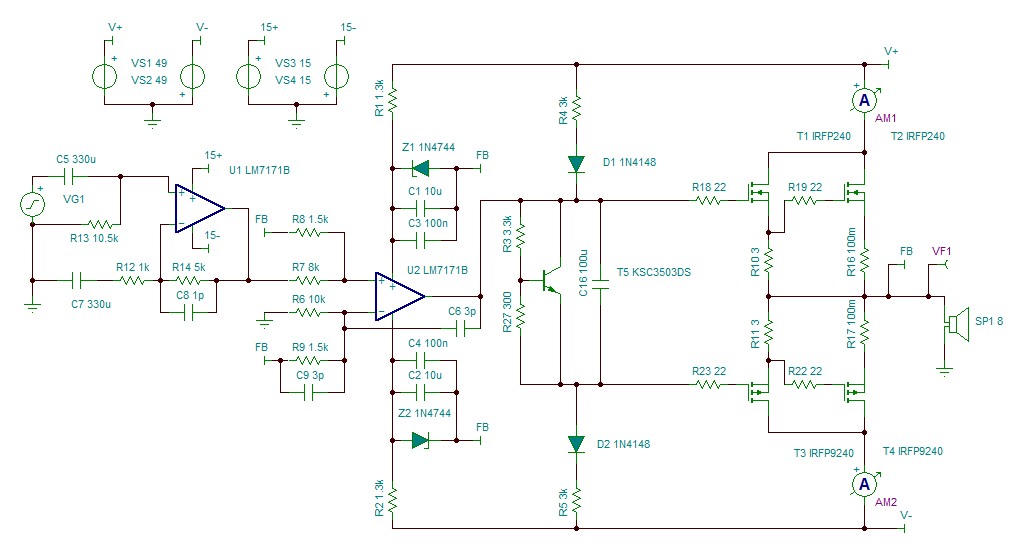

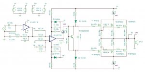

Interesting amplifier, I could not resist to at least model the circuit.
I like the way everything is mounted to the heatsink in the video.
Having used a different opamp. I had to make a few slight changes to correct DC offset.
Added a method of thermal tracking, and lowered the gate resistors
since this caused a lot of distortion at high frequency. Being unstable at clipping I added C6, C9 which makes the amp stable.
Very fun circuit to play with.
I used The IRFP240/ 9240 as the driver Fets
And 3 ohm Source resistors as shown in the schematic from the video.
I found it odd but slightly genius as well.
THD in simulation was very average though only .03 % @ 1 kHz
I used BJT transistors as drivers.
And Distortion was spot on as measured .006 % @ 1 kHz
Going back to the Fets for Fun
I lowered the source resistors to 100m or .1 ohms instead
of 3 ohms
and THD was then more what I expected from a Fet
.001 % @ 1 kHz

...The trick here is that the opamps ground reverence is connected to the amplifier output,....
Chip opamps mostly do not have a ground pin.
He's floating the opamp power supply.
Since the power must float (for anything more than a few dozen volts swing) the chip's PSRR does not matter.
I know I sketched this on the chalkboard in 1980 (I can picture the specific studio we used for one year), not as my original invention but as something which was going around at the time. It has been used in more than one brand of PA amplifier.
Thanks to White Dragon for the drawing.
Can I suggest some small changes?
C1 and C2 should be much larger. They must supply opamp when the voltage is above V +
R18, R19, R22 and R23 should be above 2k2k to prevent oscillation in the mosfet.
R1 and R2 should be much larger. However, they must be able to supply opamp with the correct voltage. R1 and C1 have a time constant that must be well below 10 Hz.
The AD797 should also have a small fedback capacitor and read the data sheet for pin 8.
C16 should be larger.?
What do you think?

Yes agree.
For low frequency performance to 20 Hz
C1, C2 need to be larger. Around 100 to 220 uf for lowest distortion.
Anything larger doesn't seem to improve THD in simulation.
With a bootstrap, there is a phase shift at low frequency
so the capacitor has to be large enough.
I tend to go overkill with zeners. Using a 1N4744 which is a 1 watt
1.6 to 1.8k should be about right for a 49 to 52 volt unregulated power
rail. Using a 1/2 watt or 1/4 watt would yes require a higher value
Resistors.
Far as C16 I actually tend to use 2.2uf to 10uf.
likely not necessary in the circuit.
But in many other amplifiers I have designed with VBE multiplier.
It seemed to add stability to the overall amplifier.
High gate resistors will add stability yes.
But 2.7k seems to add a lot of high frequency distortion.
I raised them as requested. 100 ohm should be good enough.
C9 seemed to improve stability. Maybe it is possible that
would help instead of needing such high gate resistors.
C9, C6 should both be 3p I found for best stability
I dont mean to change the opamp, I just used something similar
for simulation. Since I dont have AD797 spice model. I dont mean for this to be a full schematic.
it is just a screenshot from the pspice/tina ti simulator
