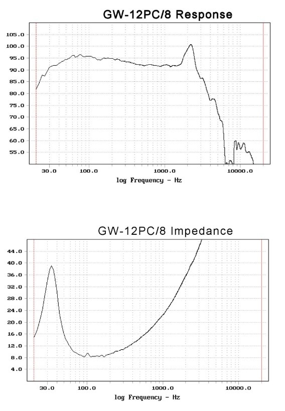

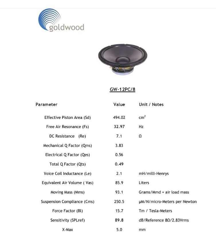

How to make a very simple great sounding cheap loudspeaker with only a cabinet, drivers and a capacitor:

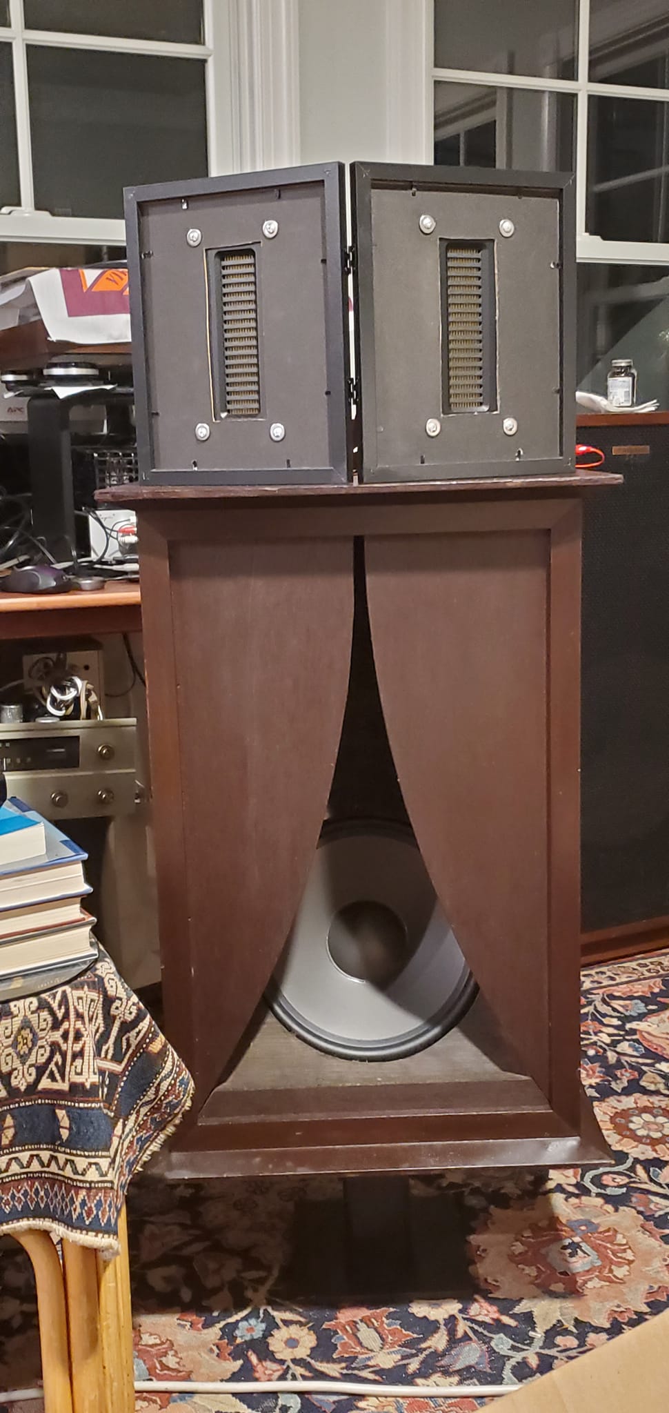

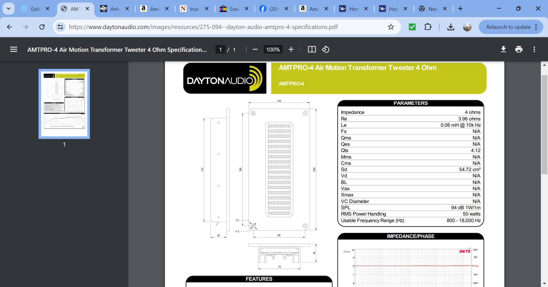

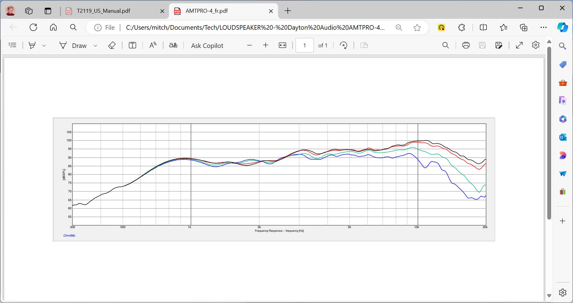

Put 12" Goldwood 12PC8 woofers (about $75 each) in two Karson cabinets. Place a folding picture frame on top of each Karlson with two Dayton AMTPOR4 tweeters (about $100 to $200 each) in each frame. See pix. Place the two 4 Ohm AMTs in series with eachother and a 22uF 5% 250AC 400DC capacitor. Don't go cheap on this or user lower values! Don't put a coil on the woofer! Hook everything up in phase; do not reverse the AMTs.
Suitable frames and capacitors may add $25 to $50 more. Complete total for loudspeakers for me was about $300 each or $600 all said since I got the plywood for the Karlsons free at a construction site. If you are not handy, building the Karlsons may freak you out completely. But each one gets easier! For me, it was a snap. I was given a pair and then just made a pattern and was off to the races.
Step back about 10 feet with the two Karlsons at least 3 feet from the side walls and 3 feet from the back wall and your chair 4 feet from every wall. Do your best! If the room is too small, then the sound will be, too. Also, remember the old eqilateral triangle.
Hook the speakers to any amp from a class A single ended 9 watt to a class D 600 watt. Put on a direct-to-disk LP from a good system or a hidef stream or any good signal. Enjoy!
As you listen the first time, position the tweeters in the folding picture fames to sound best, fold more open or clodsed, tilt this way or that, bring foreward or back, try to maximize the sweet-spot and so on . . . See pix.
What this system will lack in untra-sonics, or midrange measured clarity, it will more than make up for by the fast, articulate, in phase, music. The tweeter will mask any upper mess from the woofer. Properly positioned with the ANTs in open baffle mode, you will get OK stage imaging and fantastic ambiance. Since most recordings have nasty stereo effects anyway, a little smearing off the back wall can only help.
