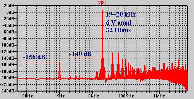

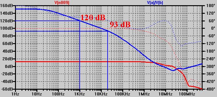

4. At the same time the amplifier has high parameters. The depth of the NFB for different variants of the amplifier changes from 150...120 dB to 1 kHz, and to 93 dB for 20 kHz, Fig. 1. This is enough to get ultra-high linearity, Fig. 2. Such linearity is not available for many of the other amps built by other circuitry. With this amplifier can compete on quality only "composite" Opamp + Opamp.
You can verify this yourself on the model.

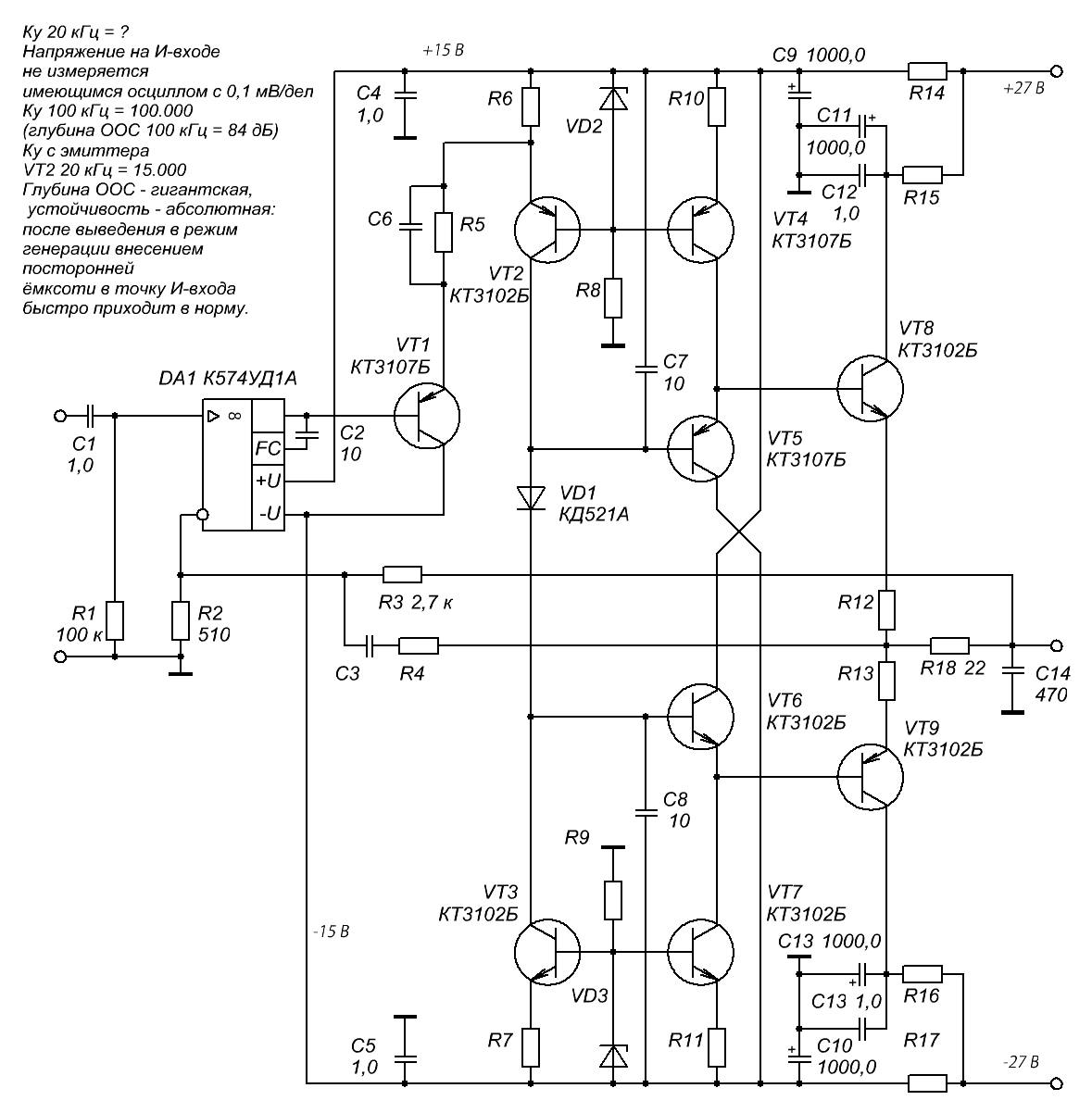

Yes, I designed these amps. For example, a simple amplifier is a simplified version of this powerful amplifier, whose scheme laid out in this thread.
The first version of this amplifier was so done, see diagram at the bottom of the post. We see, that if we exclude from the scheme VT2, which is not needed when the power supply 2x15 V, and to reverse the polarity of VT1 on NPN, that the signal received at the emitter VT5, it turns out the scheme is simple headphone amplifier. UNICUM - this is a step on the way to the amp CRAFTSMAN. I promised to create a topic about a new amplifier: this new amplifier circuit design is very similar to CRAFTSMAN, but easier. It has no overcurrent protection (VT12,VT14,VT15,VT25), unit resistance compensation cable (DA2), simpler output stage.

I would change the schematic in the first post as your schematic as it has nothing in common with the one Alexandr provides with boards other than capacitor and resistor values being the same. It is misleading and confusing if someone tries to go by it when assembling the boards.
All of the transistors are different except the 2SK170 & BF245C JFETs.
I wasted quite a bit of money on 2SA1175/C2785 transistors when the boards are designed for BC547/557.
Also, the board is laid out for 3.5mm LS for the 1,000uF capacitors. Good luck trying to find 1KuF caps with only 3.5mm LS! Almost all good caps I found that size are 5mm LS.
When I asked Alexandr why he used 3.5mm LS on the boards, he replied that you originally had only 47uF caps in those locations.
One thing I can say with certainty...Alexandr has been very helpful and prompt in answering all my questions as well as selling me matched input transistors for a reasonable price.🙂
You could specify a sequence number for these parts? Elements R5 and C4 connected in series, so they can be rearranged, swapping, and it does not lead to critical errors. The amplifier is working, its parameters will remain the same.

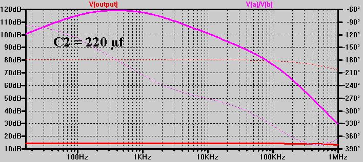

This capacitor C2 happened interesting story. Based on the circuitry of this amplifier I decided to create a Phono preamp. Capacity depth 47.0 µf NFB is more than enough to get high parameters for head amplifier with its amplification 2 times. Phono preamp needs to develop at low frequencies a much greater gain, and capacitor 47.0 µf was not enough to obtain the desired depth of NFB.
You can assemble this head-amp with C2 47.0 µf , 100.0 UF, 220.0 µf or 470.0 µf, and it will not be wrong, will not lead to the loss of sound quality - as you can see in the image frequency response, the depth of the NFB still remain 88 dB at 16 Hz, at 47.0 µf, 100 dB at C2 220.0 µf, and 107 dB at 470/0 µf.
For Phono preamp required C2 1000,0 uf and more.

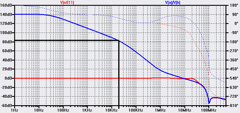

I can't boast of anything. Two gain stages give the NFB a depth of 80...95 dB at 20 kHz to 120...140 dB in the lower frequencies. 🙂 That's all. 🙂
