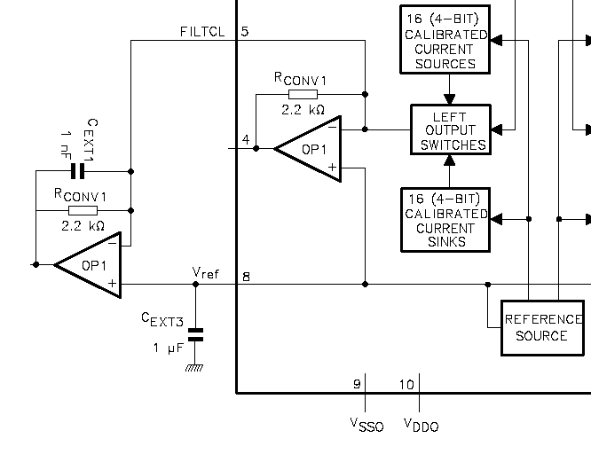

Simple, good quality DAC
TDA1549 internal opamp bypassed:
just to make it more clear

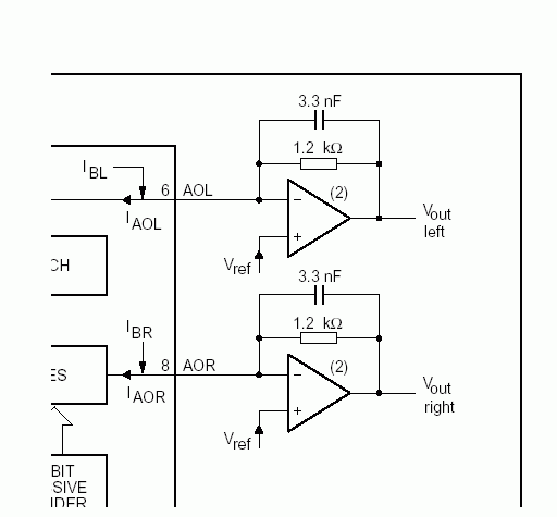

Hi Miguel, I connected the opamp just as in the datasheet of the TDA1543. The optional resistor at Vref is 3k3. For a start you can use the resistors as in the datasheet. The DC-blocking cap is after the opamp!.😎
Here is what I used. After the output cap I think I can connect any opamp there, like the opa549 from the gainclone that works well. So the opa134 should not give problems. I tried to use the Vref of the dac in the + pin but had no changes. time to think a bit more...

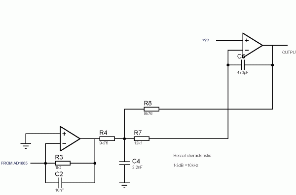

Iv
Miguel,
This is what I use now:
R3= 3k65
C2= 3n3
???= GND
C4= 2n2 (barely readable)
Non-inverting input of the first opamp NOT connected to ground but to Vref of TDA1543.
I think you want to many things at once. First have IV-converter, one pole of low-pass filter possible, then have optional additional filtering. Currently first opamp= OPA604. This might change to AD8610. (with +/-12V supplies)
No, not forgotten. I am still confused that you throw such a big portion (>50% ) of the spectrum away. I wouldn't recommend this to others whatever explanation there is.

Analog Low-Pass Filter
If cd has to be played this way I will buy a turntable again ( or go back to OS )...
The filter and discussion I referred to was here:
http://www.diyaudio.com/forums/showthread.php?postid=142846#post142846
Looking at the frequency transfer of an audio system in from a musical cq. harmonic perspective: the top 10KHz to 20KHz is just the top octave from about 10 usefull octaves, so only 10% and probbably the least important 10%. Besides there is still usefull transfer at 20Khz through a 10KHz first order filter so the effect subjectively might not be so bad as the numbers suggest.
Thijs
PS. miguel2, don't use ground as the non-inverting input for your I/V stage, use the ref pin of the TDA1543

Low-Pass Filter
Hi Jean-Paul,
Agter a night sleep I decided to come back on the subject.
First your verdict was upgraded from telephone sound to LP-sound. That's quite a improvement and if the sound is as the LP I have reached my goal and I am quite happy.
May I ask you what crossoverpoint (-3dB) filterorder, and filtertype (Bessel, Butterworth, Chebysheff, etc. ) you suggest?. With FilterPro it is quite easy to calculate the values and modify the circuit.
I had the opportunity to compare my DAC with the most expensive JK-Acoustics DAC in 't Harde.
http://www.jkacoustics.nl/DACReference.htm
Johan Ketelaar was quite perplexed that I had such a good sound from a homebrew affair. Last Friday I had on audition in my home a Arcam FMJ CD33 and a Marantz SA-17S1. The Arcam was beter on CD's than the Marantz:att'n: The Arcam is Euro 2000, the Marantz Euro 2500.
My DAC had more bass but less highs than the Arcam. The Marantz had a anomaly in the bass, just did not have it under control. I decided not to buy either of them, as I preferred the sound of my own DAC/Philips CD-650. To my ears it sounds more musical more like the real thing. A week ago I attended harpsichord and clavichord concerts here in town. I don't hear the exaggerated highs at the live concert I hear from upsamplers and Hifi-ish sets. Also the volume is not that high as most Hifienthusiasts like to play, in fact volume is quite low. I concur with Kuei. Y.W. that it is all a matter of taste but I like to gauge my ears every now and then, before I loose track on the real sound.
I concur with you if you devide 20 K by two you get 10k or 50% of the audioband. I prefer to use a logaritmic scale and then 10k-20k is a very small portion of the spectrum. The filtering I use is choosen after extensive listening tests.😎 As Thijs points out 10k-20k is only 10% of the usable octaves...

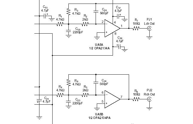

just a thought on non-os filtering...
I've been looking at a non-os DAC for a while now. Looking around on the net has shown:
- There must be something special about non-os given the DIY interest and the great reviews.
- >10K measurements for a non-os DAC are poor, although it does not seem to affect the sound from what people are reporting.
- The out of audio band artifacts are high and difficult to filter given the 44.1Khz sampling frequency.
- Common concensus seems to be that for os solutions its the digital filter that affects the sound quality.
What about applying a simple sample rate doubler that ups the effective sample rate to 88.2Khz and use an analog filter? The analog filter will be much easier to implement a cut off above 20Khz if the sampling rate is doubled.
Either a chip with 2x upsampling (althugh no longer a non-os solution!!) or a simple DSP to modify the i2s bitstream would work?? I'm sure someone with more experience than me has thought of this, but I'm thinking that this approach might be a good compromise to the problems outlined with non-os.
Feedback?
Re: just a thought on non-os filtering...
Feedback?
Hi Deandob,
I have thought about the upsampler approach but gave up when I realised the upsamplers like CS8420 and AD1890 - 1893 have a digital filter "on board".
