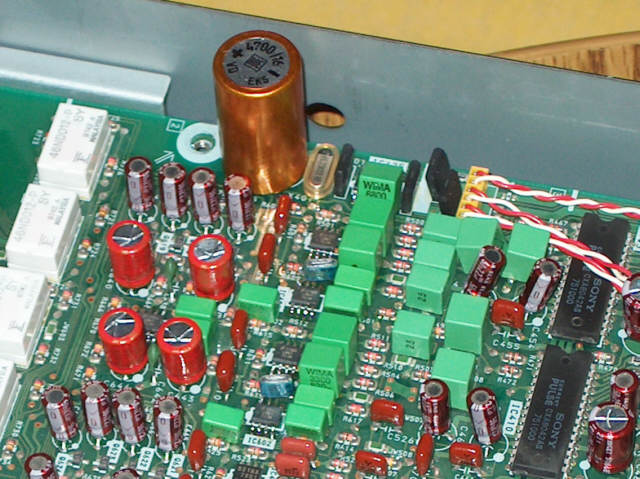

Another idea is to buy a used DAC and simply improve some parts.
I have a Sony SDP90 and for~100Euro (as you are from europe)
you can get one. Change some parts (20Euro) and you have a
digital preamp that plays in upper leagues.
I think this is easy for beginners as me and you.
