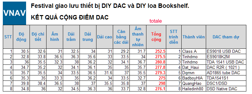

I don't understand what you mean by it sounds bad, it has higher performance than the AK4137 and coupled with DSC modules the sound is pleasant compared to a normal DAC.
In a contest organized by the forum Vnav this was the winner.

It sounded *very* jittery compared to other devices, even with an external reference clock as suggested by CT in their app note. AK4137 sounded much better for DSD and for PCM upsampling. SRC4392 sounded better for PCM upsampling (it can't do DSD conversion). DSD256 from HQ Player also sounded better. Overall, CT7302 was by far the worst sounding. This was evaluated by a panel of listeners, one at a time, alone (so no influencing each other), using AK4499 eval board along with Pass Labs HPA-1 and Audeze LCD-X headphones.
Also, CT7302 appears to be a 'system on a chip' design. It uses a separate 11MHz crystal to clock itself. An external audio clock can optionally be used as output reference. Sounds maybe like the internal PLL/DPLL/PPLL runs from the 11Mhz crystal and or it is being jittered by noise from the CPU part of chip. Could be other problems though. Its hard to know unless CT wants to reveal more about its design.
