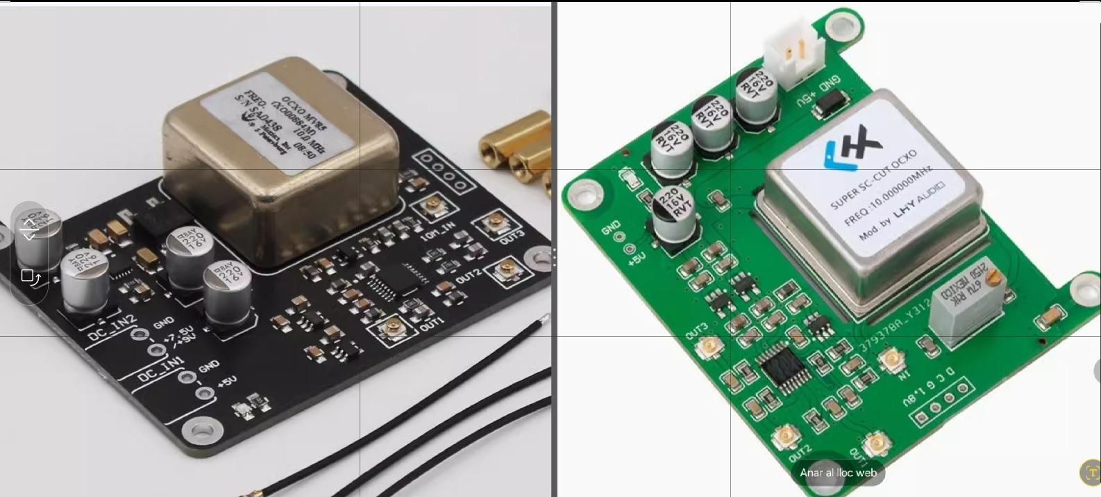

How should look like a reclock after PCM2DSD? My Dac is NoDac ( passive high pass filter).
I have seen some modules fited with a good OSCO clock rated at 10Mhz and two output 25M or 54M

I would just use the same MCK that you use on PCM2DSD and reclock DCLK (possibly also DSDL/DSDR) with a flip-flop (e.g. 74LVC1G79). But as I said reclocking after PCM2DSD is not necessary so you can add it later if needed.

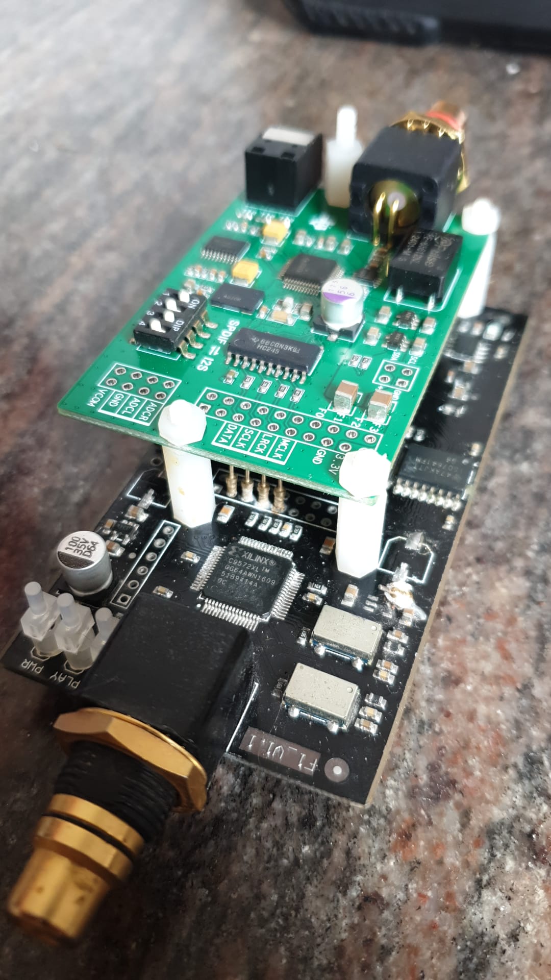

I almost forgot having a Singxer F1 module in the drawer, which includes the two necessary 22/24 clocks, plus the pins and mounting holes compatible with the i2s of the Opt-Toslink receiver. I would like to connect them both together, but I don't know if it will work or if the clocks will be effective that way.
