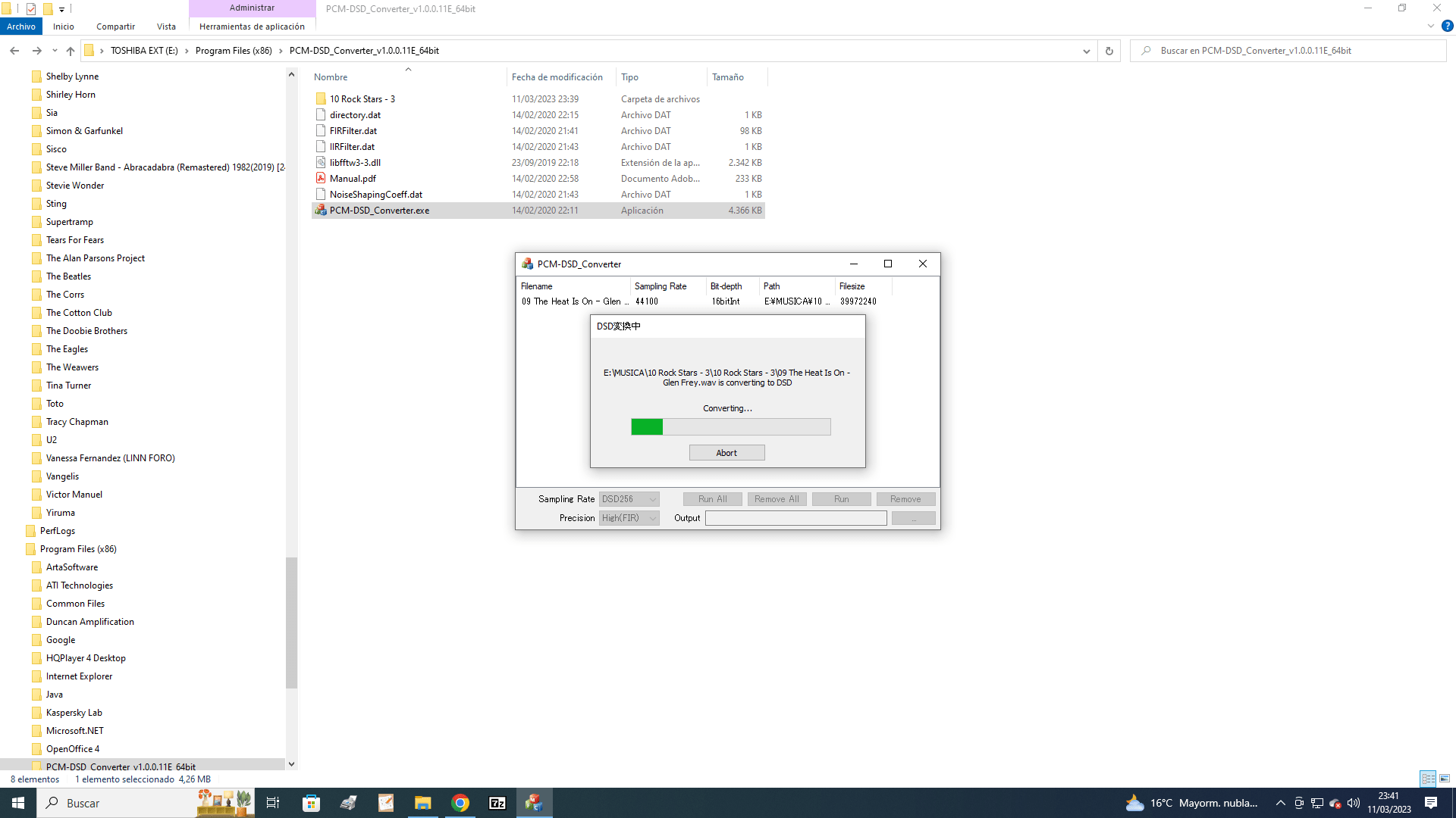

Could be your antivirus is overly sandboxing it. Can you set it as an exempt/trusted app in the antivirus settings?
That may be the problem. Reason for suspecting antivirus is the app got an error message that you posted before before saying it could not write a file and or create a sub-directory. That sounds like a permissions issue. However, Win10 doesn't do that here. One thing we know is different about your computer is your antivirus.
Guess you could try looking in your system logs and or any antivirus logs. Maybe set antivirus logging or messages to verbose, if it has that option.

Unzip into a regular folder. Just run it in the unzipped folder, or make maybe a desktop shortcut to the app in the folder if you want.
