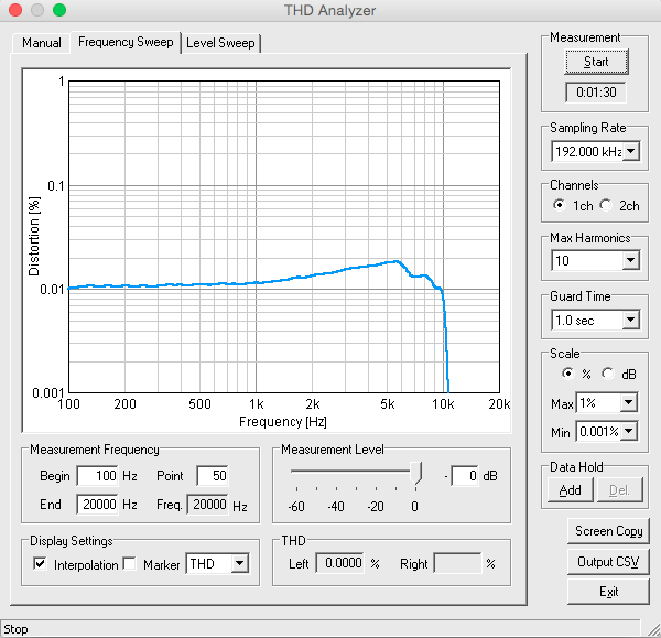

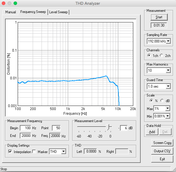

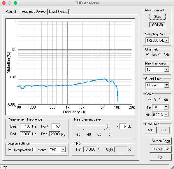

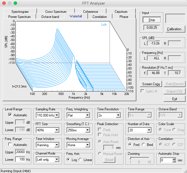

Here are the results. I'll keep it on the bench for a day or so in case any measure request.
The file names describe test.
example: nr2-6db-fft-1M is fft waterfall -6db input with external 1M series on input.
Notes:
R2 optimum value on nr 2 proto is 10k
Semis are random picked, no culling.
THD is a little lower on proto 2.
R4 is/was 100ohm on nr1 and nr2. Schematic shows 470.
Bias is adjusted for best *overall* thd.
3.3k dummy load resistor on output
0 db is 770mv rms sine
No other connections, panel pots on box are for other ckts.

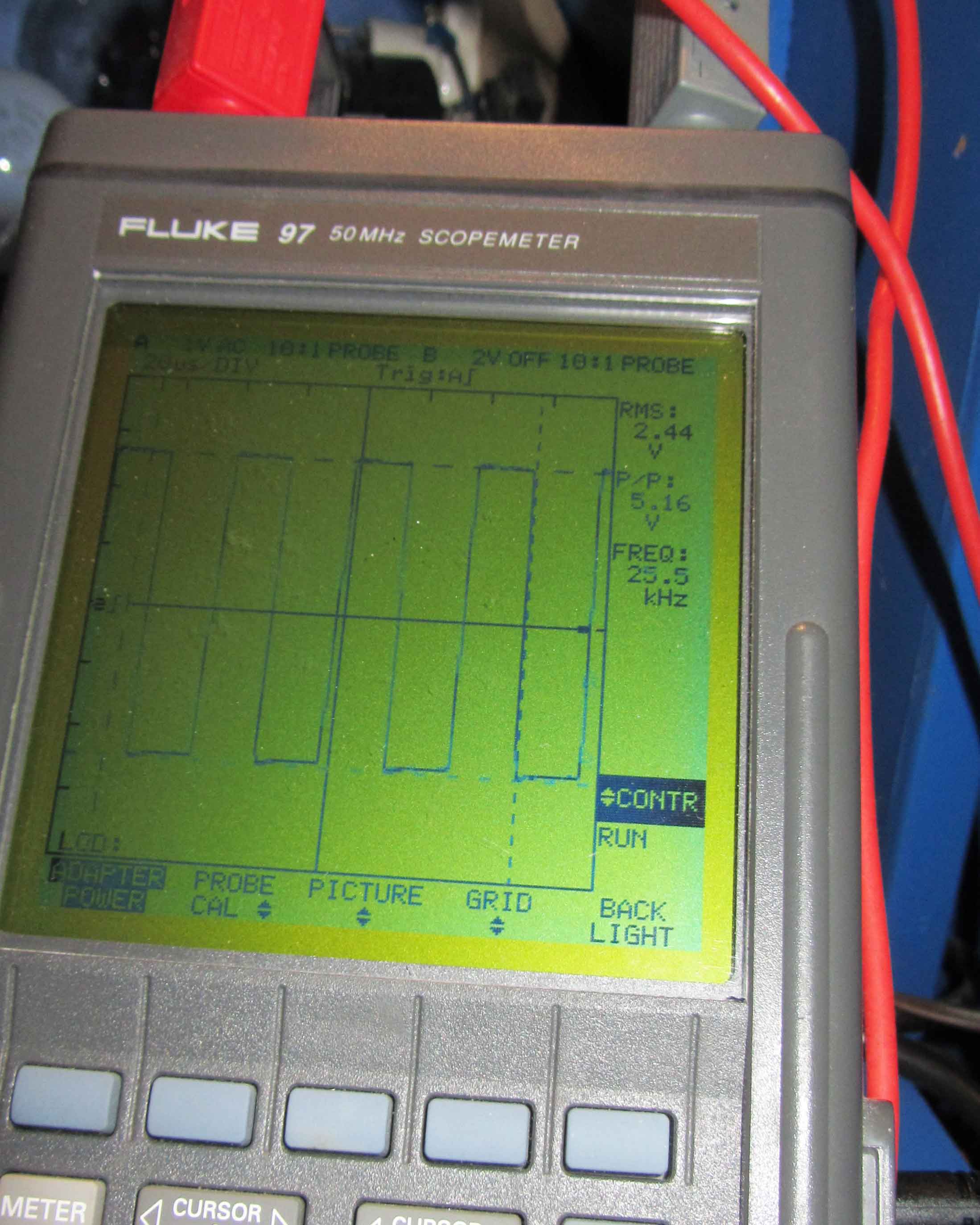

I will upload a pic of 25khz sq wave later today. It looks fine.
Interesting the THD is/appears lower with the 1M. I suspect its because of some input attenuation.
Have to move on now to power section. The pre is released now. In Texas we say cut bait or fish.

Note that either sample rate is not set up correctly (I am guessing the hardware setting cannot be adjusted from within the emulator environment) or measurement bandwidth is restricted to ~20 kHz somewhere.
Very interesting to see a dominant 3rd on a circuit like that... possibly a result of output loading.

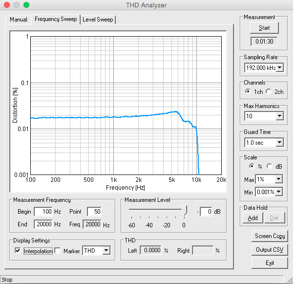

Hi!Here are the results.
Doesn't it bother you a strange move frequency response distortion http://www.diyaudio.com/forums/atta...mple-discrete-sziklai-pre-nr2-0db-thd-1m.png: the rise from 1 kHz to 6 kHz, then the same for all the graphs the shape of the recession? Why suddenly they began to grow from 1 kHz, and why decreased after 6 kHz, if there is no resonant circuits or frequency-dependent circuits for these frequencies?
the harmonic signature can be tweeked with bias setting.
ie dominant 2nd or 3rd or 50-50.
the distortion really is that low, i did a lot of checking.
the first set of data shows response plot.
the peak - drop is only on the sz circuit. a simple fet-classA will present
a plot you are accustomed to.
the steinberg ur22 does roll off around 22-25khz. its not the best but for price/performance is great. i wanted midi din ports.

Hi!
Hi Victor, these are actually THD graphs (not the frequency response), taken on a rather narrow-bandwidth sound-card based analyzer...
Sound cards, the bandwidth which would have been more than 50 kHz, a very small amount. In fact, I never even heard of such. 🙂 Most likely, the bandwidth is limited by the internal filters. But bandwidth 50 kHz is not sufficient to judge the harmonics of the fundamental tone 20 kHz higher than the second (40 kHz). It is better to measure intermodulation distortion in the test 19/20 kHz. The difference frequency of 1 kHz 18-21 kHz see all the cards.
This effect I saw "iron" instruments, such as distortion meter with a bandwidth up to 200 kHz.

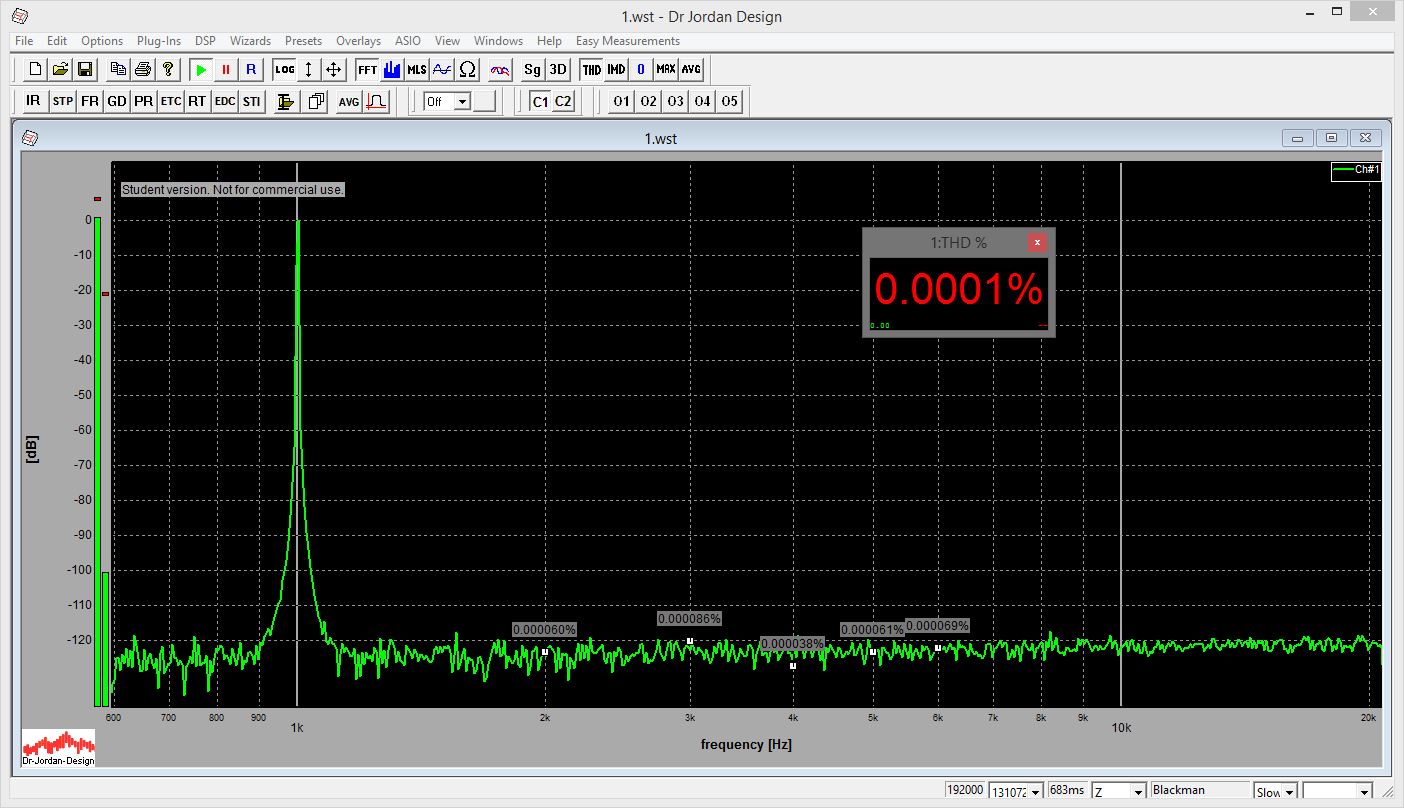

Yes sure, I don't know what exactly jfetter is using, but his graphs are limited at around 10KHz by some reason.

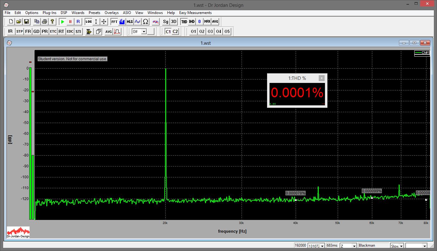

I am using a pro-grade Lynx L22 together with pro-grade German Dr Jordan Design's measurement solution.
100KHz analog bandwidth, 0.0001% external-loop distortion within 20Hz-20KHz bandwidth. High-enough precision instrument. See attached.
The only disadvantage is the price (around $1000 USD new in Moscow) 😉

I like to measure the distortion for a frequency of 20 kHz. Due to the decrease of loop gain where they are much higher, they are more visible, and if there is they are small, especially they are small at other frequencies. About the same we can say about the test 19/20 kHz, we see not only the ultrasonic harmonics, but only those that can hear in the audio range.Yes sure, I don't know what exactly jfetter is using, but his graphs are limited at around 10KHz by some reason.

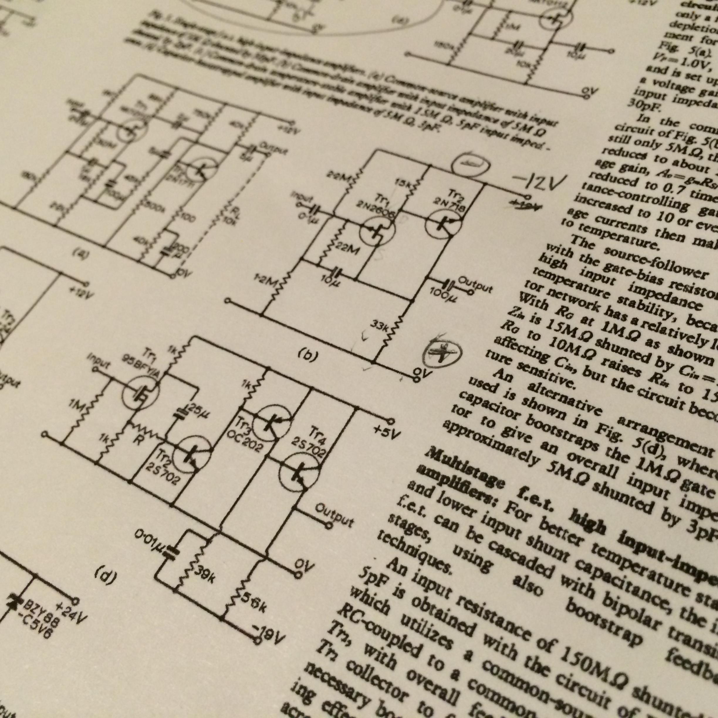

additional notes
while working on power section i found two app notes in the file that influenced this preamp design.
: a single page i printed related to jfet ion impact current. (cant find ref)
basically not a problem on p channel. plus i wanted to use holes not electrons in first stage anyway because this amplifier is part of a physics thesis.
: July 1968 wireless world fig 5b on pg 200. the illustration has ps error but it is root idea.
